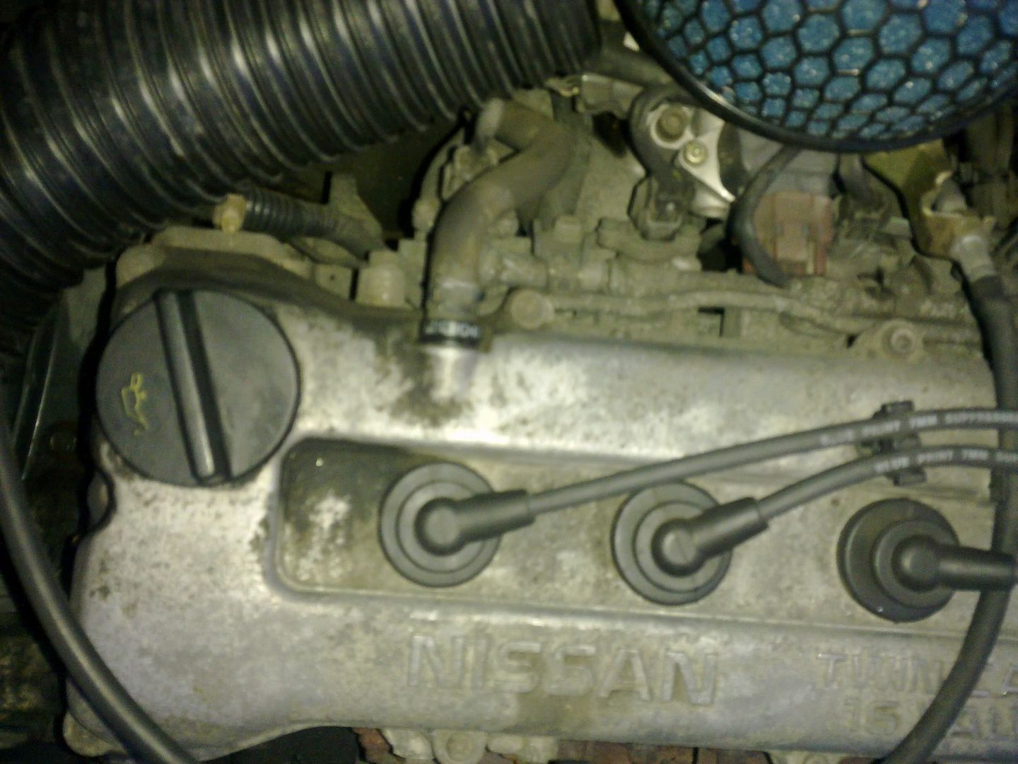

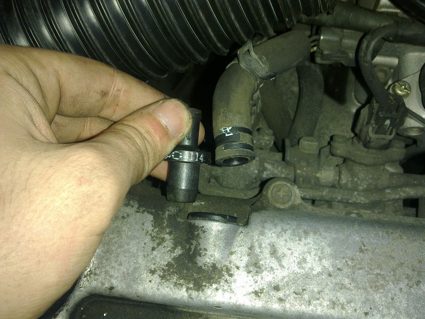

Found it! Had a half day at work and was meddling with the Micra so decided to see if it had one:
From what I can see, they don't get very mucky. I'd say cleaning it would be fine, I tried to blow through it and the valve sealed one way and was fully open the other so I guess that means it's fully functional? Haven't dealt with PCV's much so sadly don't know much about them.
