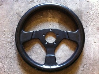

an old Victor steering wheel. not in top condition, but not beat up either. I like it. :)

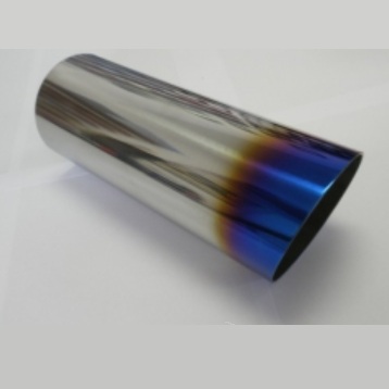

a sports muffler from an old Audi, it's almost the same size as the stock one so there is no problem in fitting it on. I don't like the tailpipe much though, so i think I am going to replace it with something like this

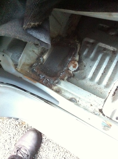

Anyways, we're fixing rust holes in the floor today, so there is some progress going on, thank god

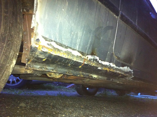

Anyways, finished a huge rust hole on the drivers' side today, so we are roughly halfway through on the floor. Did it with my dad, arguing all the day through. I thought we were gonna kill each other. hopefully tomorrow we'll get a more positive vibe going on. :D
Also, look at some other amazing rust spots. :mad:

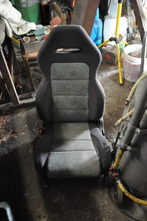

Got GTi seats yesterday.
The pair is butt-ugly and dirty(no problem with that actually.) also in worse shape, so I hope I'll get passengers' seat to match the third one. But either will do.
