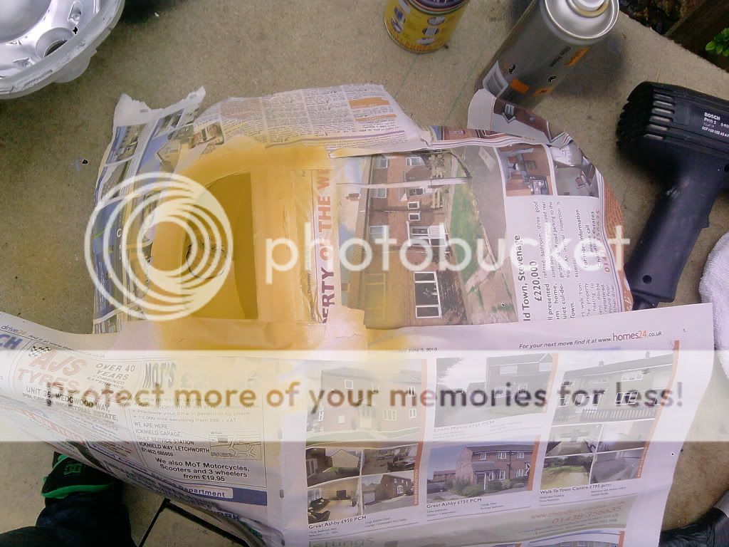

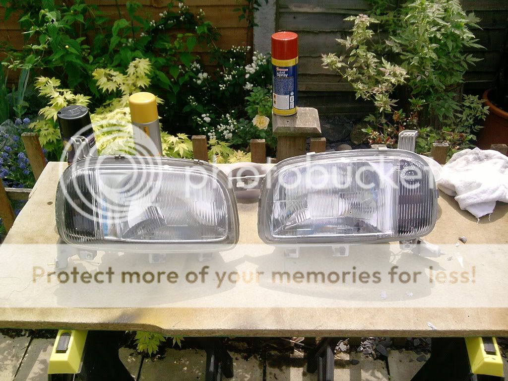

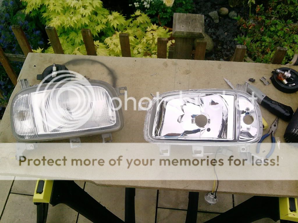

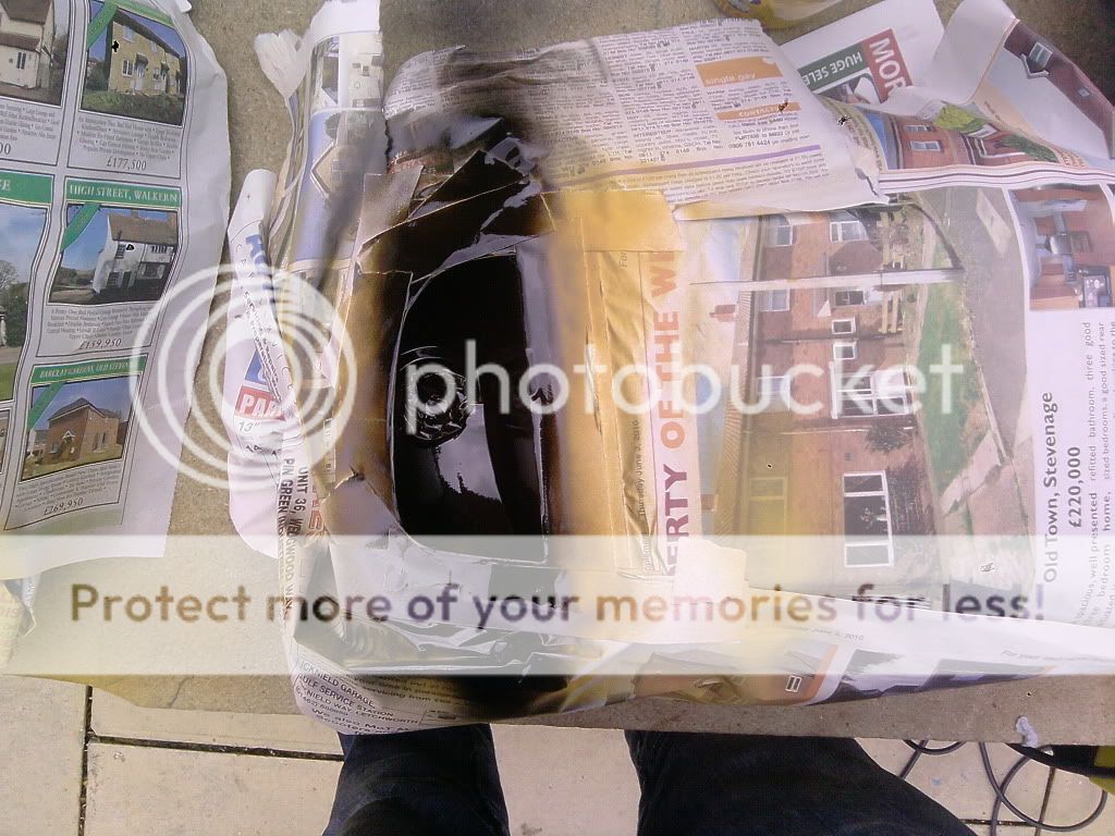

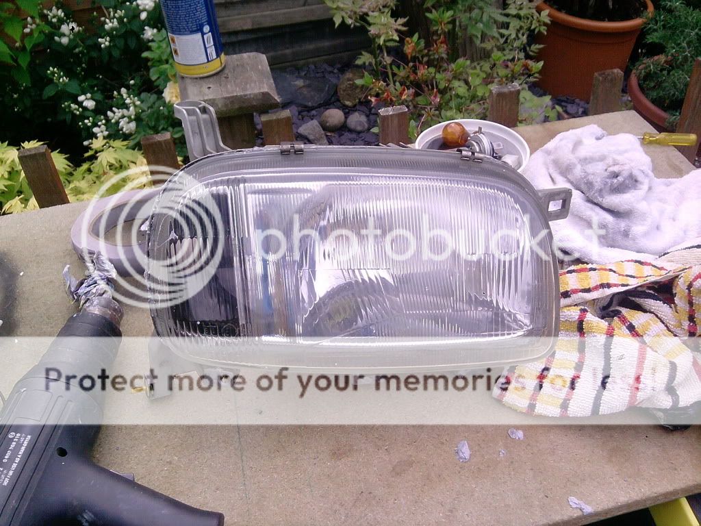

regarding your lights i used a heat gun (mum wouldn't let me do it in the oven) it was a bit fiddly a case of break the sill on one side wedge it open and move to the next till its done then just mask prime paint heat up the glue and stick the grass back together hope the pics help
