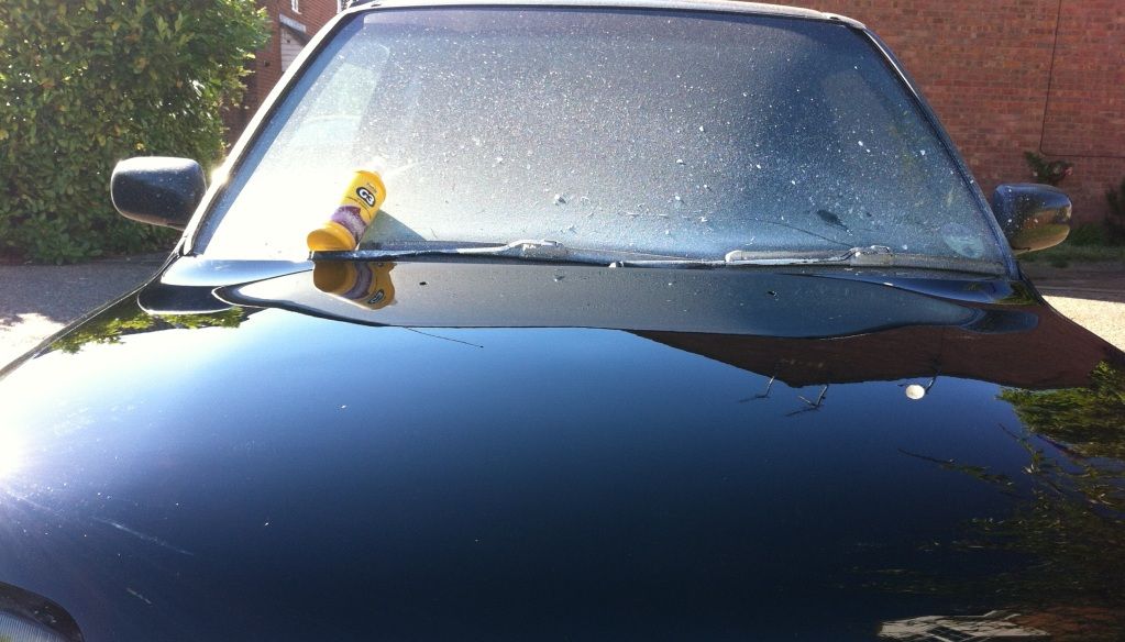

So heres the bonnet as it was (with dirty water marks)

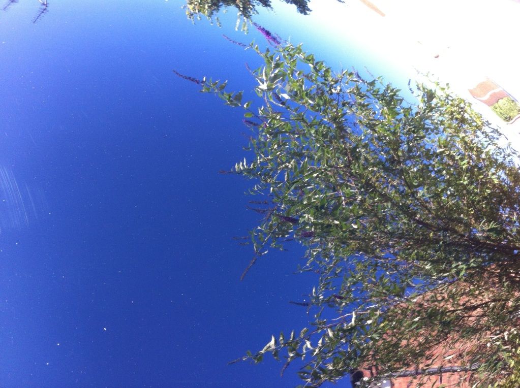

Used G3 compound on a buffer machine and...:

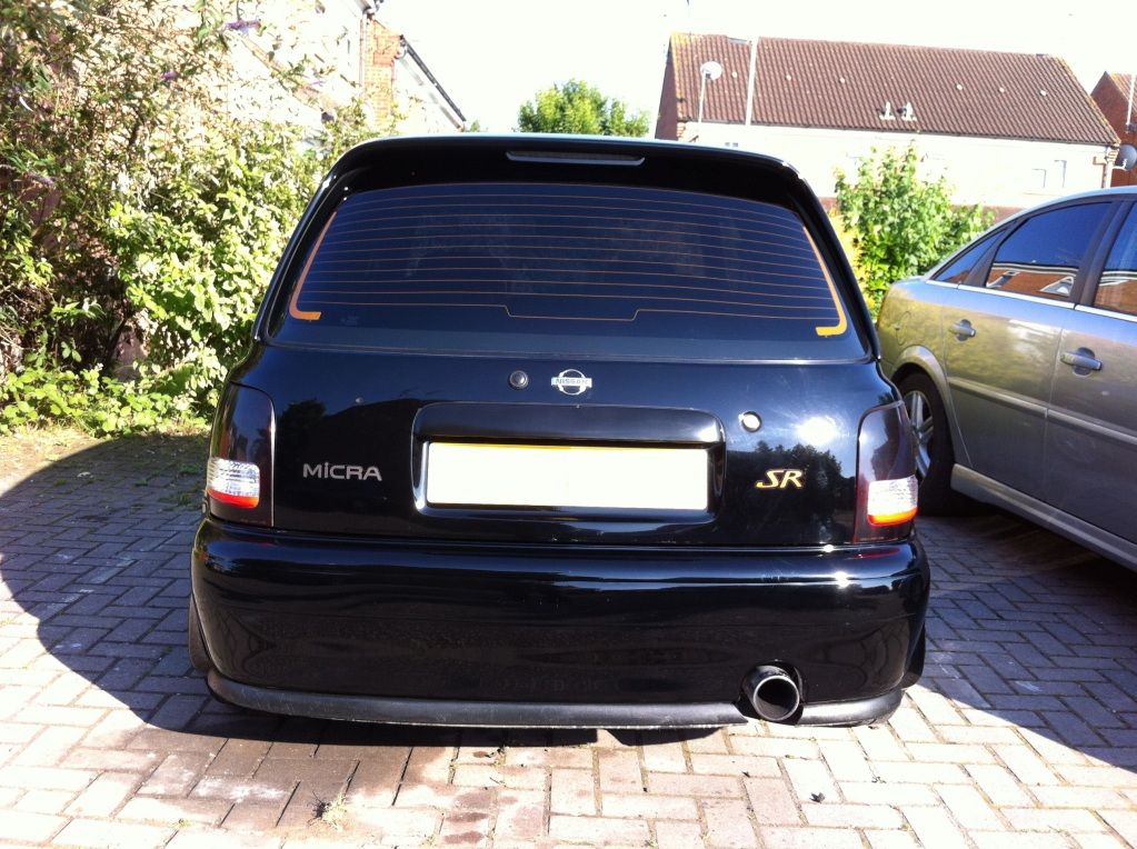

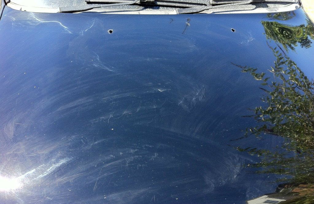

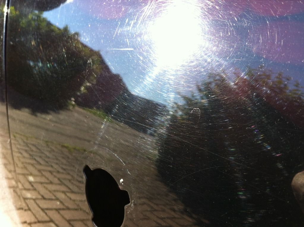

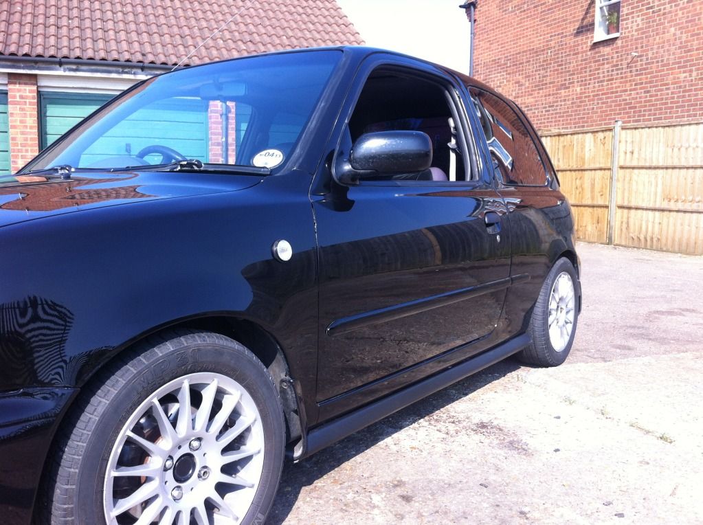

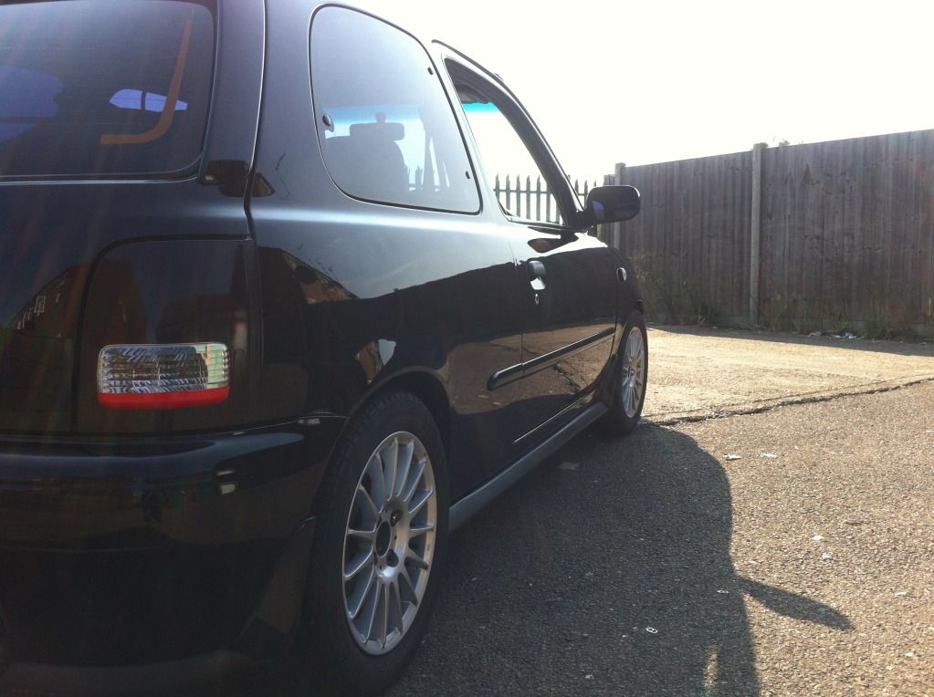

Was so chuffed with the results, i thought id go ahead with the whole body, most of the body was like this (or worse)
and the result
Pretty chuffed with the results, :)

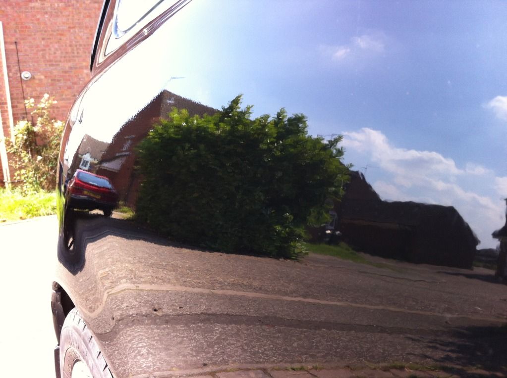

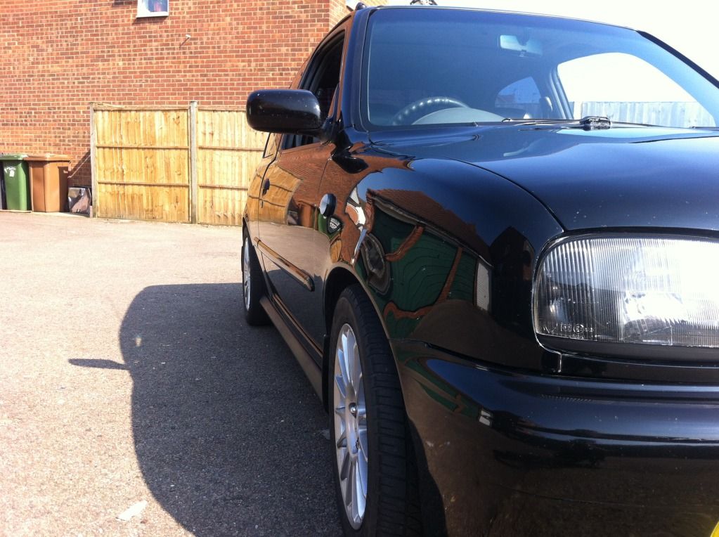

You can also get g4 g6 g7and g10 (i think) which is finer to remove swirls. I used G3 then T-cut and i used Meguires swirl X as a last application which is the final few pics

Yep just g3 for the main results.
I used 2500 grit wet and dry paper, very very wet and light movemtn and pressure. Checking every 5 strokes or so. Used 2000 grit on heavier scratches but very carefully.
Then buffed with g3 only a couple applications of it was enough really. Used tcut and swirl x for final touchs but g3 was really enough (first few pics of the buffed bonnet are just sanded and g3 buffed)
