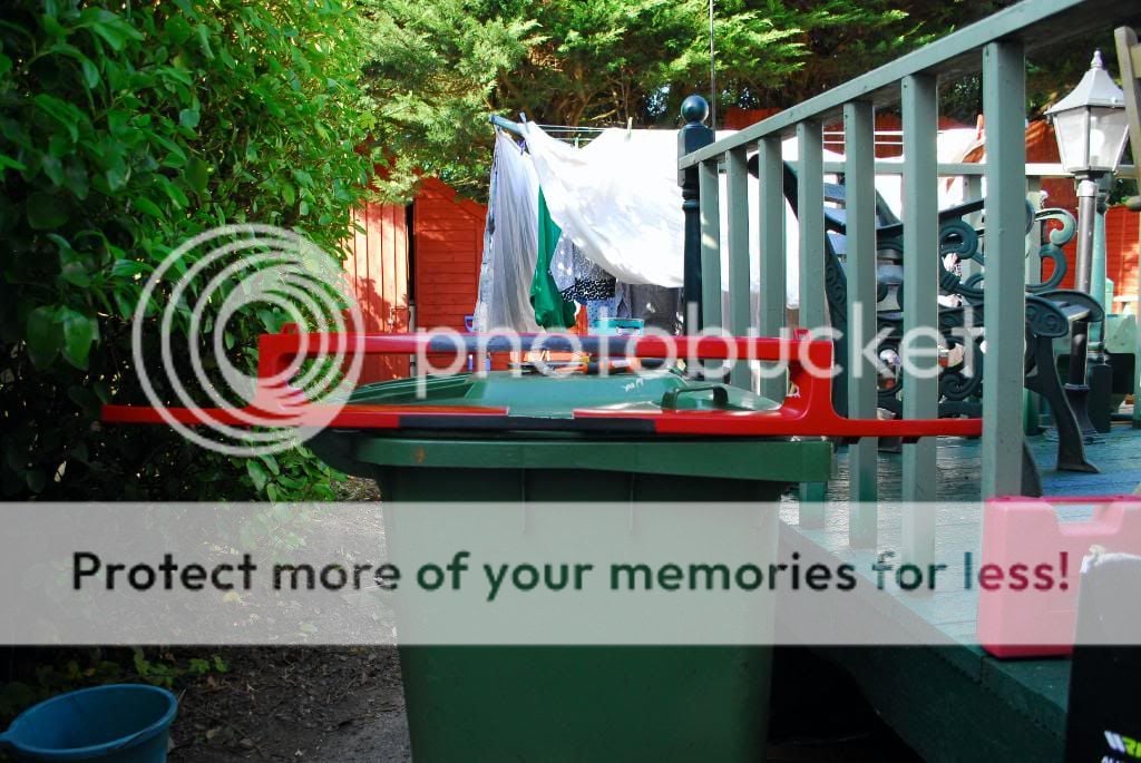

Open mouth grill
Got some more work done

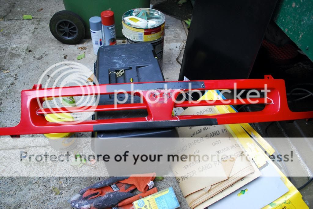

startedby making an open mouth grill

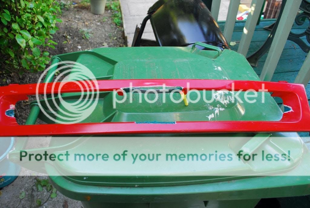

Started by cutting out the centre

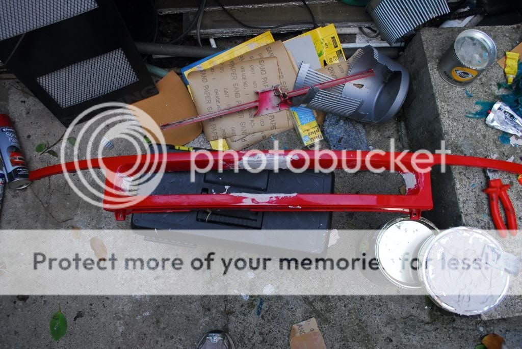

Fibreglass paste and some plastic cutouts to bridge the gap

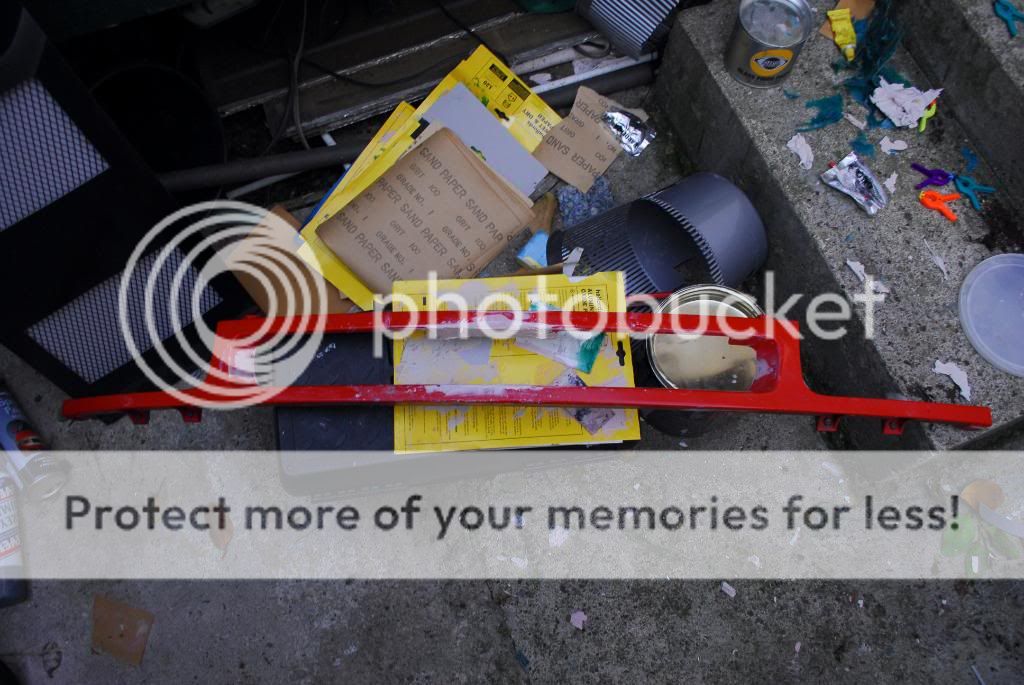

Then some filler,making sure to build it in layers to help prevent any cracks

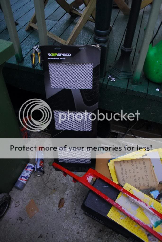

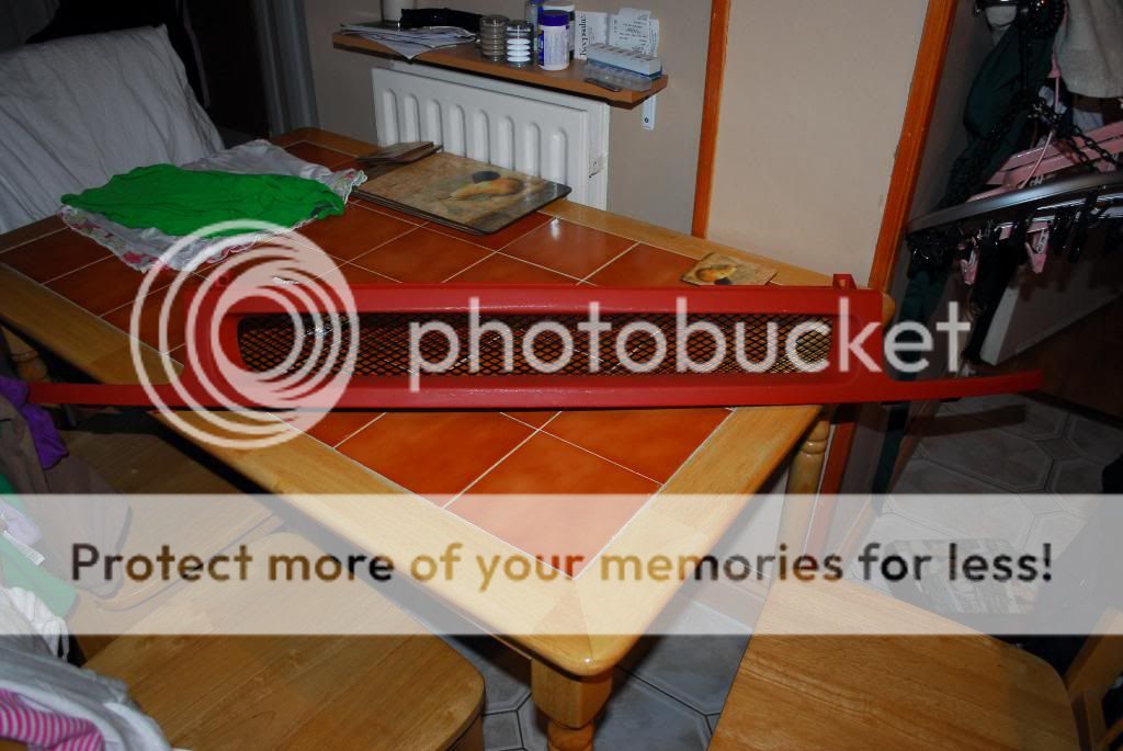

Now for some rip off mesh

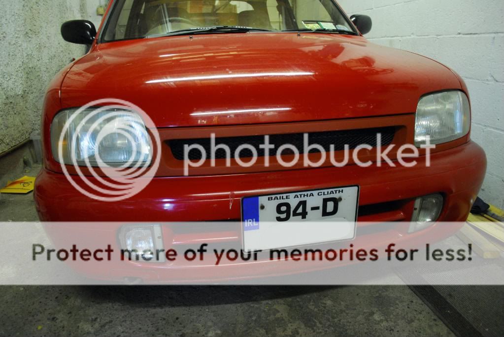

End Result
i think it looks fairly good
