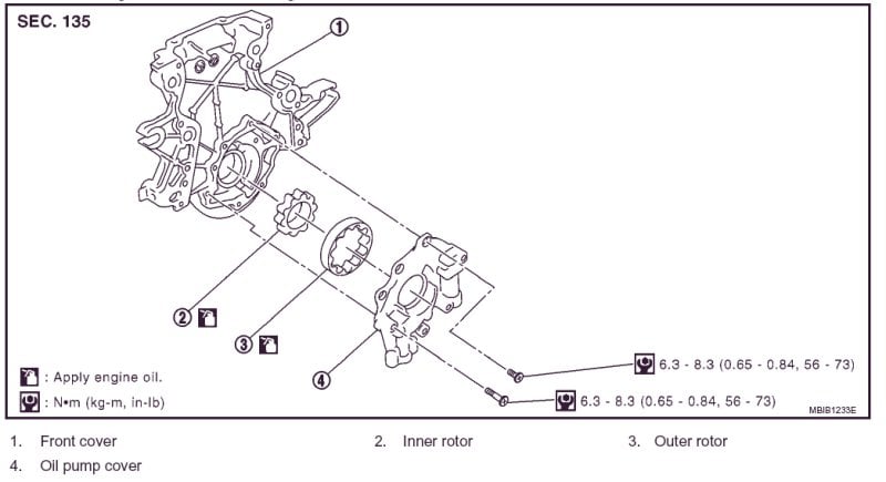

T tathan Apr 30, 2008 #1 Can't find the answer anywhere and need it asap sorry! Could somebody check a Haynes or Autodata and tell me the specified torque for the three bolts that go from head to the top of the oil pump? Ta muchly

R RickBlackK12 Ex. Club Member May 5, 2008 #2 Hi Mate this bit or let me know as you don't state engine size or petrol/diesel etc. Regards Rick
J J'S_NISMO May 29, 2008 #3 hi i work for nissan and thay dont list a seting for the bolts spoke to a couple of lads at work and thay say to nip them up about 8nm
