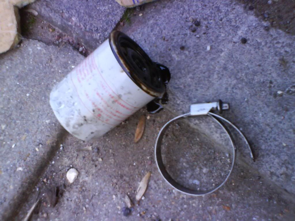

YES IT IS-----------my technique's official white meat spreading the heat
tighten up this throttle body clamp on it (or a similar sized strap)
at the right angle/place
=long socket extension bar hammer to tap the edge anti clockwise from beneath,so car on the axle stands
2 wheels with tyres under body weight of car as extra safety if you want
a good k11'r always has a spare throttle body clamp (by chance) or a
similar sized strap

the clearance messed me up could not get hold of it solidly and it was only the extra power steering stuff in the way
usually wrapping a rag round em does it,but as no access managed to get that clamp round it tightend solid and bash the edge with the extension socket
you could pop em with screw driver thats messy and i still wouldnt have any much place to turn the driver
i could only get it from beneath
