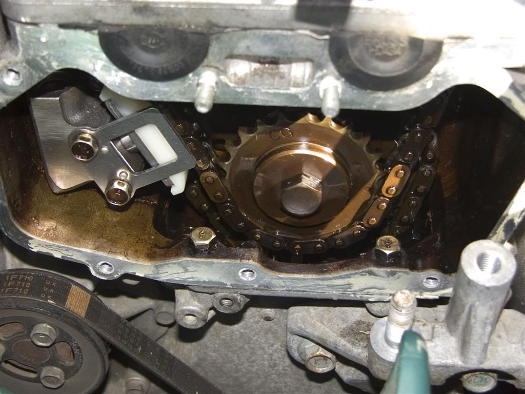

The timing chain tensioner's wear Ryan (clacking chain noise), pop the inspection panel off the side of the head & you'll be looking at it.
