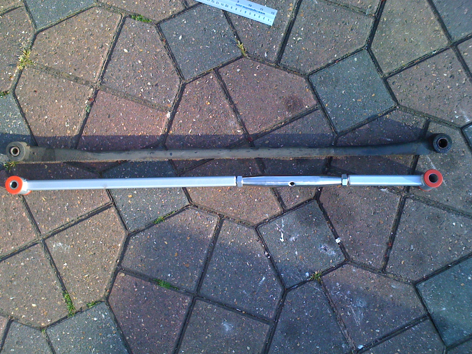

So I found this picture:
img_0694-jpg.18550
The bush on the left was the one that I still had the insert for, but have since lost :oops:
The one on the right didn't come with the rod, as it was fused to the car it came off.
So both stainless inserts need an Outer Diameter of 17mm.
One side needs an Inner Diameter of 12mm (so a 5mm wall)
The other I presume needs a much larger Inner Diameter. That insert looks 1.5mm thick from that photo. Can someone confirm this?
