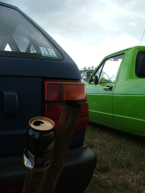

RTLkyuubi im loving that exhaust, if it is:laugh:(Y)
