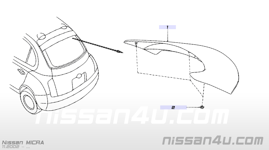

Being of an inquisitive nature, (retired design engineer) I looked into this a bit further ;)
The OEM factory fitted rear spoiler (K12 SR, Sport+ etc) is slightly different
and screwed and bonded onto the tailgate....
The one for sale on ebay is the one from the Nissan Micra K12 Accessory catalogue and has been designed to be post production fitted using just bonding, hence the bigger surface area, in contact with the tailgate, in the centre.
