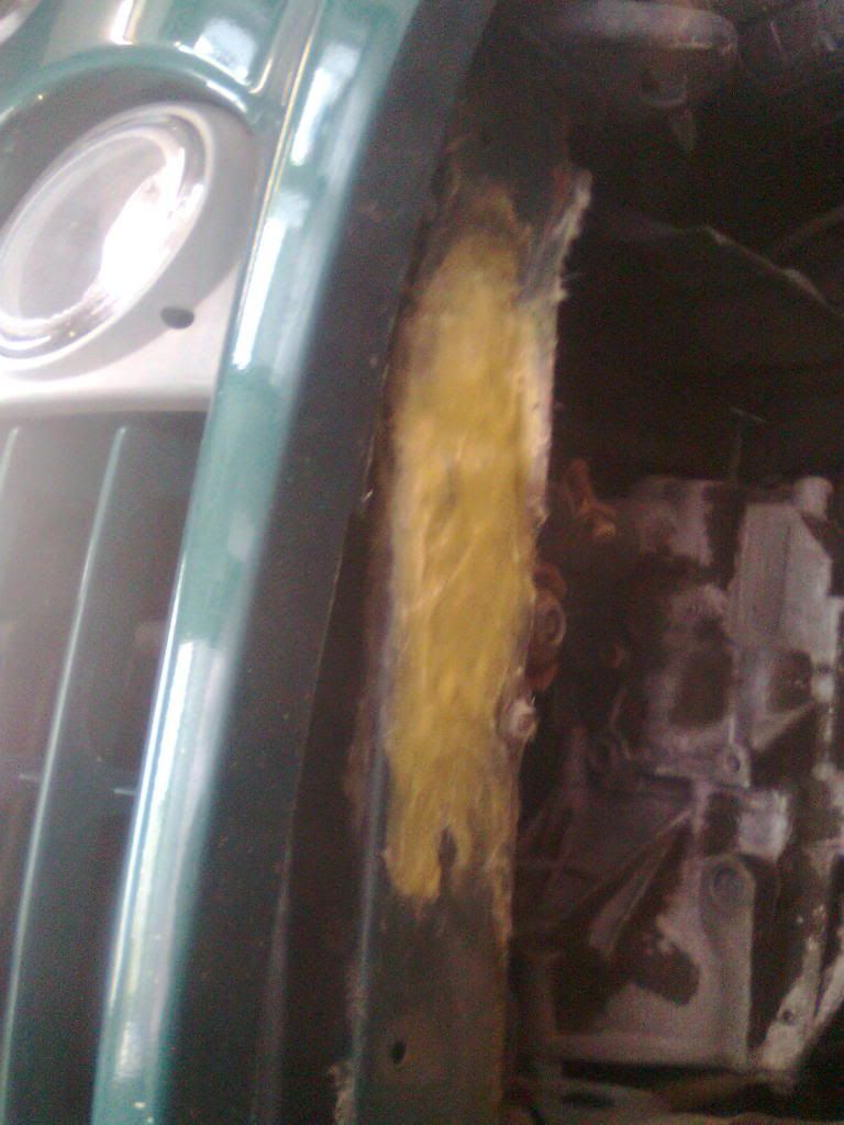

see image 3407-3414.

Just pasted the picture to make it easy for you.
Oh my God , so you are saying he has not welded, as he said to me he had welded, i think he was going to add metal plates on the section where it was rusted, but when i went after an hour he said to me, he had already welded it and he already applied yellow colour fibre glass to fill it up to make it level. Then he was going to apply the rubber stuff like hammerite.

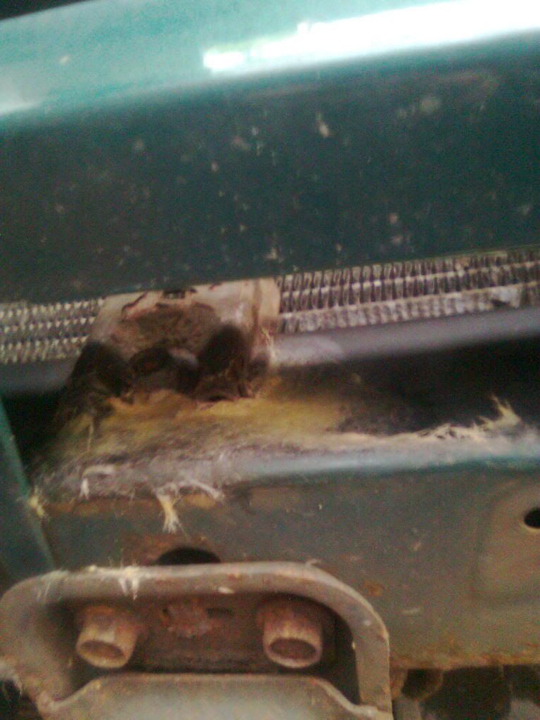

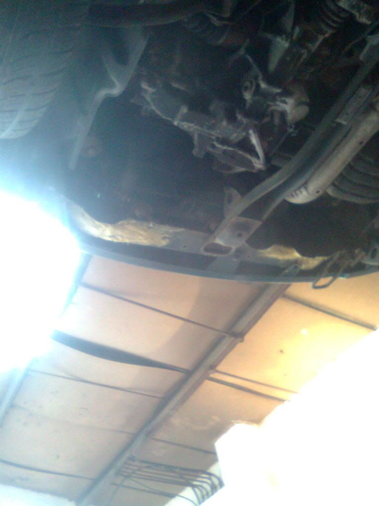

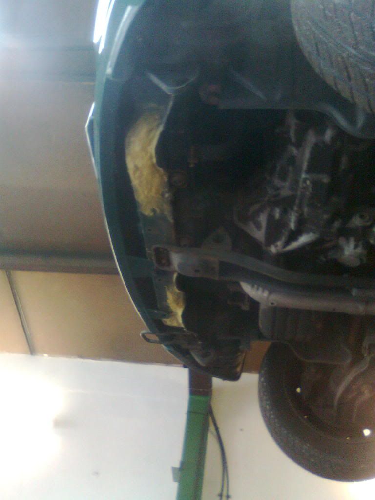

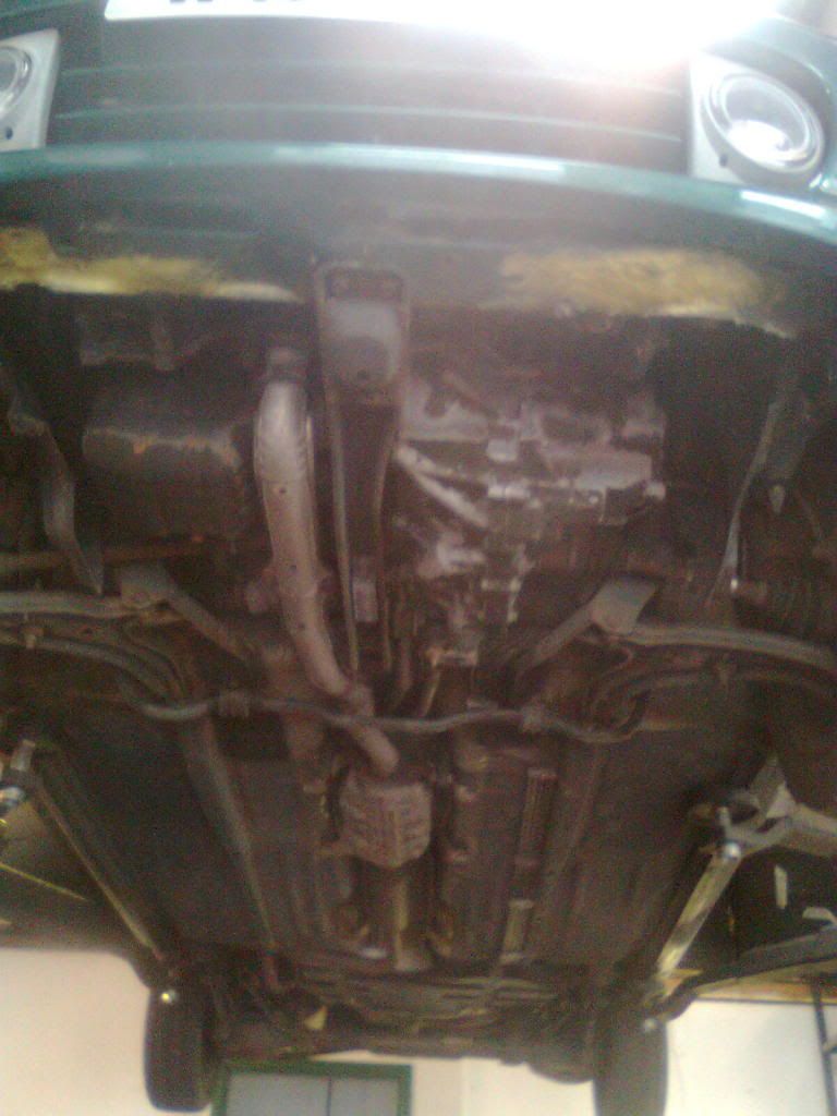

I took picture of this when the Mechanic he went to answer his telephone, so i took picture from my phone. However he had to paint the rubber stuff on top of the fibreglass and all round the front cross member, where visible.
In order for me to look at this, i will have to take the rubber off and the fibreglass, is this right.
How will i then get the garage back to do the fibreglass filler and paint the hammerite or i will have to Do it myself by buying it from the Shop.
I will have to go back to him next week and ask him, as if he did weld the plates then there is no need for the fibreglass filler, as this would cover the holes/ Depression. I think he just filled it up with filler and pass the MOT.

To be honest "if" he has welded that id be VERY suprised. You dont need to cover welds like he has, i nice coat of underseal is fine.
I'd scrape that off and see if he has welded it.

that has NOT been welded. If it had been welded, all the surrounding metal would have been cleaned back before welding.
If you wanna be sure then hit that chunk of fibreglass with a hammer or screwdriver, if he hasnt welded it then its gonna go right through.

i went to the Garage today and asked him why is the guard missing underneath is missing and he said, as i have welded it, there is no hole to place the plastic shield guard back, as the holes are all covered.
This was it , as he said he has welded the crossmember and passed the Mot, as he would not pass the Mot if the job was not right.
As said previously theres no need to fibreglass the crossmember if hes welded it, you just cover the welding in stonechip/waxoil. Hes just slapped that on to hide his 'work'. Fibreglass has no structural use in a cross member! Tell him youre reporting him to VOSA, for the standard of work, just make sure no welding has been done, im 99% sure it hasnt been welded though, theres just no need to fibreglass it unless youre hiding something
he might be covering his birds#it welding with the P40 eh, but the crossmembers on k11,s are a grey area on mot,s tho, so be carefull if accusing him on a legailty
