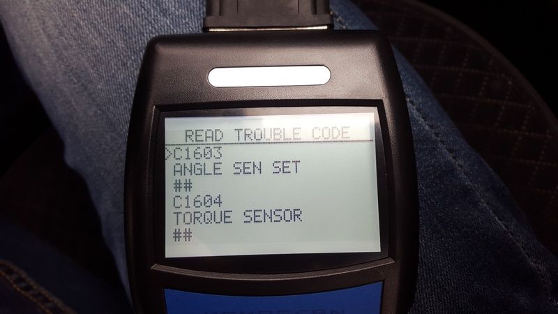

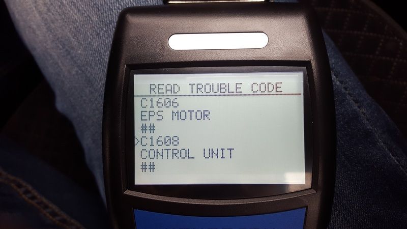

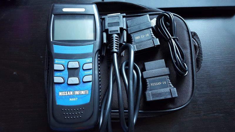

Hi all, here I would like to share a little experience with my Micra. The EPS failure seems like a common issue with this particular Nissan model, and it bothered me a bit since I had my Micra second hand while it's done around 40,000 on the dashboard. The red PS light sometimes came on results no power steering, but it usually goes off after second On/Off try then power steering came back. About 3-4 month ago EPS finally gave up, since then I got to drive really hard as steering became so heavy. I looked around for a solution, it is just too expensive to had a new steering column fit in, so here comes OBD tool N607, it's designed for Nissan cars known as Nissan consult II copy cat, it detected fault codes on the electric power steering ECU, and I wiped it all out, then PS red light go away and power steering restored, I never felt a car steering could be that so light, it feels like no resistant at all lol. I initially bought an AUTEL MD802 4 system version it didn't fulfill its duty as it can't communicate with electric power steering ECU, late on I realise there is an all system version of the model it might read fault codes from the electric power steering ECU but I haven't proved it yet, my recommendation is go for all system version if you are thinking buying it.
Some pictures I took during use(I only have the tool used less than 2min lol).

What’s the DTC they keep resetting? The only way the PS light will come on us if there is an internal fault on the EPS or there is a CAN/wiring issue. If the PS light is on and the steering is heavy then the EPS is faulty.

Hi Jason, @huttojb can you help me out with a replacement EPS for a 2004 K12? Steering is heavy, PS light on and faults C1603, C1606 and C1608 stored. I'm located in the Scottish Borders TD11QD. The issue with the car has been ongoing for over a year now. It got through last years MOT when it was only intermittently loosing power steering, but now mostly doesn't work. Thanks in advance, Greg
Hey Greg. I’ll pm message you but it’s coming more and more a none economical repair unless you really have a soft spot for the car.
