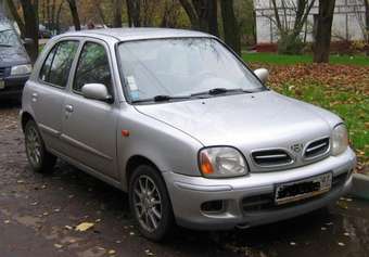

Is your Micra similar to this one?
Oooh, didn't see that! "52" plate can be either of the Micras.. The 2002 or 2003.. Hmm, well, I know nothing of the K12's. They're too Renault for me.
