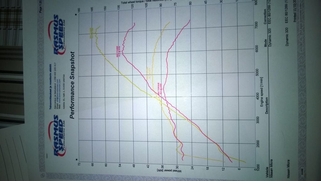

28-30 degree ignition advice was best for my engine, i got 64,5kw @ wheels, i can upload dynosheet in near future.
dynosheet, just wondering what stops my power coming at 6500, doing that hill climb up and down. micra will rev to 9k without asking, but power curve start lowering at 6.5k rpm.
ITB:s got 200mm runner lenght from ca to butterfly, and exhaust is 2" from start to end and 4-1 header.
fuel is fine, but would it be an ignition problem or valve spring hang?

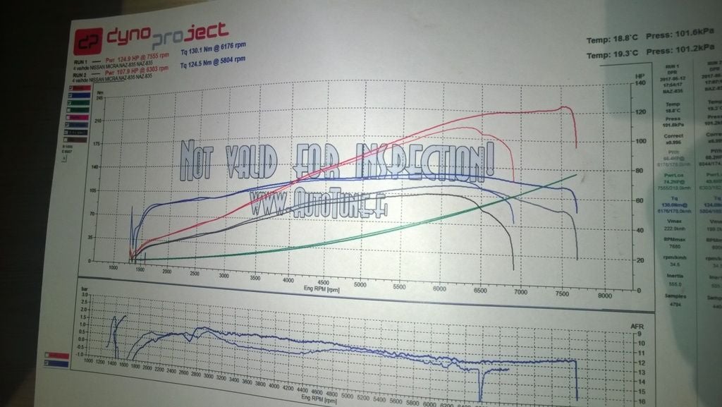

Okey, i upload now dynosheet if somebody even cares =)
next thing is getting few more horsepowers. This thing we call in finland "hungry goes bigger when you eat".
So i need advice with exhaust manifold, how is janspeed manifold rpm tuned? primary lenghts and inner diameter is what i like to get know. Also i will now get velocity stacks for itbs. Maybe some head skimming? =)
i think im gonna tune intake for 8000rpm and if i would get also exhaust tuned for 8k i will get longer power band.
I think there isnt much left free horse powers what i can get easily.

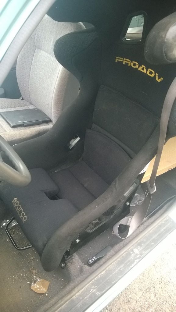

Second thing, yesterday i bought sparco proadv bucket seat and 6point belts.
If i cant get my engine sold i have to keep getting more power and more rpms from this engine.
edit:
Sparco installed
