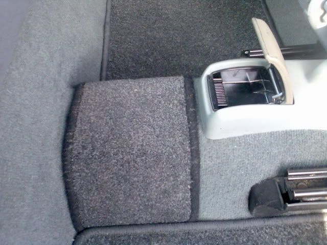

Finally, the interior tray from the 'bin' (not very technical as I said) is missing:
http://i279.photobucket.com/albums/kk147/the_dandy_p/IMAG0017.jpg
I have the lid, which i took off in order to take the picture, it's just the insert/tray i'm after.

Regarding the 'bin' - You said that it had the lid cover, this is probably because it never came with the 'bin' bit which is actually a rear ashtray. You cannot get just the ashtray bit, they come complete with lid which actually a bit smaller than the original lid. I'm not sure if any of the later Micras were sold with a rear ashtray (Possibly top spec GXs and and SRs were) I know they had them on earlier higher-spec K11 Micras. I managed to find for my car though the colour is a light Beige and the interior in my car is a light Grey, so there isnt too much of a contrast, though I would have liked one in a matching colour:
The light and generally crappieness of the camera doesnt help either.
As said before I'd visit some scrappies first before trying elsewhere, they are pretty hard to get though.
Thanks all for your help, It looks like a trip around a few scrap yards tomorrow for the plastic panel for me. I don't think i'll bother with the rear ashtray, as once the lid is on, it all looks neat and tidy anyway.
