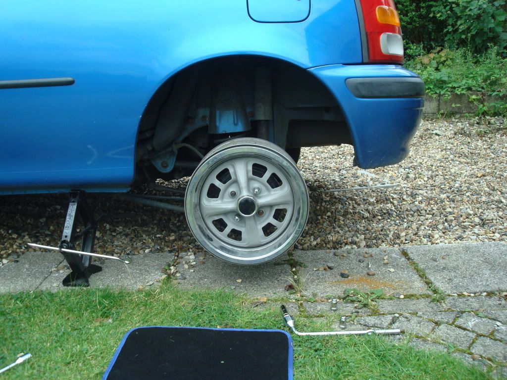

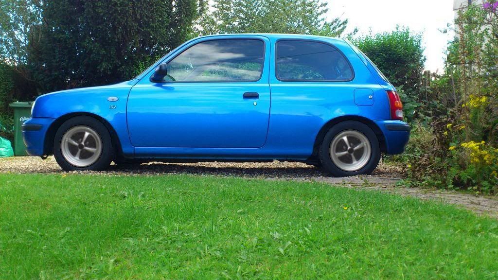

MGB Rostyles won't fit... I've got Vauxhall ones for mine, fit perfect as same PCD (4x100). First picture is a photoshop I did to see how the wheels would look on with some drop... other pics are my actual wheels test fitted...
Only reason why i ask about the Rostyles is that when i was looking at replacing the wheels on my MGB track car i read somewhere that earlier nissanshad the same PCD. Dont know how early etc didnt really look that far into it.How much of a weight penalty has the 1.6 got over the 1.3? Im completly stripping the car so i dont want to much weight over the front as i dont want to throw the weight distribution off too much.

Old British classics & old Jap cars used to have the same PCD, forget what it is but whatever the MG is... Now they're 4x100 & have been for some time... Pretty much anything off a 4stud Vauxhall should fit... Hope that helps?
