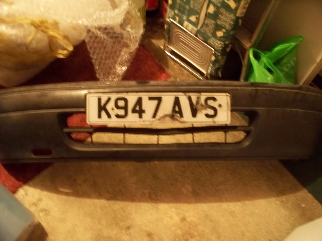

Just recived my super s bumpers...NOT....omg i am so mad, i cant actually word it! iv recived the bumpers and they are just your standard black bumpers? i just rang the company, and they where like we havent had any super s bumpers for about a year and a half...and i said but i dont need these bumpers? and they go well theres not much we could do about that! OMG SO MAD!!!!!!!!! so annoyed...i made sure i said to the lady i wanted super s and she said that everything is ok! omg anyways..i would say rant over, but its not in my head!

Oh and heres a piccy so that i can double check these are deffinatly not super s bumpers right? lol..

Wilsonian, how i see it, all though they aint the ones i ordered, they are still in a much much better condition than the ones i currently had, and it wasnt like i was ripped off? so im gonna just try and do the spraying that frank just spoke about.
