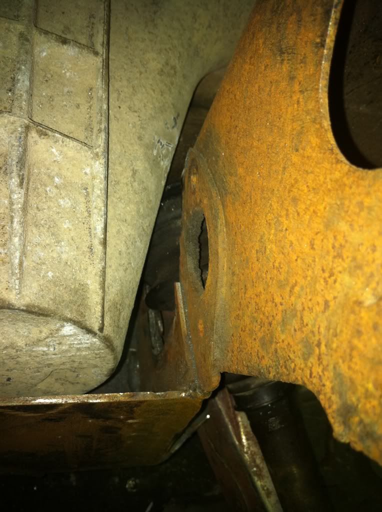

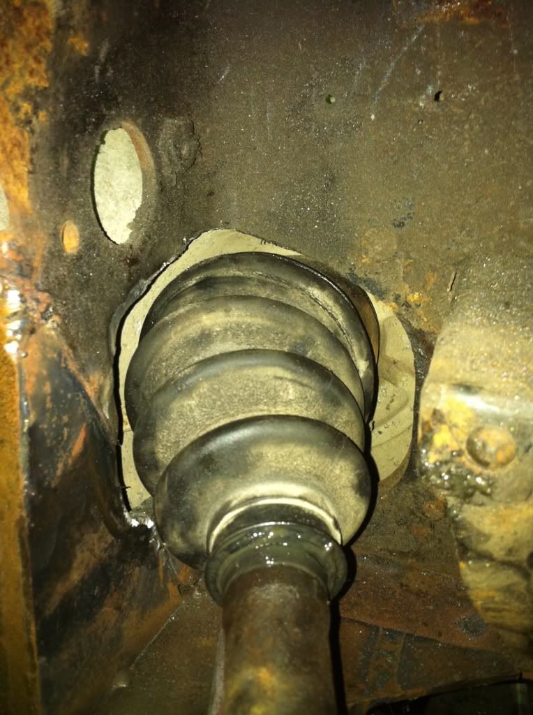

The reason I was looking at the N12 was a couple of the conversions seemed as though the diff placement and the angle on the drive shafts wasn't ideal.
This one:
and this:
Some other conversions look like they got it placed a bit further back with the same gearbox though.
