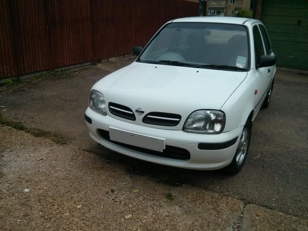

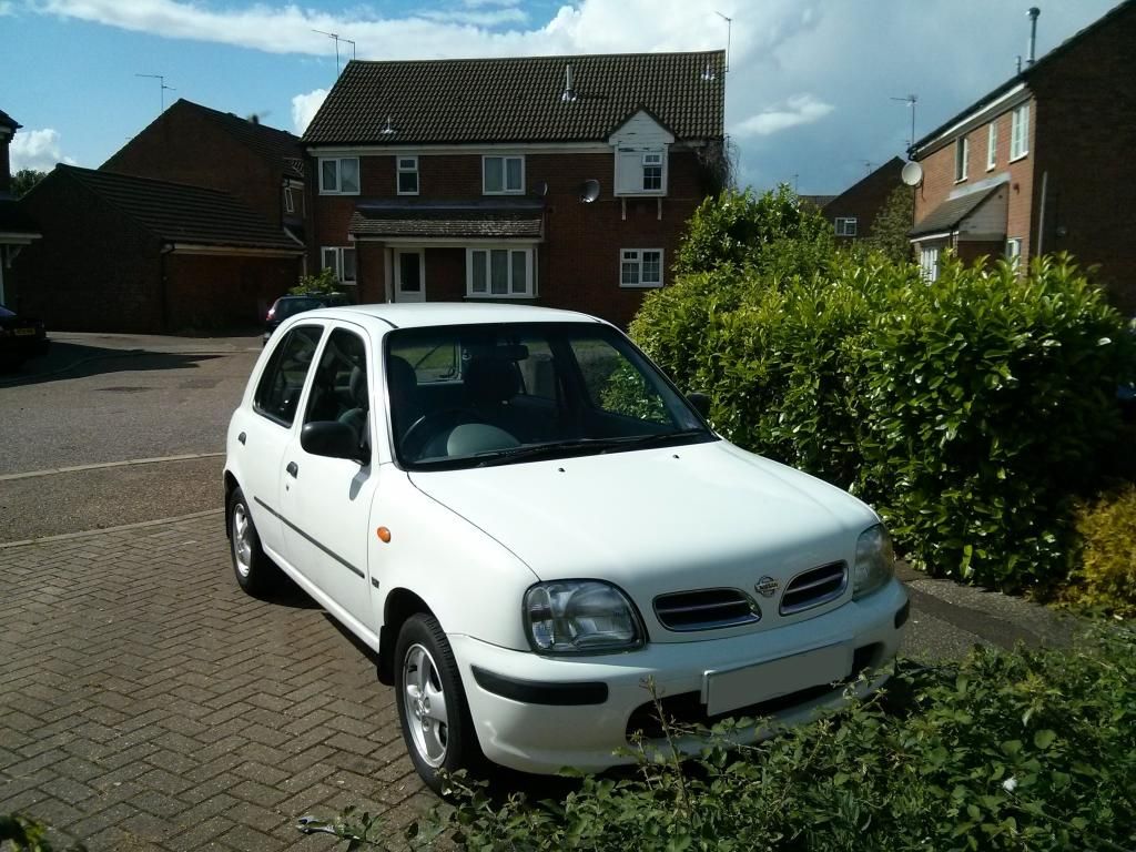

Hello guys.

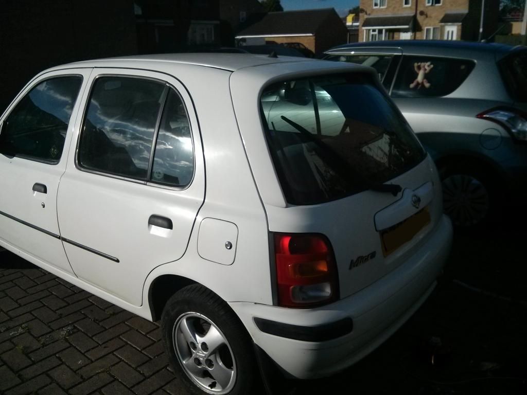

I recently got a 1998 White 1.0l Micra k11 which I'll be learning to drive in and hoping to keep after I pass my driving test. I got the inspiration to get a Micra from my brother, Sulur (who was a well known member on here :p). Now that he doesn't own a micra any more, I need to takeover!
It does have some bad rust on the sills which will definitely need fixing before MOT next year but other than it is a great runner. It is a Micra Equation so a pretty low spec model. I will need to make some modifications to spice it up!
Some of the things I eventually hope to do/add to the car:
  • Colour code (in white) the bumper trims, door handles, door trims, mirrors, and the boot handle.
  • Black out the inside of headlights (Also might eventually get the 2nd facelift headlights - think they look cooler)
  • Might get the non facelift rear lights but not too sure about that (tell me what you think)
  • Clear side repeaters
  • Install a central locking system (5dr without central locking is a pain in the ARSE!)
  • Tint back windows
  • Spoiler - Preferably the wrap around kind but depends on price
  • Maybe front and back splitters (I think Sulur has some spares :p)
  • And possibly new wheels and then lowering but depends on my budget and stuff.
Ill probably add some other little bits here and there but they are the main mods as of now.
Let me know if you have any suggestions! :)

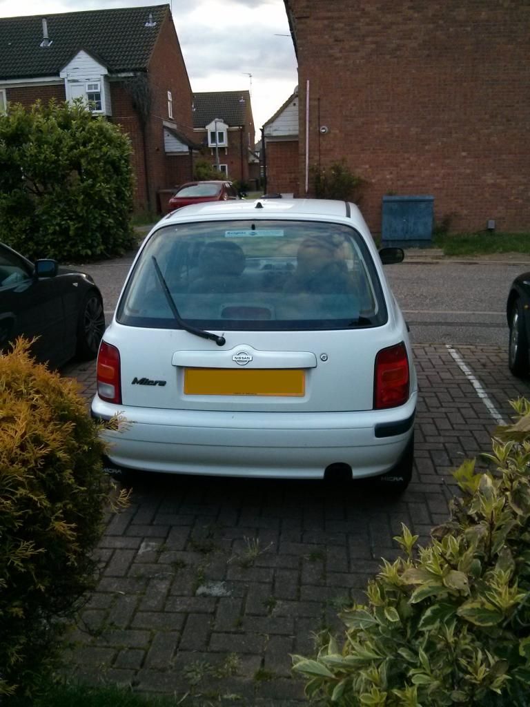

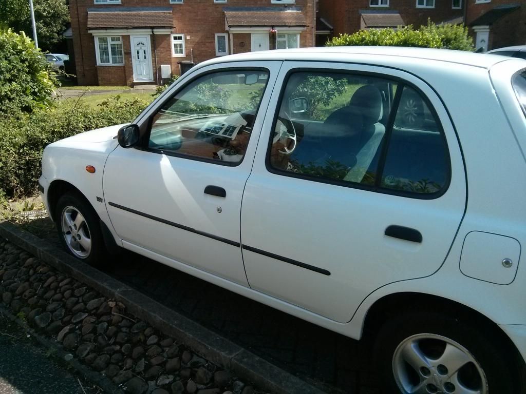

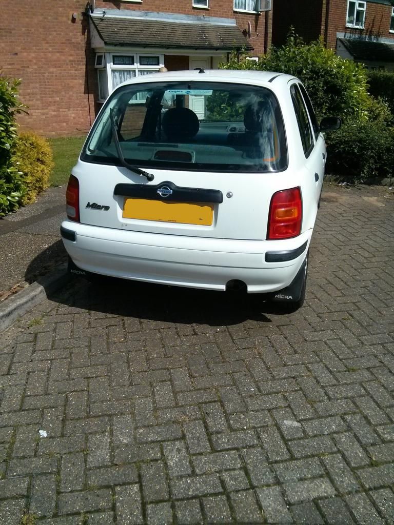

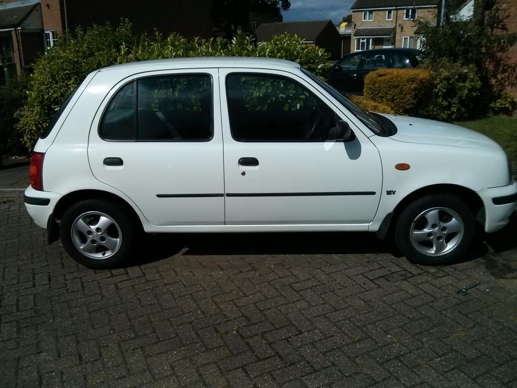

Here are some pictures of how it looks currently

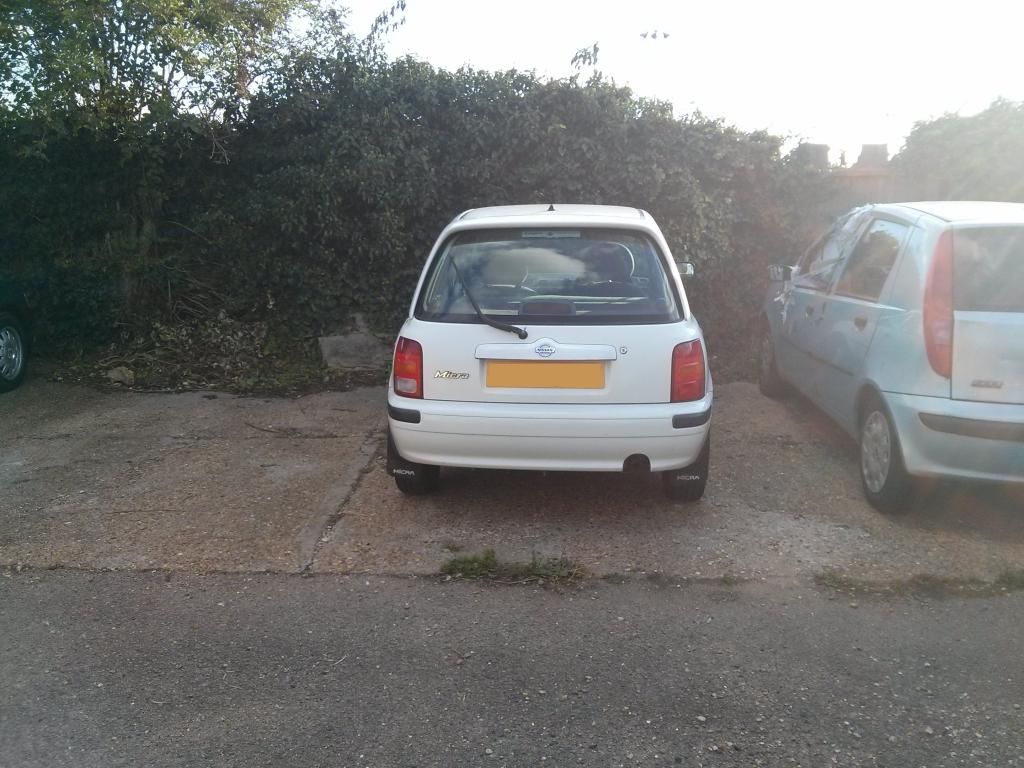

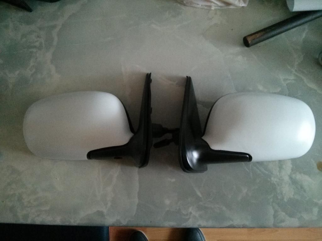

Had a bit of time and got round to painting the boot handle the other day. Next up, the mirrors, door handles and bumper trims!
Before:
After:
Sliighty off color match but its the right paint. Arctic white 326

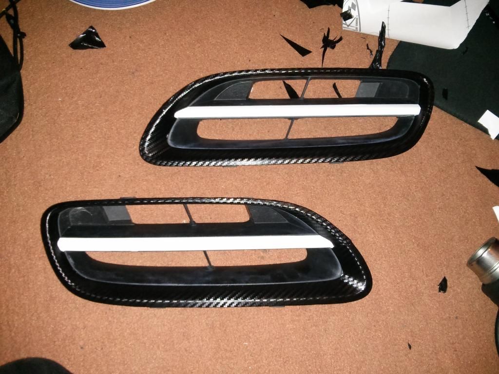

Your car looks to be in great shape, at least from the outside. I personally wouldn't repaint the black plastic trims but I guess that's up to the individual.
I would get the grilles wrapped in matte black though. It just sticks out in chrome (b/c no other part of the car is chrome.)

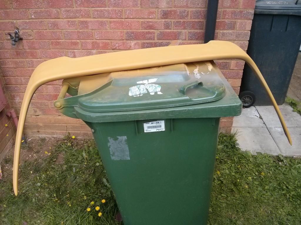

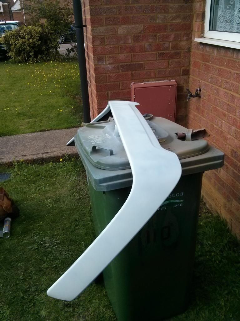

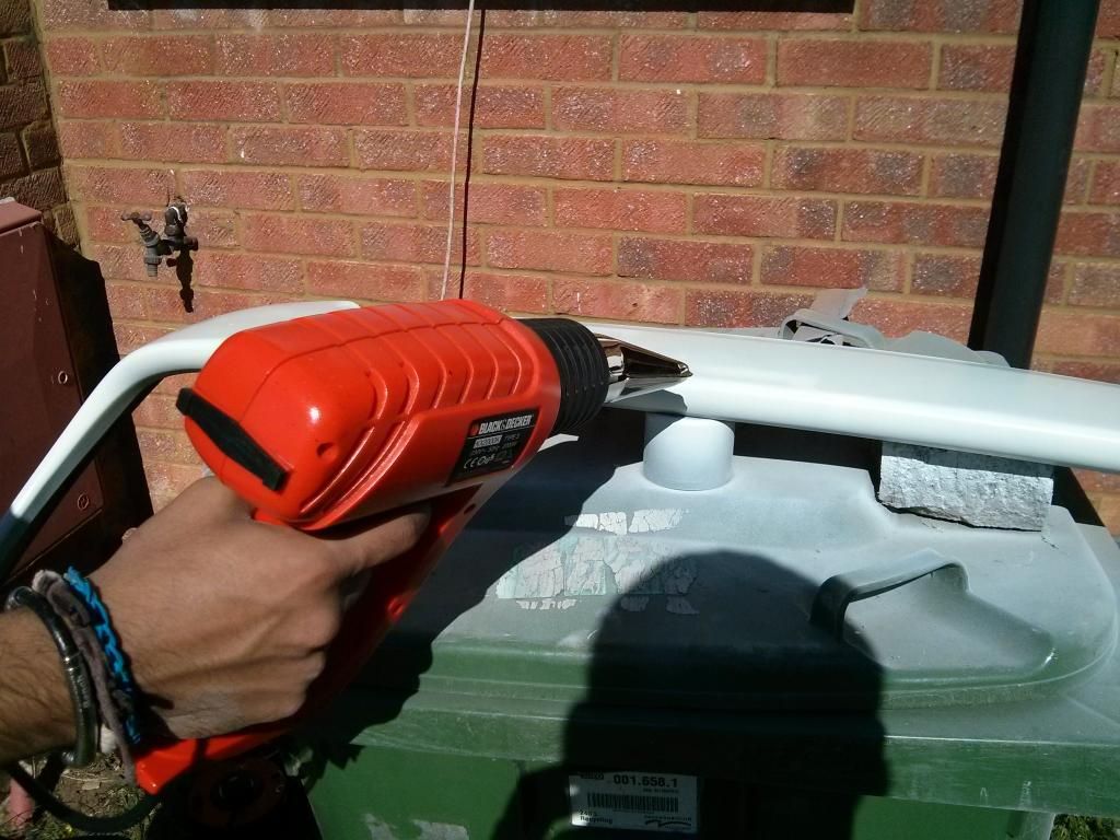

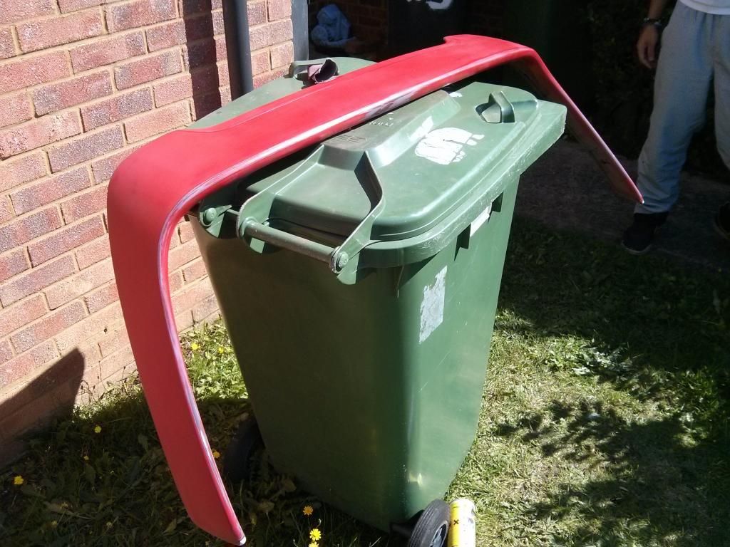

Managed to pick up a spoiler sooner than I thought (Thanks Paul Smith!), sprayed and fitted it yesterday with A LOT of Sulur's help lol. I took a bunch of pics just in case anyone was curious.
Sanding down to rougher surface. Also attempted to fix a small crack in the middle with super glue and then sanding it flat.

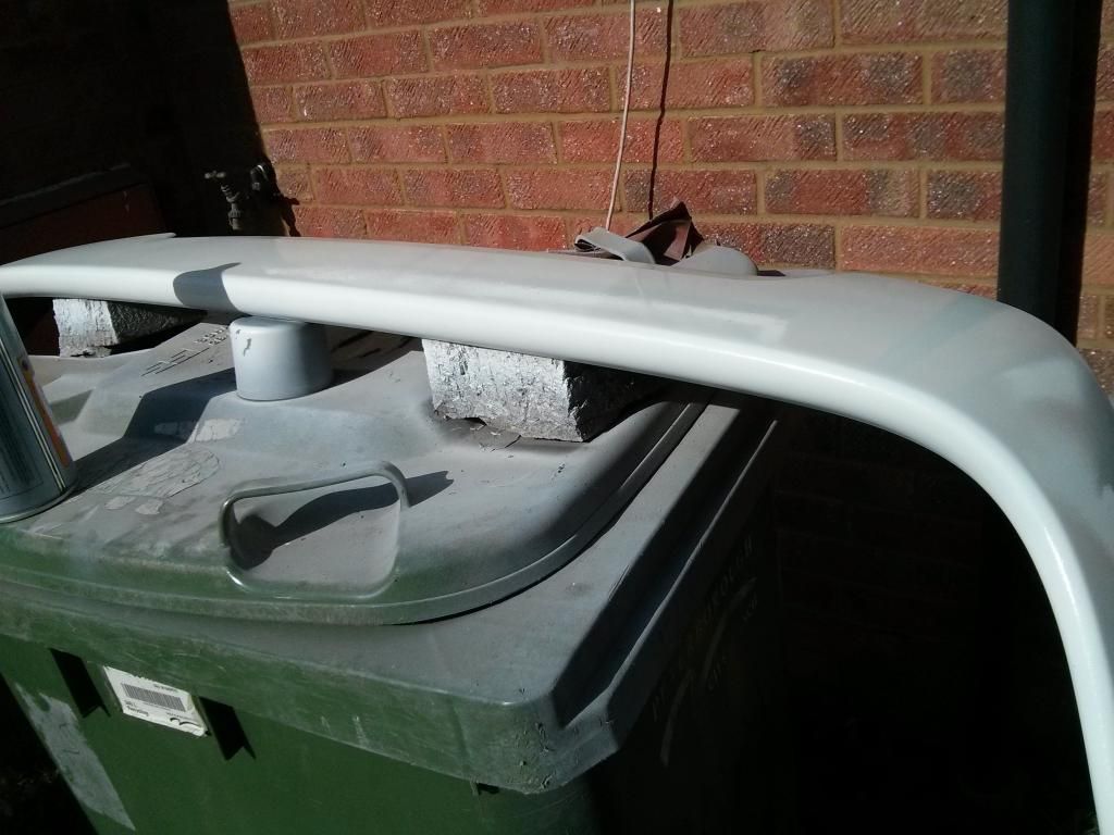

Then sprayed with filler primer. Sanded down smoother with some 1500 grit sand paper.

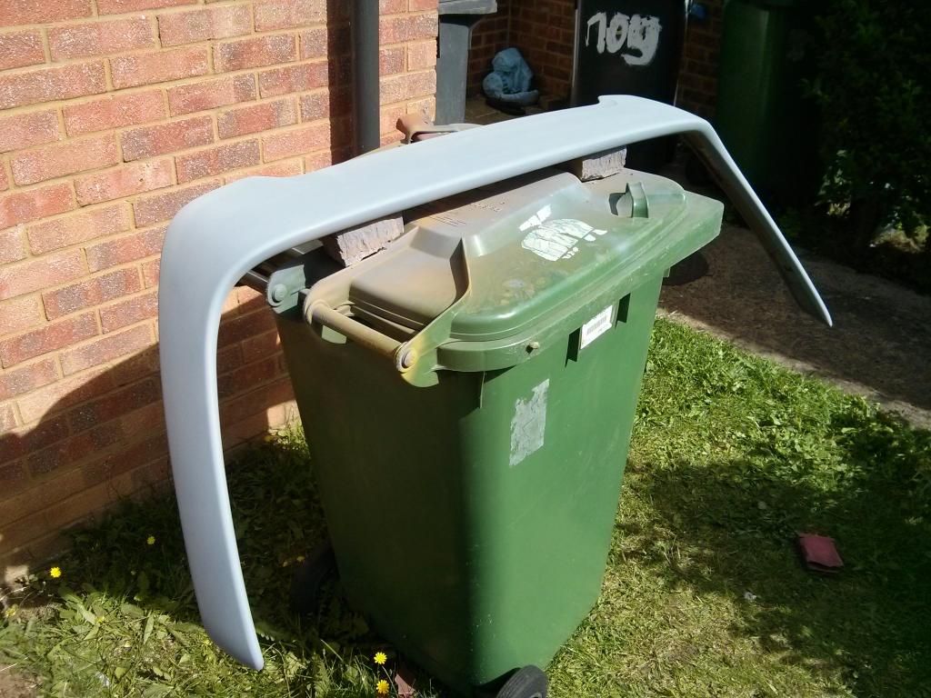

Starting to add layers of Arctic white 326 paint. Then a stupid little fly thought it was a good idea to go and sit in the wet paint until it got stuck! We had no choice but to spray over it and sand it off later :(
Used a heat gun in between layers to speed up the drying and looks like it gives it a smooth finish. It was also a good weapon for scaring off flies :p . Probably not the best idea to spray outside but I had no choice :(
Finally gave it a couple layers of clear lacquer so it was shiny it was ready for fitting!
I forgot to take pictures of the drilling process but we drilled the top two holes and left the sides to be tigersealed later on. Heres how it looks :)

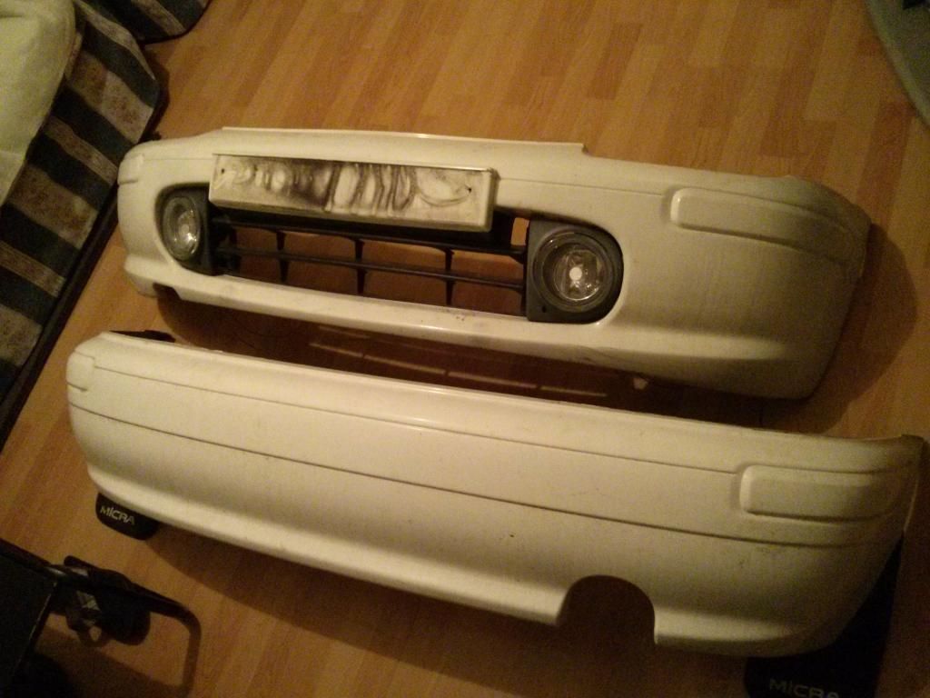

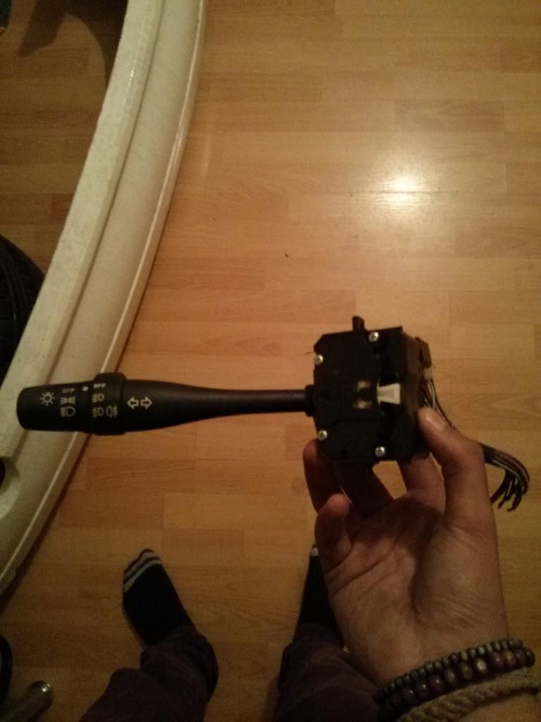

Got some bits for my micra few days ago!
Fully colour coded (white trims) front and back bumper. The front bumper has FOG lights too - yay! I also managed to grab the stalk with front fog switch on it. I have no idea how I am going to wire that up yet:p

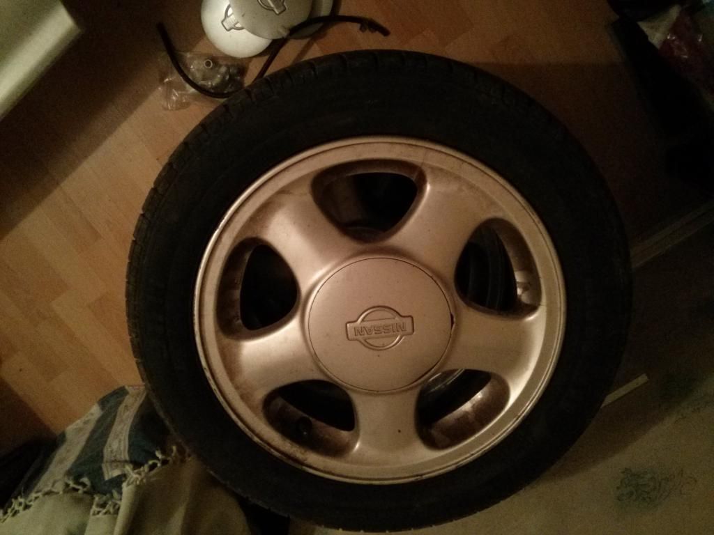

And got a set of 14" Micra alloys.
Bumpers
Stalk with fog switch
set of 14" micra alloys

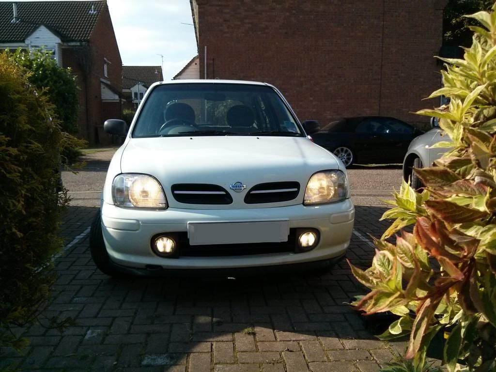

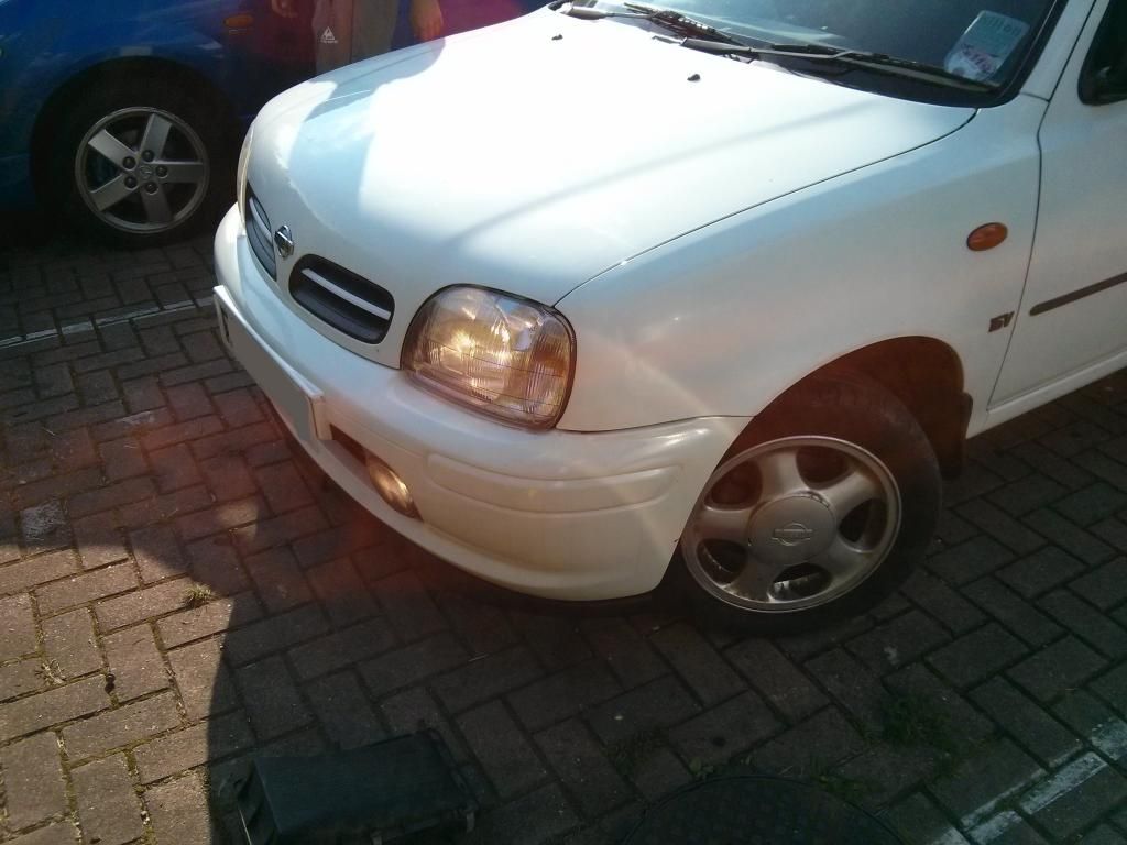

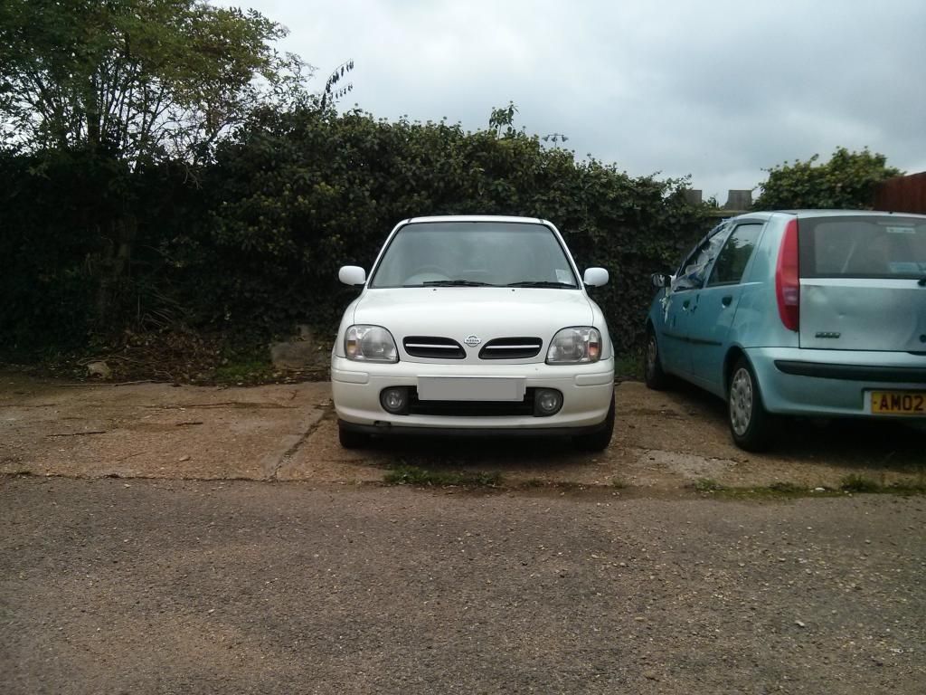

Spent some time fitting the front and back bumper (forgot to take pictures of the back because the front was more important). I'll have better pics soon one I give the car a nice clean.
It looks so much better! :) I put a splitter on as well but you can't even tell on this picture haha.
The fogs are just wired up to the beams at the moment but I want to wire the stalk with fog switch soon. If anyone has a guide or any help, that would be great :)
The car that the bumpers and wheels came off was sitting for a while so everything has gathered a fair bit of dirt on. I will be giving it a good clean and buffer soon so hopefully get some good pics :)
