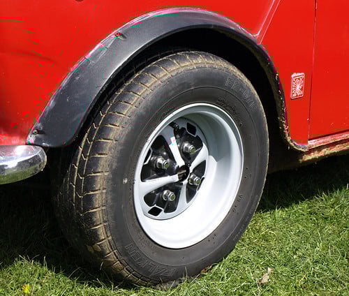

rostyle type im guessing
Yes Hoop, spot on... they're Rostyles! Didn't wanna give too much away before I had them fitted but I guess I should have known better than trying to fool the wheel whore! :)

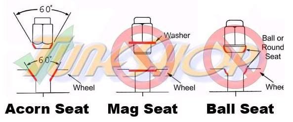

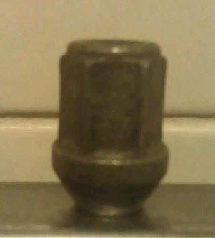

Would tapered nuts be what the yanks refer to as "Acorn seat"? Just I'm getting a set of Gorilla lugs and the best match to me seems to be the aforementioned acorns? The uts that came with the wheels (too small) pictured below...
Have you still got the stock wheel nuts? If so use them until you get the nuts you need :)
Yeah, stock steels still on, won't be putting the new ones on for a week or two yet (famous last words)... Have the stock nuts got enough taper on them to seat on the wheel properly an get a firm hold?
Just wanted to confirm before I purchase. Would you say these nuts:
Are what the yanks would refer to as Acorn seat (see below), I think we'd call them taper? Or are they ball seat?
