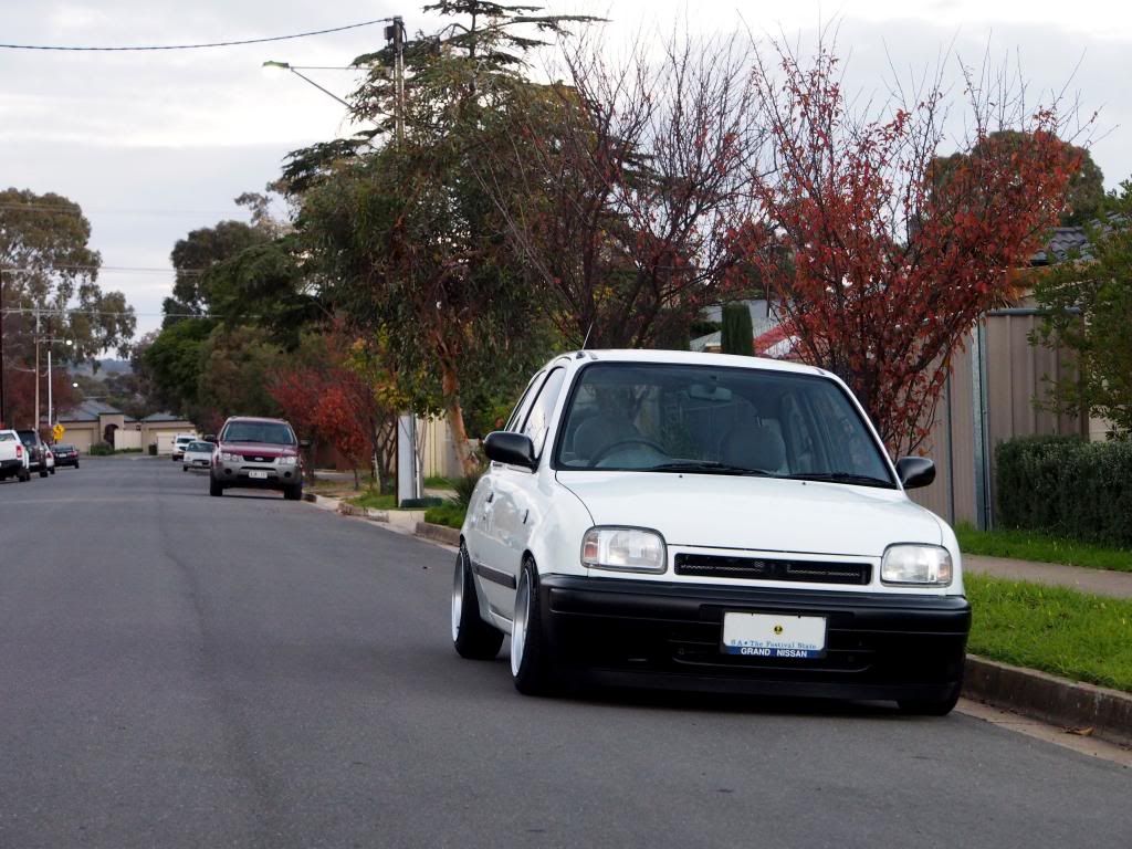

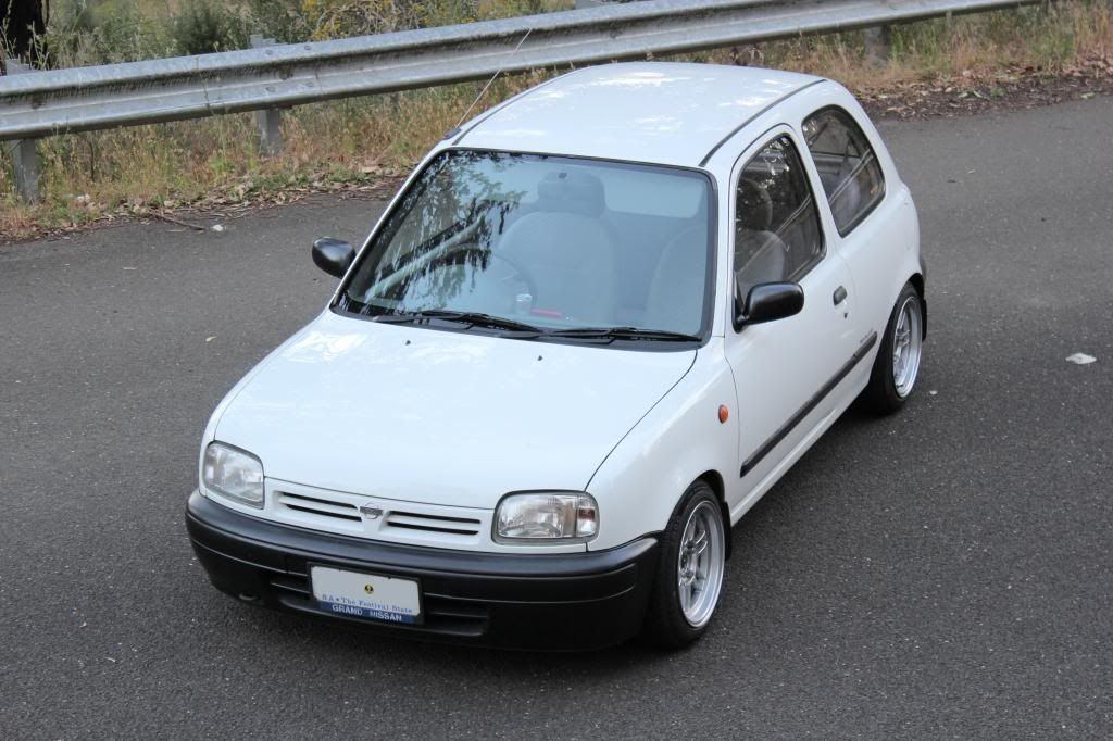

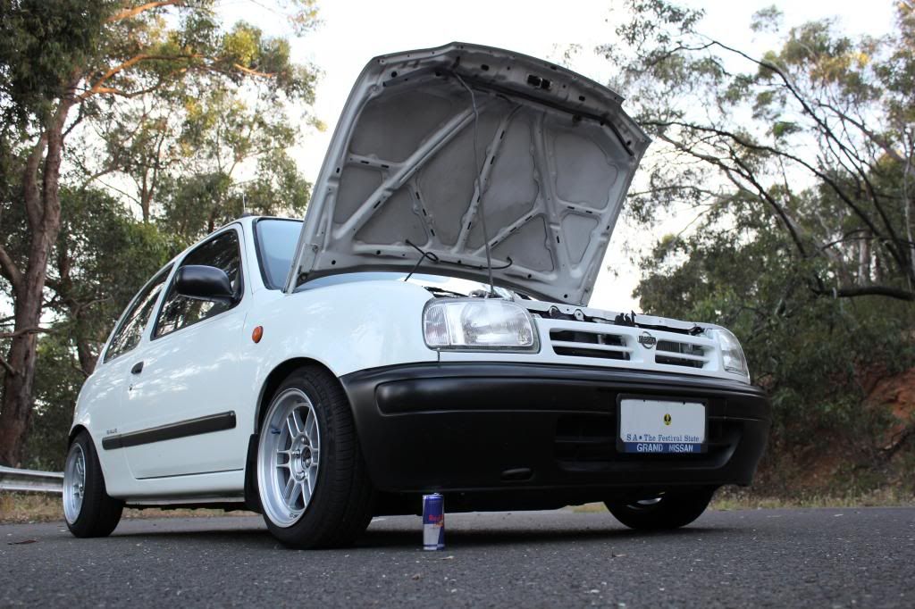

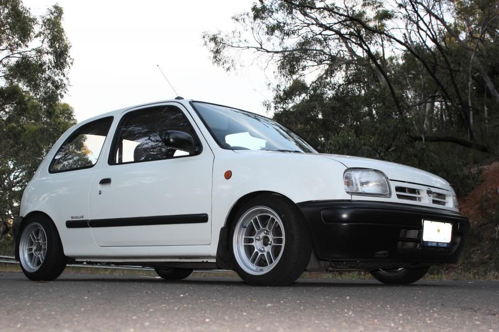

Hi,
CAR: 1995 - Nissan Micra K11 LX model.
I though it would be time to introduce my other ride. The underrated K11. This car is super fun to drive and modified parts are not hard to find. Standard it has a 1.3ltr Twin Cam EFI with crispy cold Aircon. My Modifications are as follows:

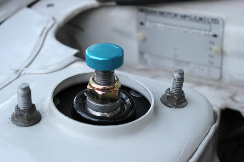

Suspension:
- DD Coilovers - 40 Way Dampening Adjustability. Dual Height Adjustable.
- Whiteline Rear Adjustable Panhard Rod.
- Whiteline Adjustable Front Camber Bolts.
- Whiteline Front Strut Brace.
Brakes:
- N14 Pulsar 1.6Ltr front brake calipers(Professionally reconditioned)
- DBA vented and slotted rotors
- EBC Ultimate Pads (Black)

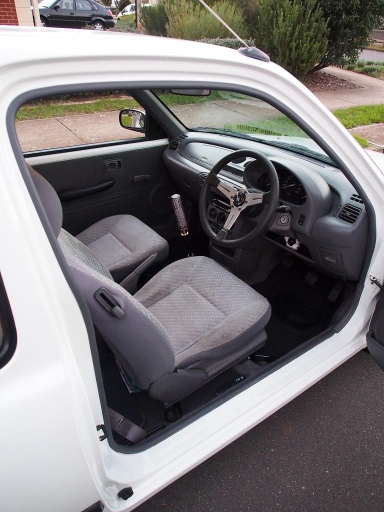

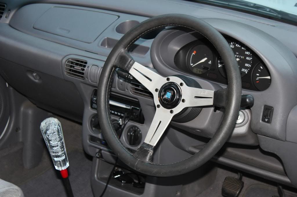

Interior:

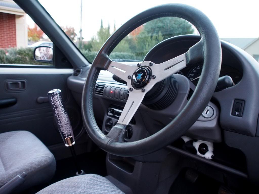

- Nardi Classic Steering Wheel
- 20cm Smoked Dildo
- Japanese delivered Dash Cup Holder and Storage Unit
- Super S Dash
- Custom Black Floor Mats
- Bride Bucket Seat on custom rail

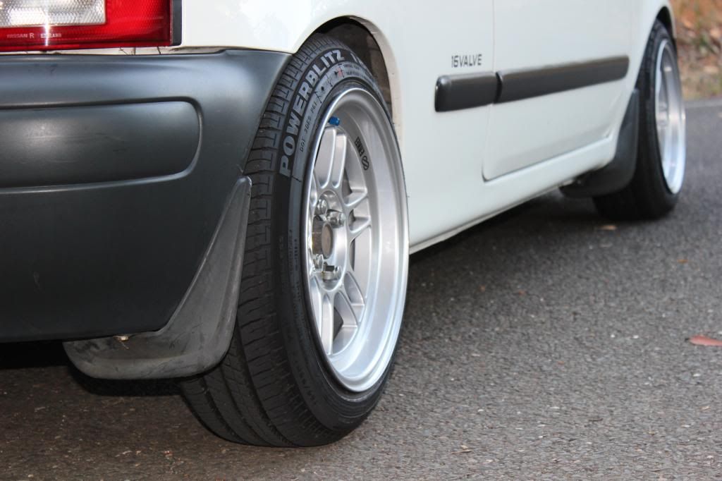

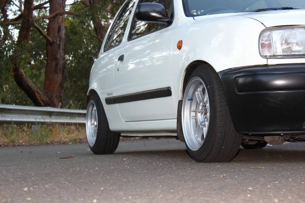

Wheels/Tyres:
- 14x7 +19 Enkei RPF1's. 100PCD and custom machined centre bores to fit micra.
- Stretched Silverstone 165/55 R14's all round.
- Work Grey Wheel Nuts
Exterior:
- Clear Side Indicators
- Custom front lip
- Repainted rear hatch. Rust removed and wiper deleted.
Engine:
- Timing chain, guides, tensioners replaced and all genuine seals used.
- TB resoldered, TPS and ICV calibrated.
- Rocker Cover painted in Wrinkle Black
- Detailed engine bay
Pictures:
Things to Purchase in the future:
- Nismo Front Strut Brace -
- Whiteline Front and Rear Adjustable Sway Bars
- Super S Rear Spoiler
- Super S Front Lip
- Super S Tacho Dash
- Bride Bucket Seat and rail
Hope you like it!!

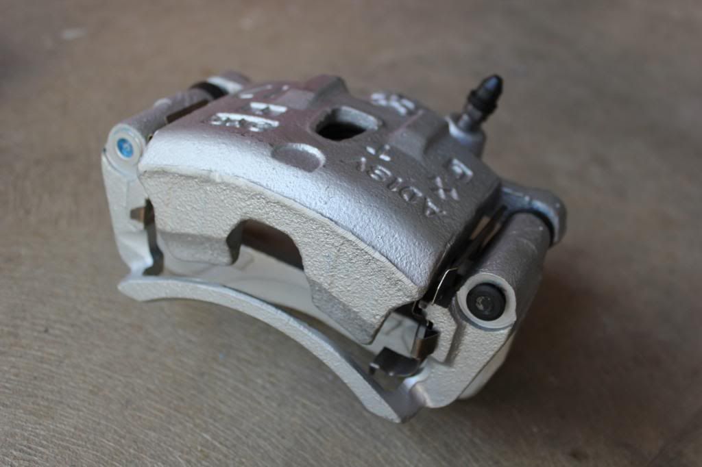

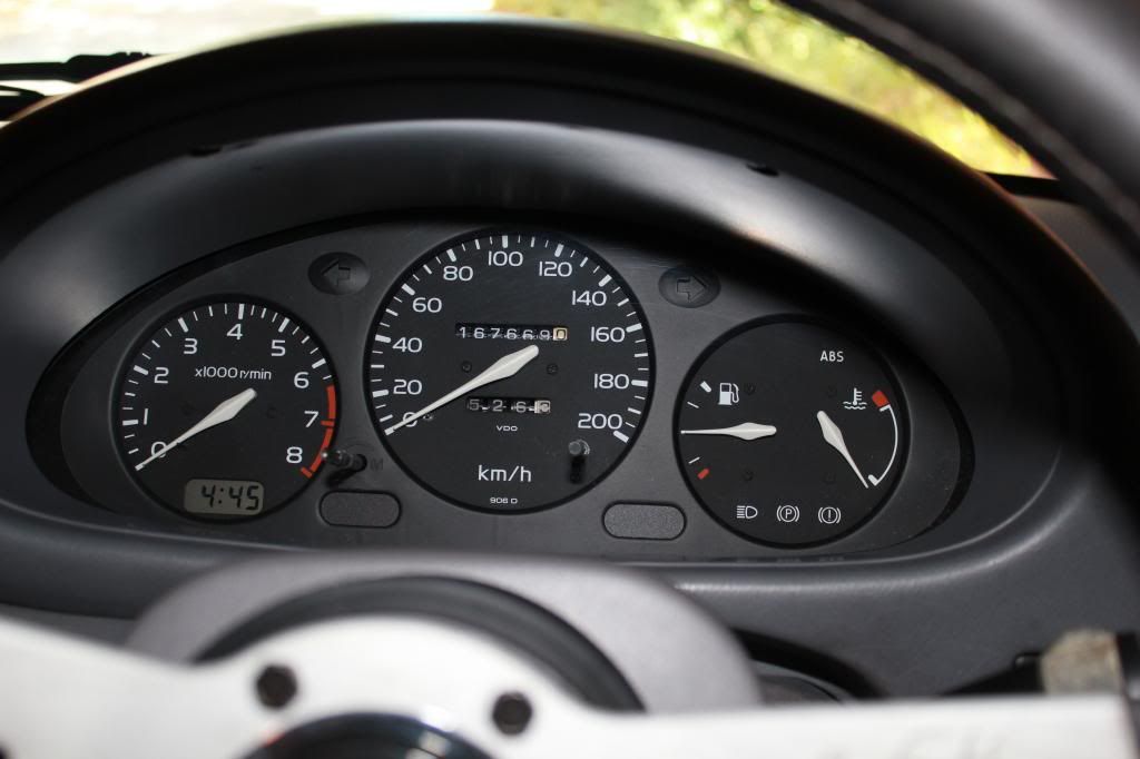

Bit of an update.
I installed a Super S dash cluster. Yes, it is 'plug and play' for my 95 LX. One of the easiest and best upgrades so far.

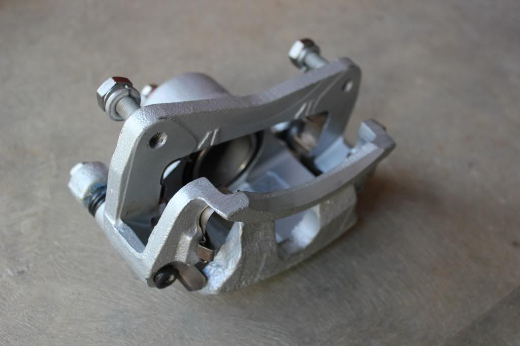

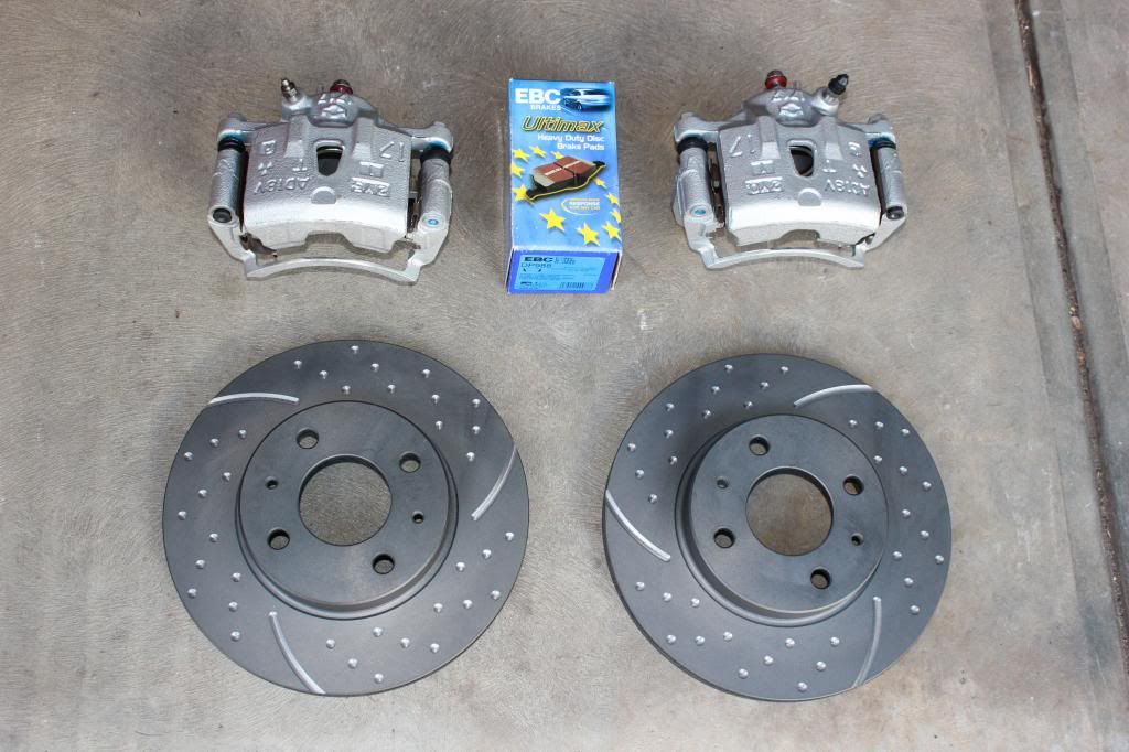

Also went to the local wrecker and picked up some N14 pulsar front brakes for $44 bux a pair. I had them professionally stripped, inspected, cleaned, assembled and painted. Also got new DBA rotors and EBC pads. I cant wait to install everything and test it out. It should make a big difference.
CMF_Geoff W
» CMF Member
Member since:
Posts:
Nice work!! Loving this car. The cluster looks like a great and ultra good condition example worth the money paid for I'm sure.
Speaking from experience this Brake upgrade is more than enough in a NA application.
The only thing I would say be a little careful with is the location of the centre line of the caliper in relation to the centre line of the disc/rotor.
From memory I had some stainless steel (doesnt crush anything like mild steel) washers/shims made up. however the exact measurements had to be determined while fitting. i.e. Fit, measure, organise/source spacers and then Remove/Re-fit, Bleed, accelerate, Stomp :)
CMF_dreny
» CMF Member
Member since:
Posts:
Brakes are installed and look amazing. They are HUGE in comparison to the standard setup. I only used 1 x 0.7mm stainless washer to center the bracket with the rotor.
The caliper is self calibrating as it needs to move as the pads wear out.
I am currently bedding in the brakes for 500km's then i will do a performance test.

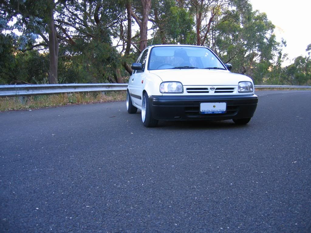

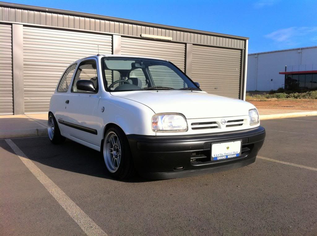

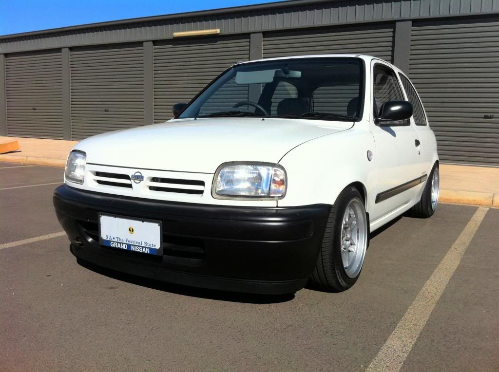

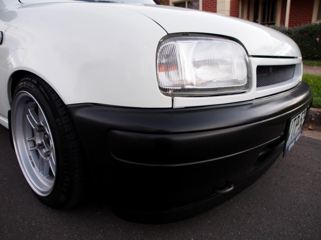

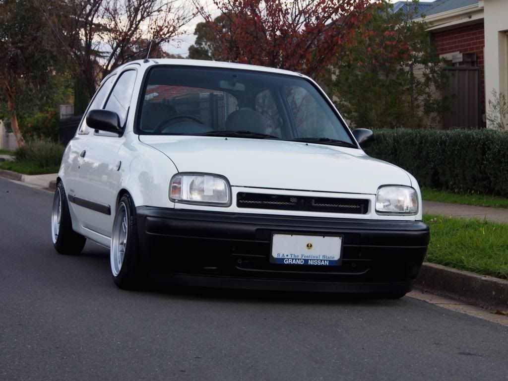

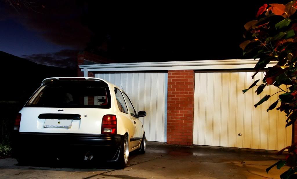

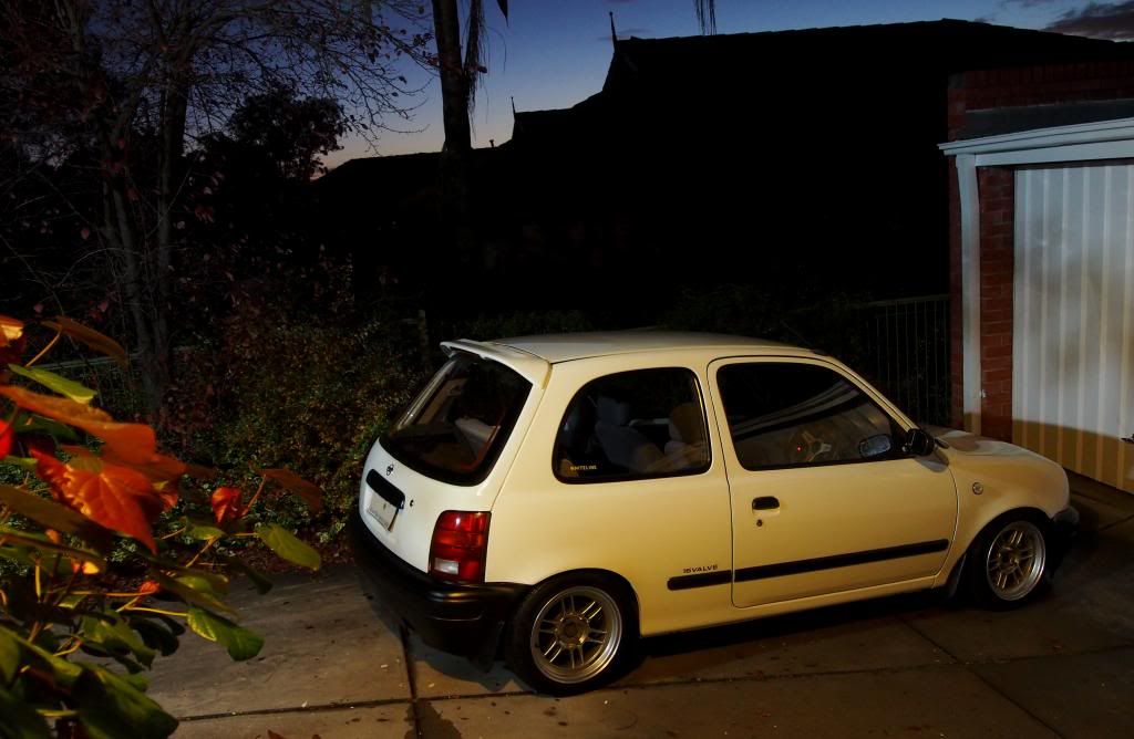

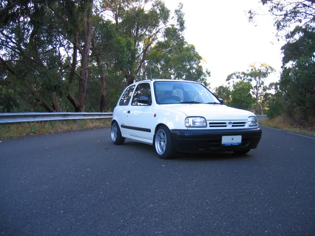

Ok. Here are a few crappy phone pictures.
You can see the new front lip and revised ride height. Also got clear indicators.
I will get some better pictures soon.

Car looks good now it's lowered. You should know that you have a doppelganger in VIC, white LX on 14x7 RPF1s. Only difference is he has a purple front guard.

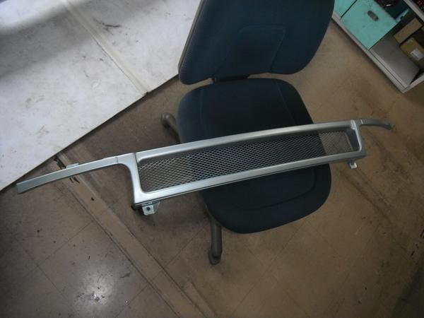

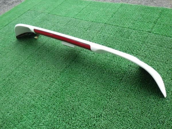

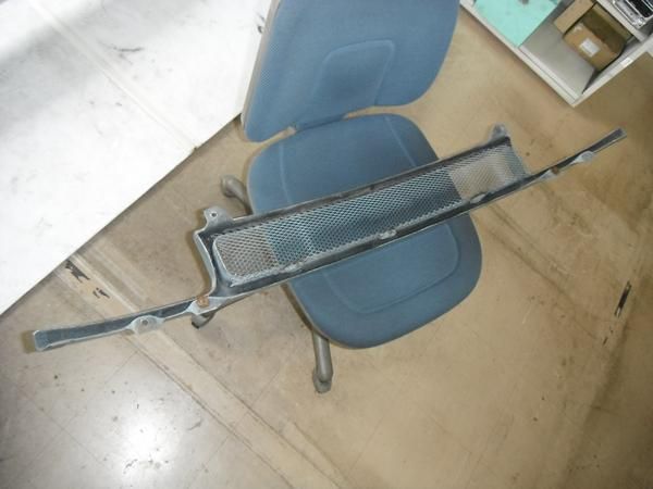

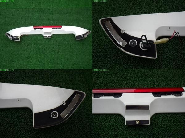

Its been a while since I posted an update. I have installed the new front grill and rear wing that was imported from Japan. The grill had to be resprayed since it was originally grey but luckily the wing color matched perfectly.

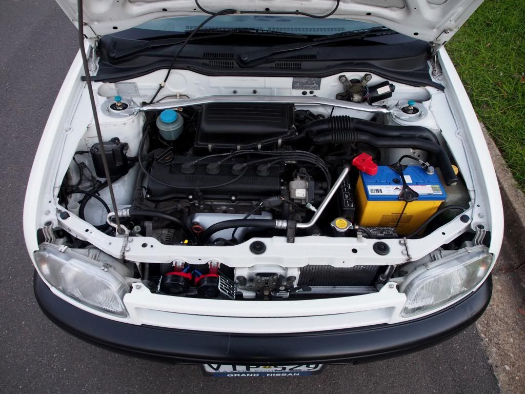

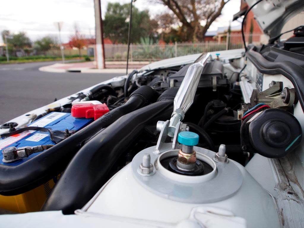

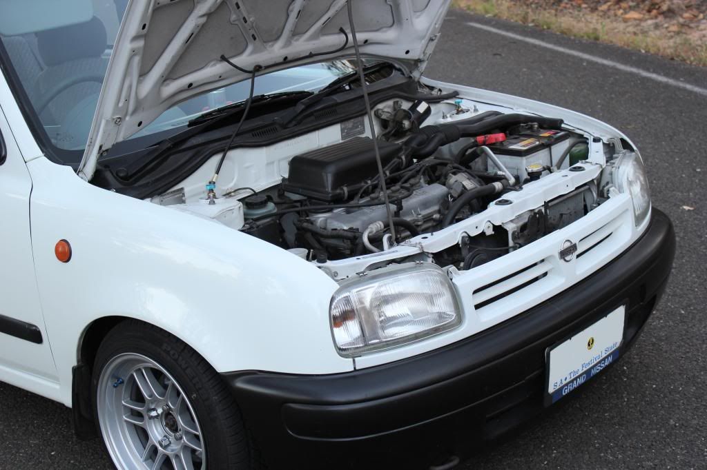

The engine bay has been detailed via respraying the rocker cover in wrinkle paint, painting the exhaust shield in high temperature paint, replacing original bolts with stainless items and giving it a general clean and polish.
I have also purchased new custom floor mats, smokey dildo and front strut brace. Enough talk. More pics.........
