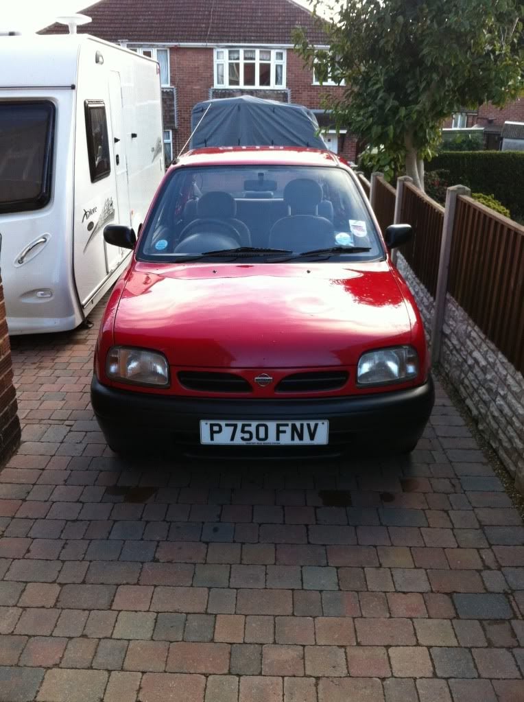

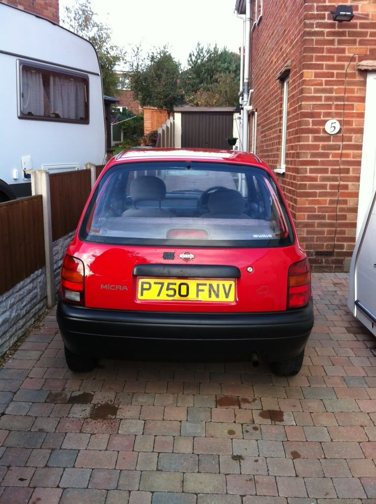

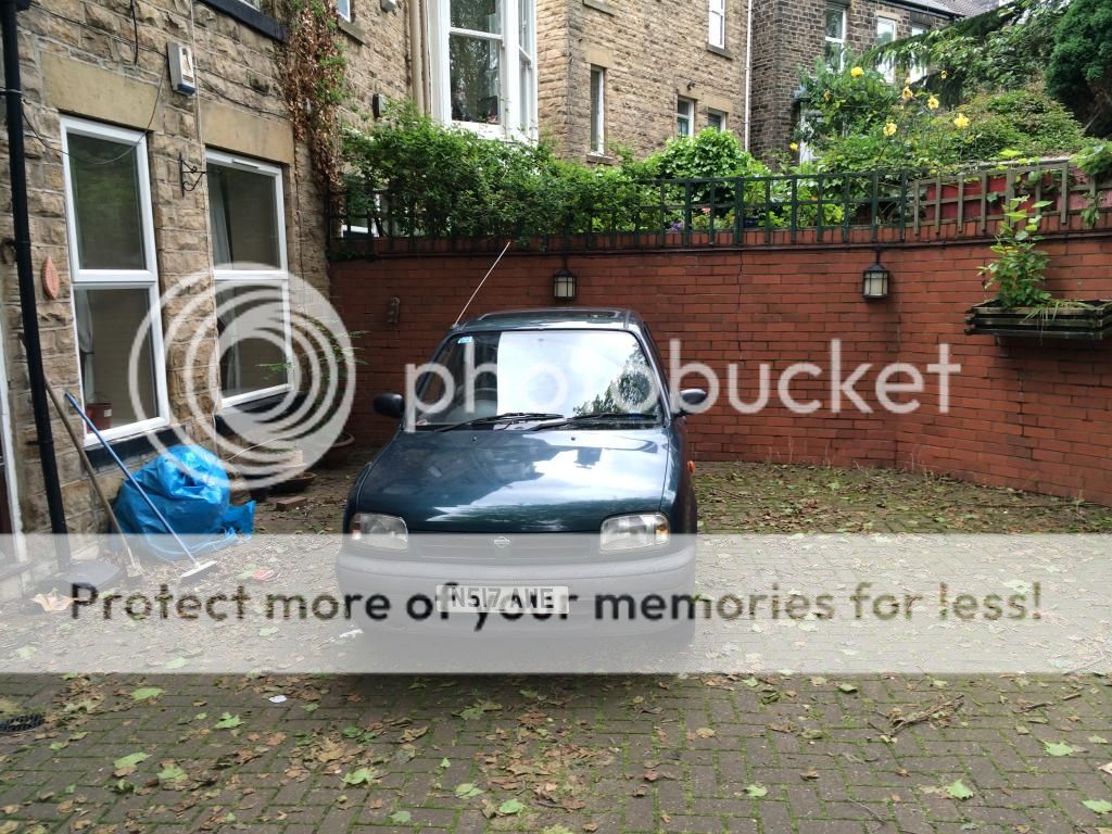

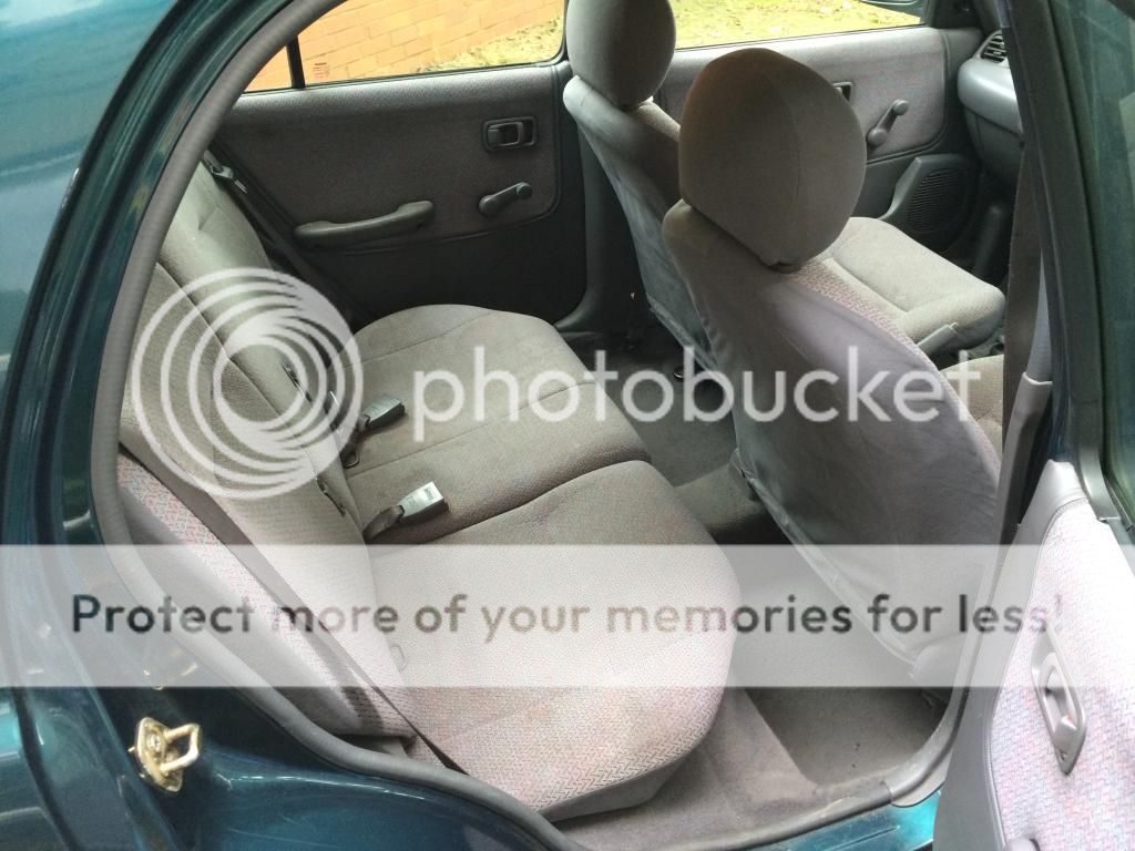

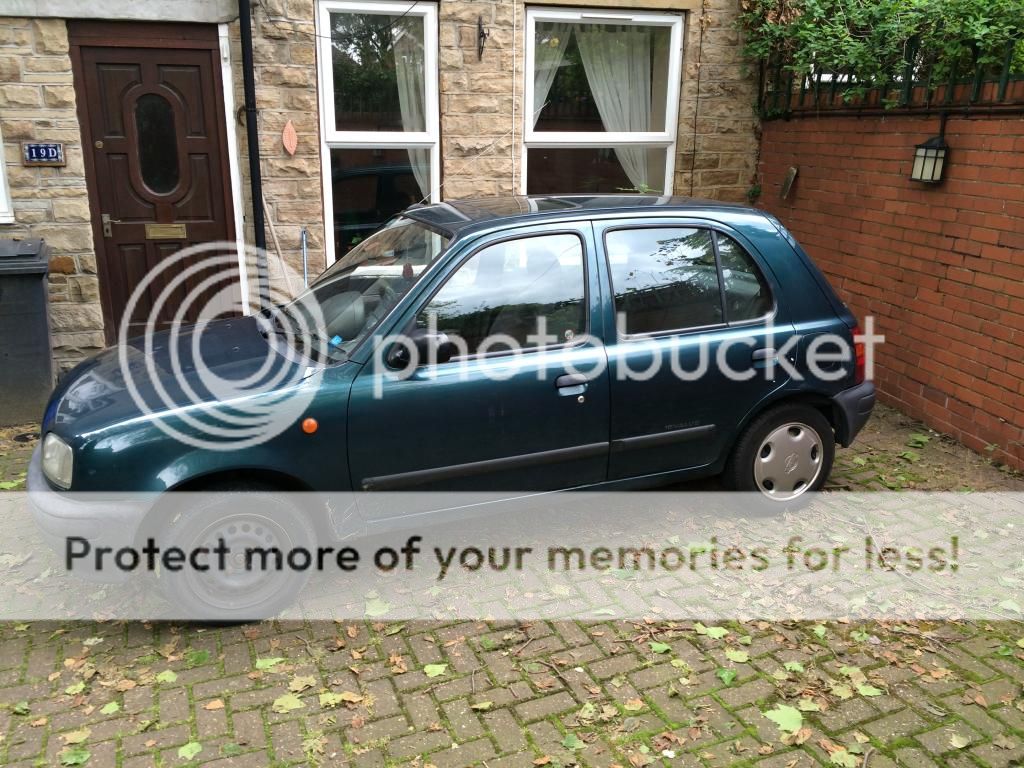

So I picked this up yesterday. 1 months tax and test £200 1.3 LX it goes well mutch better than the 1.0. Needs a good service and welding as they all do. Only to the rear sills as they haven't been touched before and one hell of a good clean and polish. Anyway some photos.
A few areas that need attention. Laquer peel on the n/s rear quarter, dint in boot lip and the usual door handles locks windows etc that need a bit of fettling.

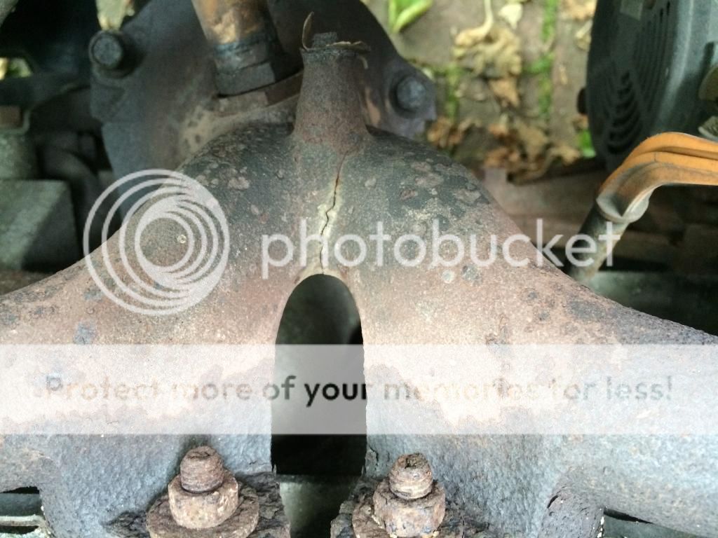

Oh yeah and this.
Lovely cracked manifold.
Plans are to tidy it up get a new ticket and either use and abuse it or move it on. I enjoy working on these little motors and I'm actually looking forward to breaking out the welds stick again.
Fair enough lol.
Really could do with tracking down an exhaust manifold due to the crack in this one. Where's the best place to source one you reckon?
Maybe scrappy's, but I'd consider a 4 branch. I'd have some new studs handy for the ones that snap/wind off because the nuts won't budge :)
Good point. But a 4 branch would cost as much as the car. New studs will be to hand. There are a couple on eBay at the minute. Thought about trying JB weld not sure how it will hold up.
@Azzydot lives near you and has a Tig welder, you could tig that up quite easily i think, might be worth dropping him a pm

Didn't manage to start on the manifold as I didn't have a deep enough 6 sided 12mm socket and want to give the nuts and studs there best chance at coming off.

Small update, today I received a new exhaust manifold for the micra, when we have moved house in a couple of weeks i will get back on with getting this thing MOT'd might just need a few more bit of exhaust, tyres and weld up the sills.
