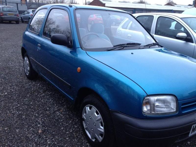

Any how a garage i know had 2 cheap micras, i thought what the hell & had the blue one (seemed the best buy) so he put me 12mth MOT on it its taxed until 1st april, 59k on the clock & is a 1Litre 16v 'Hollywood' it even has a sunroof!
Old guy had it previous for 9 years & the garage had always serviced it. It just needed a really good cleaning up inside & out, i serviced it anyhow oil, oil filter, fuel filter & ngk plugs, cleaned the whole engine bay & dressed it, put 2 new front tyres on, debadged it apart from the 16v on the side. Really happy with it, despite how i thought about the micra, its actually a cracking little motor, really happy with it & its saving me a fortune on fuel! even the wife quite likes running about in it rather than her clio, but that could be because she aint putting fuel in it :suspect:

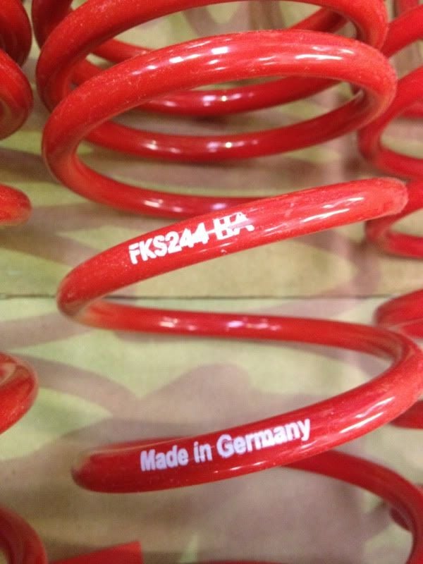

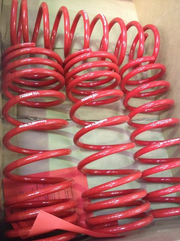

just got hold of some fk automotive springs brand new for £53 delivered (Y), 35mm front drop & 40mm rear drop. Only bought them as thats a bargain, but also i notice when the wind is up the car is all over the place so thought best stiffen the old girl up a bit! might get the fk automotive struts as well (suspension not braces) in the future, just see what the ride is like on the old struts first

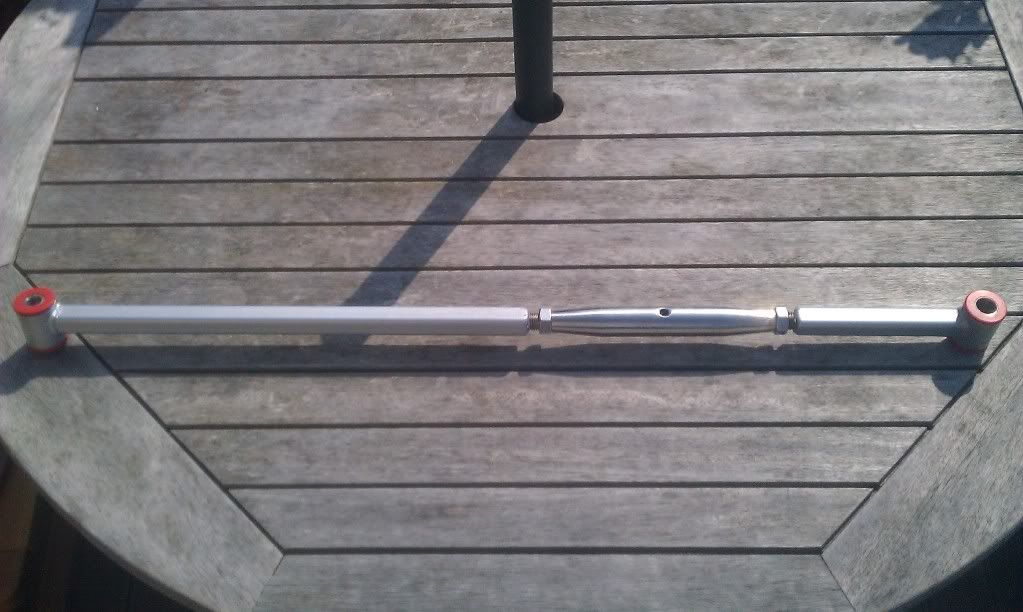

If you want to lower it, get Frank's bushes or a adjustable panhard rod, or you'd have a funny car, though
Frank's wonders:
or Noddie's masterpiece:

Here's a simple illustration to demonstrate the problem with the rear suspension set up that micras have. To prevent the axle being offset too far as in the second picture when the car is lowered, you should get an adjustable length panhard link.
Panhard link (blue) when suspension is fully uncompressed and standard
Panhard link (blue) when suspension is either compressed or (lowered and uncompressed)
As you can see, in the second picture, if you simply put shorted springs in your car without shortening the length of the panhard link, your rear axle offset becomes too great, and the left wheel becomes further in under the guard while the right wheel protrudes further out past the guard.
An adjustable panhard link will enable the axle to have a decent starting offset even while the car is lowered. There's nothing you can do about the axle offset increasing as the suspension is compressed ie when hitting a bump, however if you set the offset up correctly when uncompressed, its not an issue as it doesn't change enough to worry about when hitting bumps etc.
Additionally, from my discussions with Whiteline Automotive after overhauling my suspension, they told me that lowering without an adjustable panhard rod also had a terrible effect on the rear axle toe. This makes perfect sense, as its a multi-link design, when the axle offset changes, so does the rear axle toe. Basically one wheel's toe was almost straight while the other had massive toe-out (terrible for handling and tyre wear).

You choose which option is the best for you price wise.
Adjustable rod is to choose if you're going low-low-low.
With the springs that you have now, Frankspeed bushes as I called them would be fine. And it's easy to fit. Just make sure you fit the bushes as it's on the picture

*springs are out for delivery today (friday) got from FK Automotive Germany to me in 2 days so not bad for £10 delivery!

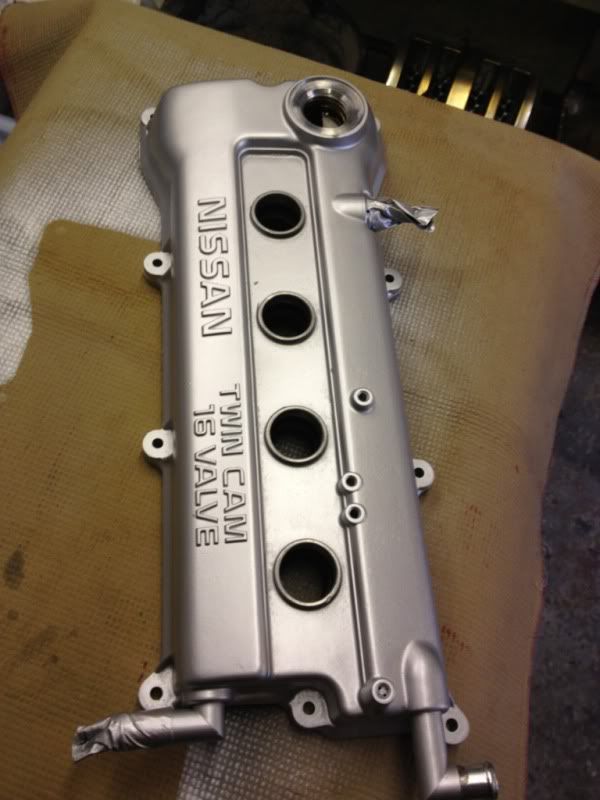

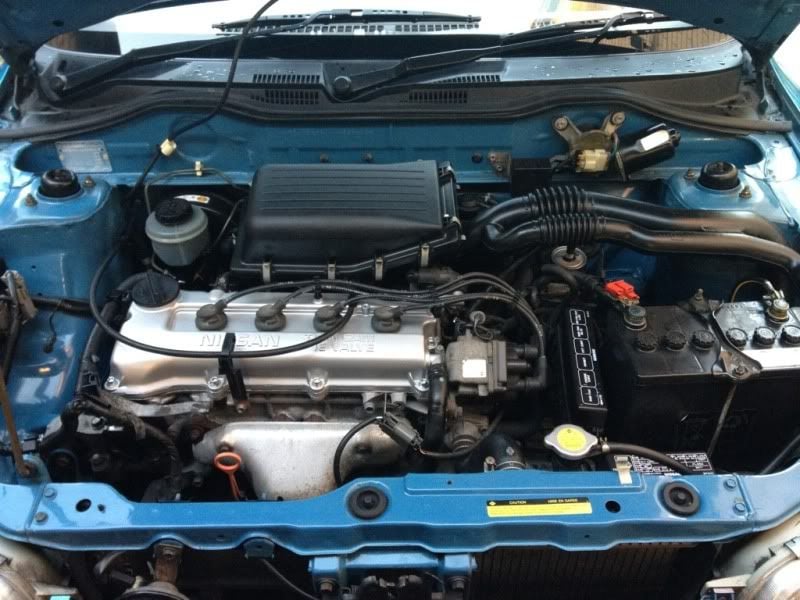

*took delivery of a new rocker gasket (only renewing as im taking the cover off to clean & spray)
*some new allen key head s/steel bolts to replace the rocker cover old fixings.
*got some silver engine enamel spray for the rocker & heat shield

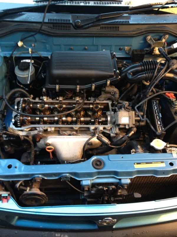

Rocker off
Sprayed up
Re fitted

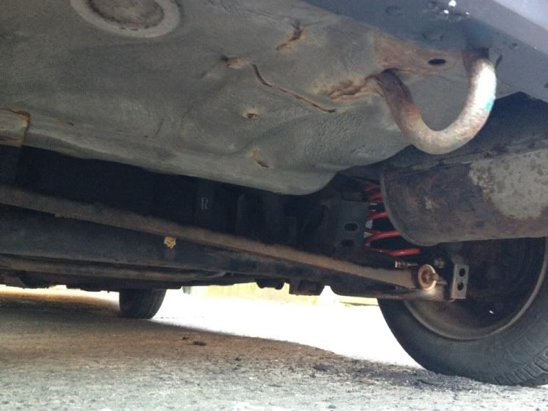

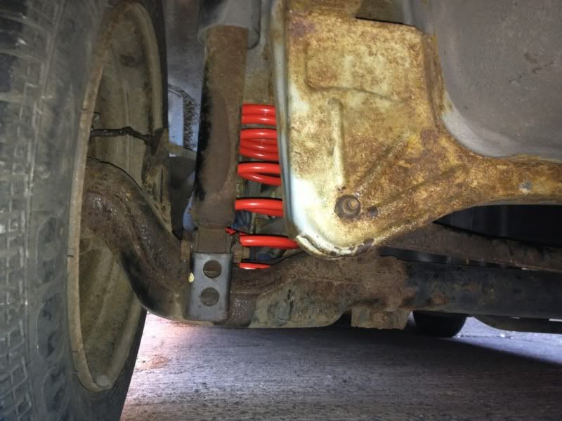

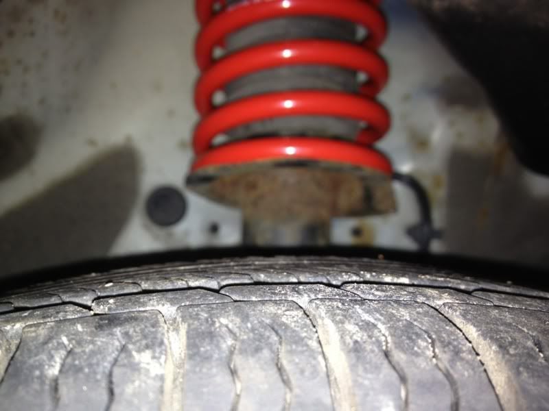

Springs fitted
Frank bushes fitted on panhard rod(Y)

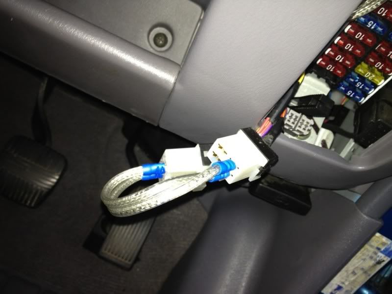

Next was light dimdip mod that was advised to me as the I did not know why I had a weird yellow background colour to my new led side lights

Had real trouble getting the old bush off the threaded bar bit that franks bush goes on, took some persuading to come off, but got there in the end.
Over all after a quick drive round, it feels so much more planted and newer to drive, still comfy an no banging around, really happy!
Cheers guys, just never had a car thats been a real pain to change the rear springs, basically never had a car with a panhard rod thing an that bush removal took ages grr, but it's been worth it. Not a bad days job freezing me backside off :laugh:

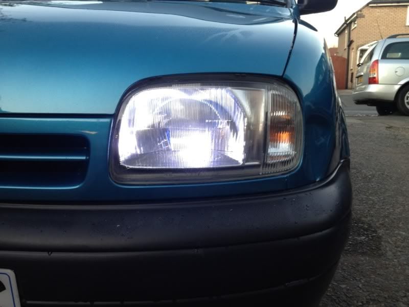

also ordered some silvertec front chrome looking signals to de tango the headlights and also ordered some clear side repeaters!

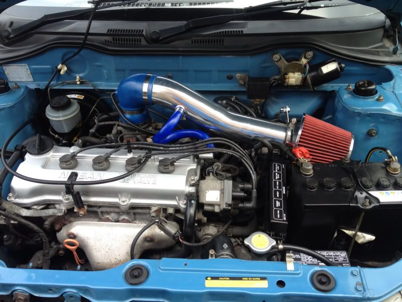

Well managed to get some time spare an fitted the induction kit, have to say its a bargain an has a nice roar on full boot!
Also fiited clear side repeaters and the silvertec bulbs in the headlights so no more oringiness in there! Forgot to take a pic though!
