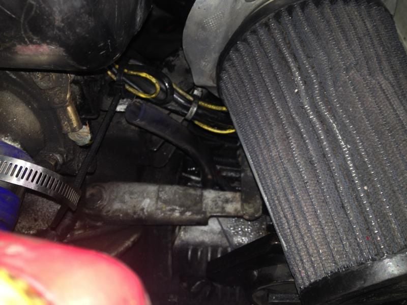

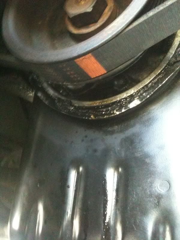

well i have had another look this morning, and caught the blighter dripping. See below picture.
Seems a dodgy repair job on the sump gasket to me :D But there does apper to bit of wetting further up the block by Water pump.
i would give it a good wipe and doublecheck MM
the sump has a halfmoon rubber seal each end and sealer only, and is a bit of a mission so try some sealer over the leak maybe ? (if its not the crankseal)
and that looks like the camcover gasket (coilpack/post 2000 ones are different, as are jdm plastic camcover ones)

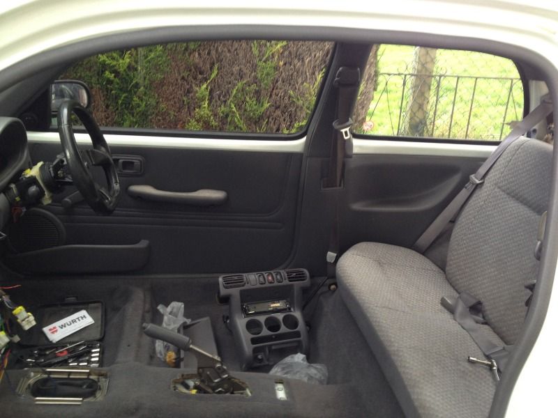

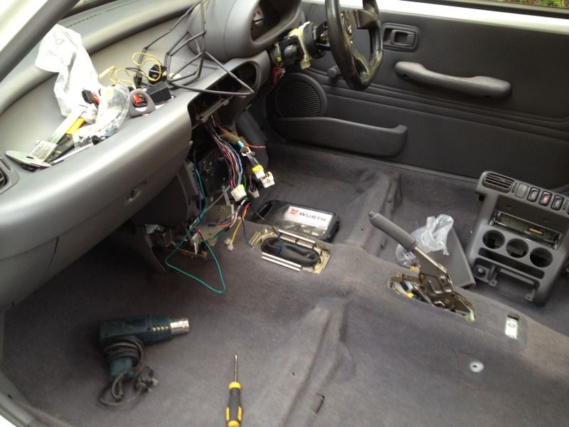

Well the transformation has begun, interior stripped completely, old loom out, putting in new one. 255lph fuel pump in... Not a spot of rust on the floor pan, all good :) Might do some pics at some point ;)
Sent from my GT-I9505 using Tapatalk
Engine mostly disconnected, old interior loom is gone, old engine bay one is almost out, new interior one is in, waiting for new engine bay loom to go in before replacing dash. Slow work, lots of questions asked lol. Lifting strap arived today so tomorrow I should have an empty canvas to start with :) difficult not to get bogged down with small issues tho :)
Old engine mounts are out, gearbox tunnel made, need new engine mounts making up, little bit of material removal and engine back in. :)

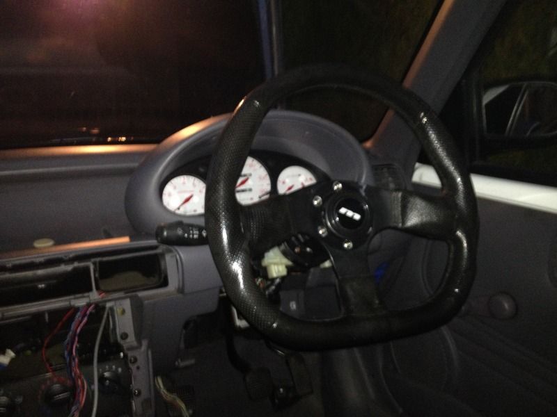

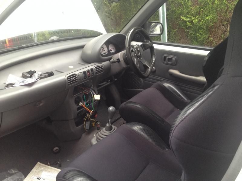

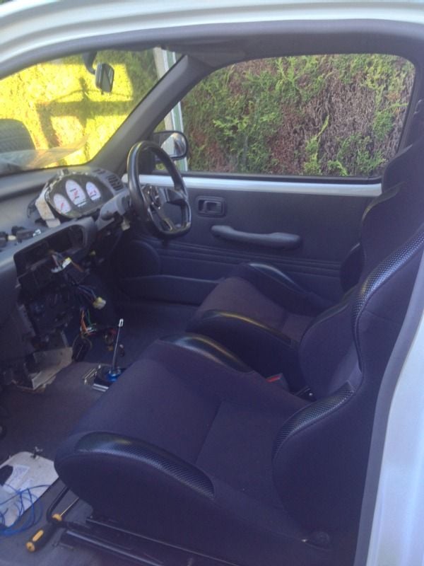

Interior is back in, looking sexy with nismo dials and flat bottomed wheel :) Still holding out on the pics, want it running first.

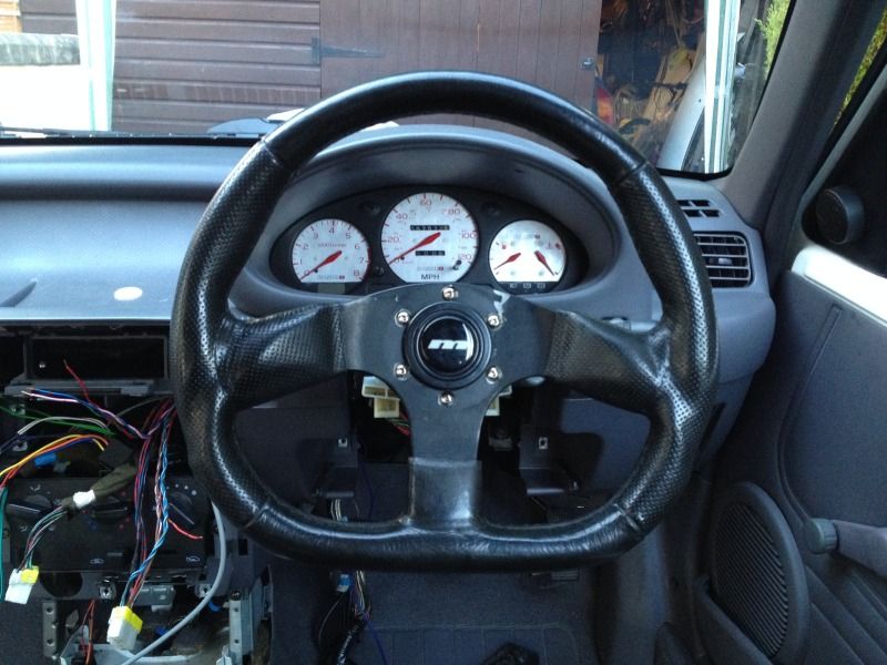

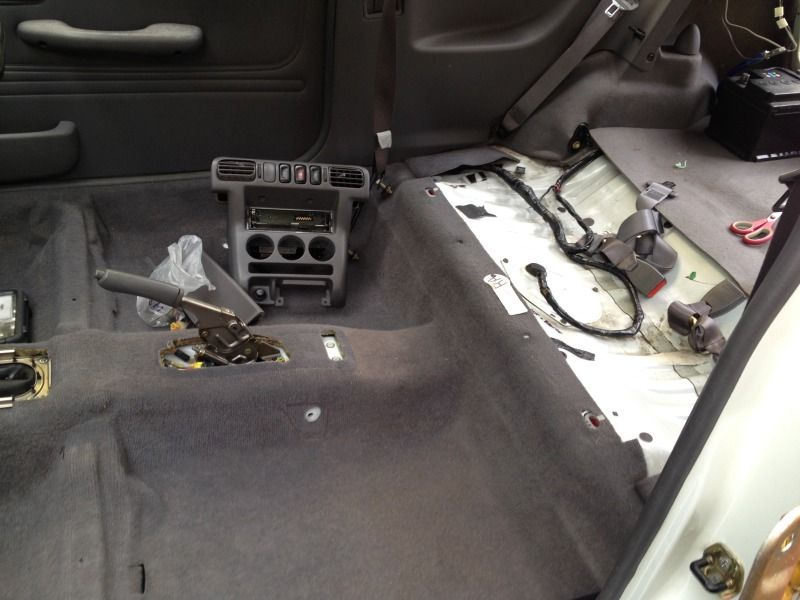

full x3 re-loom, walbro 255lph pump, battery location. Dials, steering wheel as the car goes back together.... skipping a fair bit, but you don't need to know the "ins and outs".
took about a week or so to ensure all the electrics etc were working, needed a few bits like primera hazards switch, rear demist switch, 4 point selection wiper stalk, I only had off, on and fast no intermittent.

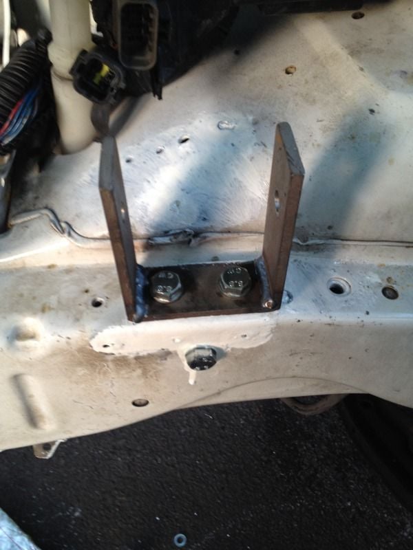

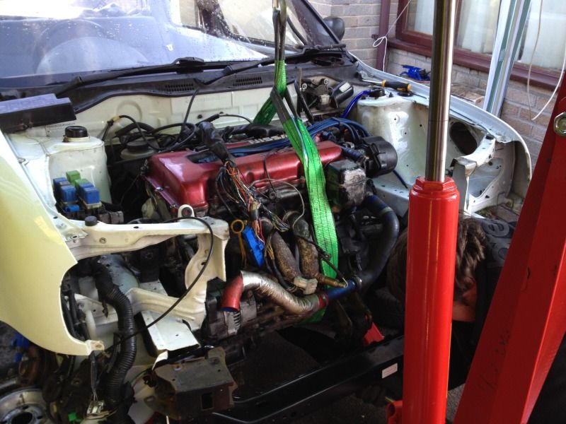

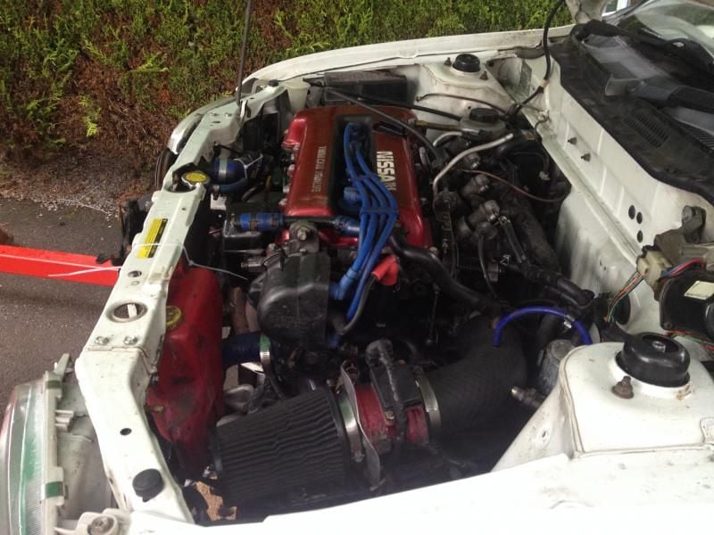

Engine out and in with the new in under a day... found that I needed a new front cross member, so a day of drilling welds proceeded..... much fun
Back out and back in again the following weekend to fit mounts.
Fitted
Decided I needed was to do a proper job on the tunnel, so out the engine came.... do it once, do it right..
Tunnel Mod for gearbox clearance, welded, filled under sealed. Brakes were binding, washers required :D

School boy error on earthing saw me taken out the rear bench again to check the loom where I had spliced... hazards on saw me with the rear wiper going, pulled the connection to the wiper, hazards changed from indicators to brake lights and rear number plate bulbs....

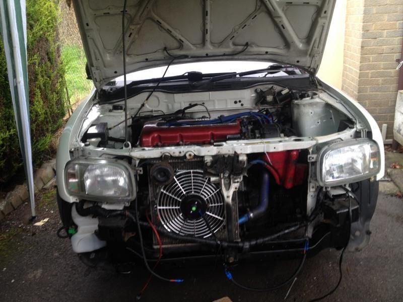

First fire, couldn't get it to idle for abit, needed a slight tweak of the throttle cable, me dad rocked up just at the right time, so he could hold the revs and I could adjust the cable position.
Better than nothing... it had a rattle as you can hear from the second vid, I was worried it was chain death rattle, turned out to be a loose alternator :D All good.

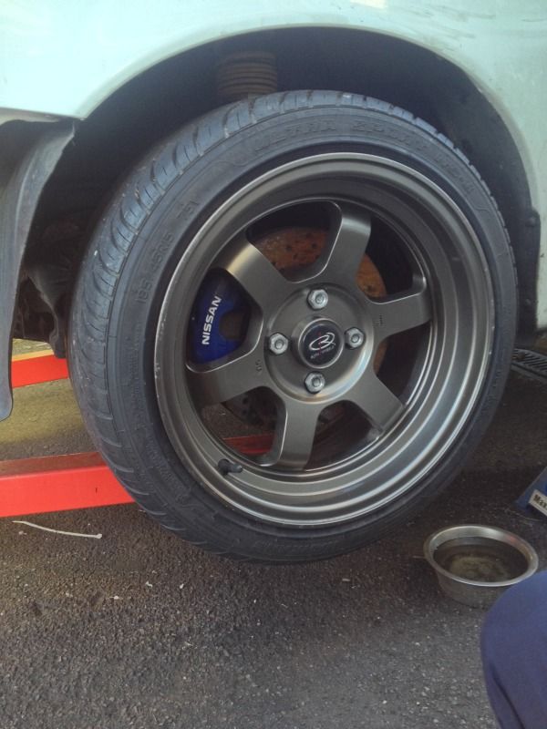

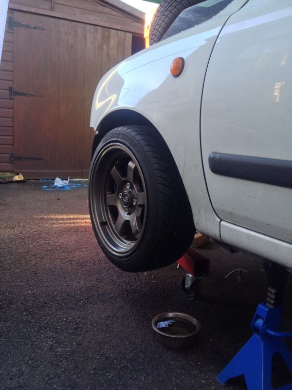

Final rim choice...
cant wait to get it on the floor to see how she looks :D Got some Neo-Chrome wheel bolts to go on, currently I am touching up these wheels, as the numpty shipped them with nothing between the rims.... so I had minor curb scrape on the one, and impact damage on the rest where they were rim to rim in transit... oooh err Mrs.

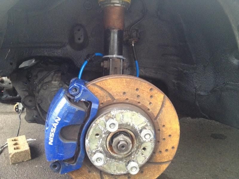

Brake lines on

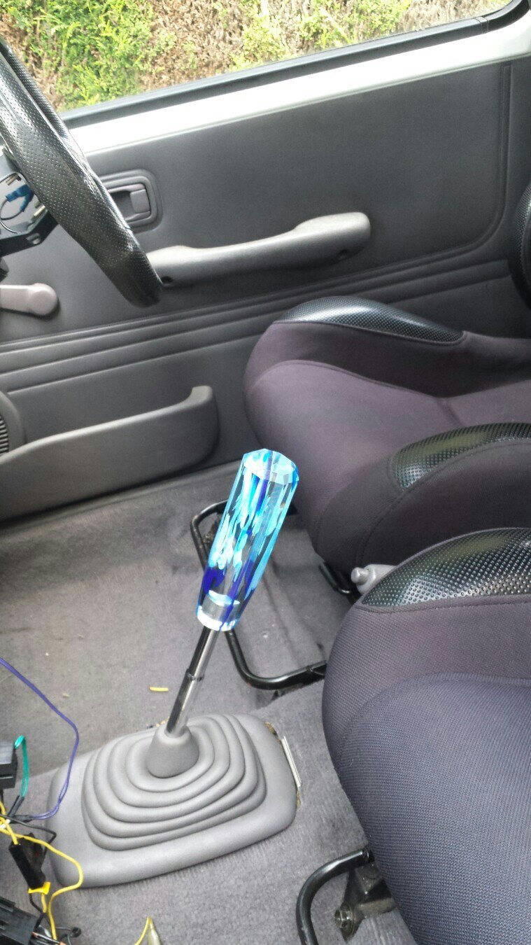

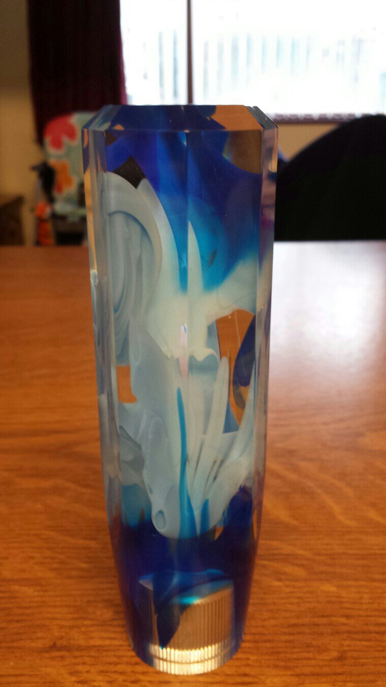

Long arm required for the gear change...
Love it. ... I know what you mean about the shifter... I have a 3" extension on mine.

Front wishbone did the same, driverside shouldnt be to tricky. Passenger is going to be a right bitch, im guessing the bush has corroded to the bolt...
Heat, wd40 and a 2 1/4lb lump hammer didn't move my passenger side bolt... did a good job moving the mount forward a good 5mm or so though haha
