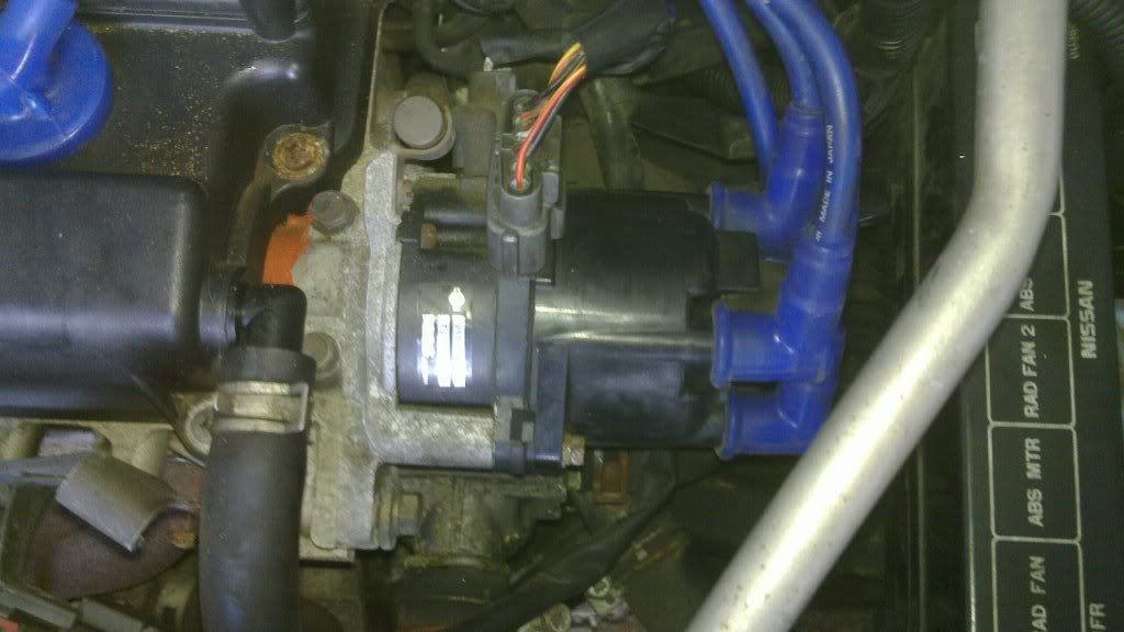

my dizzy looks like this :( my mums march uses ″normal″ dizzy. Any idea what I got?
only has two bolts. looks like this one
Ok, used the partnumber on the dizzy which got me here (http://nissan.epc-data.com). Found out its mitsubishi dizzy and was used on marches between 95-97. Got the right partnumbers on of the site, phoned local dealer and the cap and rotor arm are on its way from japan. Gonna be here on the 5.12. Payed 25 quid, not bad for main dealer prices. Even if it doesnt solve the problem theres no harm changing it. will keep you posted.
