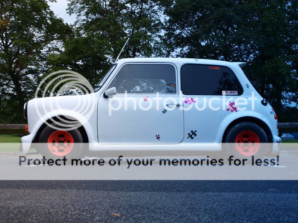

Well, this is my baby. MinBin - a stage 3 998 that may have gone pop on the M6.
Prior to this incident he looked pretty damn good - but I am going to make some changes while an engine rebuild is underway.
Specs:
Out:
Fully deseamed shell
Sports pack arches and skirts
Zeemax rep bumpers
Fibreglass bonnet with unneeded bulge and handy bonnet pins
Crystal headlights
MK1 Grille no surround
BMW Mini R56 Spoiler (that the breakers said would never fit so knocked a few quid off)
8" cherrybomb with heart shaped tailpiece
Frenched rear lights
10x7" weller 4 spokes and lovely Falken tyres
In:
Suzuki baleno seats (the fake bucket sort)
TRS 4 point harnesses (bright orange)
Fibreglass dash
KOSO bike speedo (in the centre where it should be)
Sound system missing at present as I sold it
C pillar harness bar
Under:
Drums all around (front disc conversion waiting)
Goodridge hoses (in lovely orange to match the subframes)

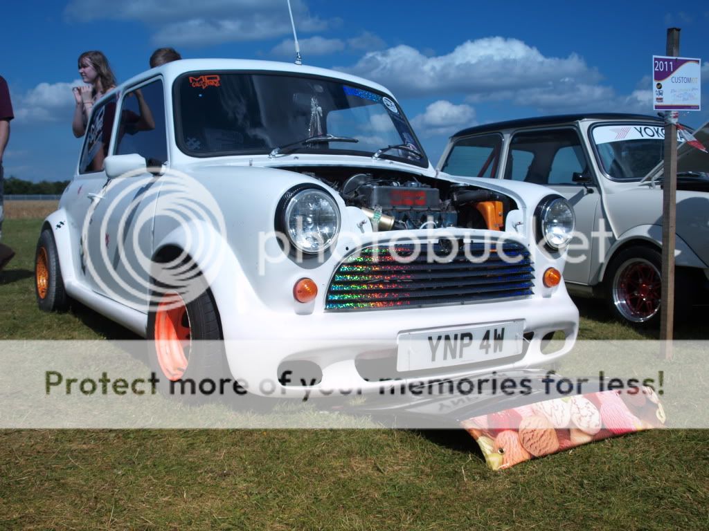

Stage 3 head
Hi lift cam
4 core rad
Corsa B heater matrix behind grille
Pipercross filter
Custom profiled needle and slightly worked carb (single SU)
Uprated mani's
Uprated steadies
Polybushed and stainless steel every fitting I could
its minus the front bumper and stickers atm, ripped them off lol
Going to rework the bumpers a bit, more race inspired. The micra is my practical every day car, so this is just going to be pure fun. And MORE LOWS! Everyone loves lows :D
