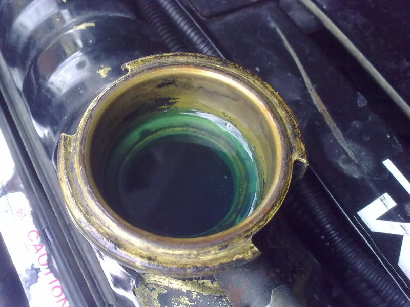

Right Had the st on track yesterday from 12 to about 3pm and about 40 mins on that was changing pads ( due to the heat ). but I did 10 hard laps toward the end of the day and was keeping an eye on water temp all day(because i just changed the waterpump) was running about 95 degrees all day but this time it was at 100 degrees so i pulled in and drove around the paddock slowly to cool the brakes.
Within a min or two it it dropped down to 90degrees so I stopped ,pulled the bonnet and the expansion bottle was 3/4 full, so I locked up the car and went to spectate came back and the levelin tank was back to normal.
Took off the rad cap and there was loads of green Gack floating on top of the coolant.It Has'nt lost any coolant and was fine on the drive home from the track
Anyone shed any light on this?
I just had a little search online and the only thing i can find/think of is boiled coolant/antifreeze, probably wrong though :p

have ya changed the thermostat ....may be just abit of contamination from the sealer ya put on the new pump...try a coolent flush and see how things go..

Going to do a coolant flush now but the standard radiator obviously aint doing its job anymore. . . . . .Andy new a thermostat went in two months ago,you could be right about the sealer although I didnt excessively use it
I wouldn't be worried, even 100 is nothing like too hot. I've run cars up to 120o and they have survived. And the only think to watch out for in coolant is the oily stuff, gunk of other types is almost impossible to flush out entirely so there is often something or other floating around in there.
I did the coolant flush by takin the rad out pressurizing it with a garden hose and loads of gack came out of it.What ever it was it the coolant sank to the bottom of the container i put it in so it wasnt oil.Also took out the thermostat and flushed out the engine put everything back and seems to be fine

i know very lttile about coolant etc but it to me it looks like the coolant may have boiled a little? and formed this stuff, did you use the same type of coolant as before the pump went? and in what concentration
Yeah man I reckon thats what happened. I usually put the halfords coolant mix in and a bottle of redline water wetter but I used carplan cheap blue coolant this time. Also I usually have the heating on full while out on track but I was far to hot in the car on friday so i left it off so that could have eee the reason also.
