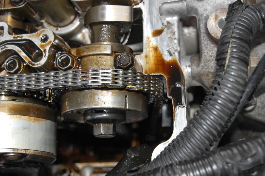

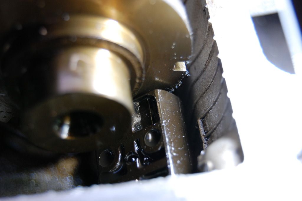

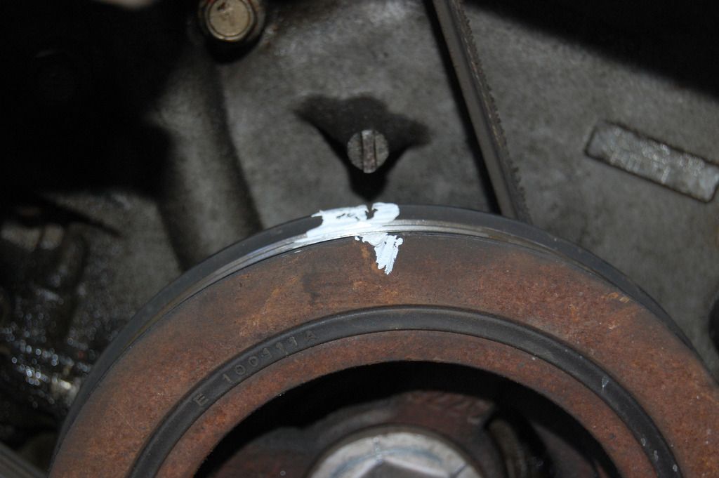

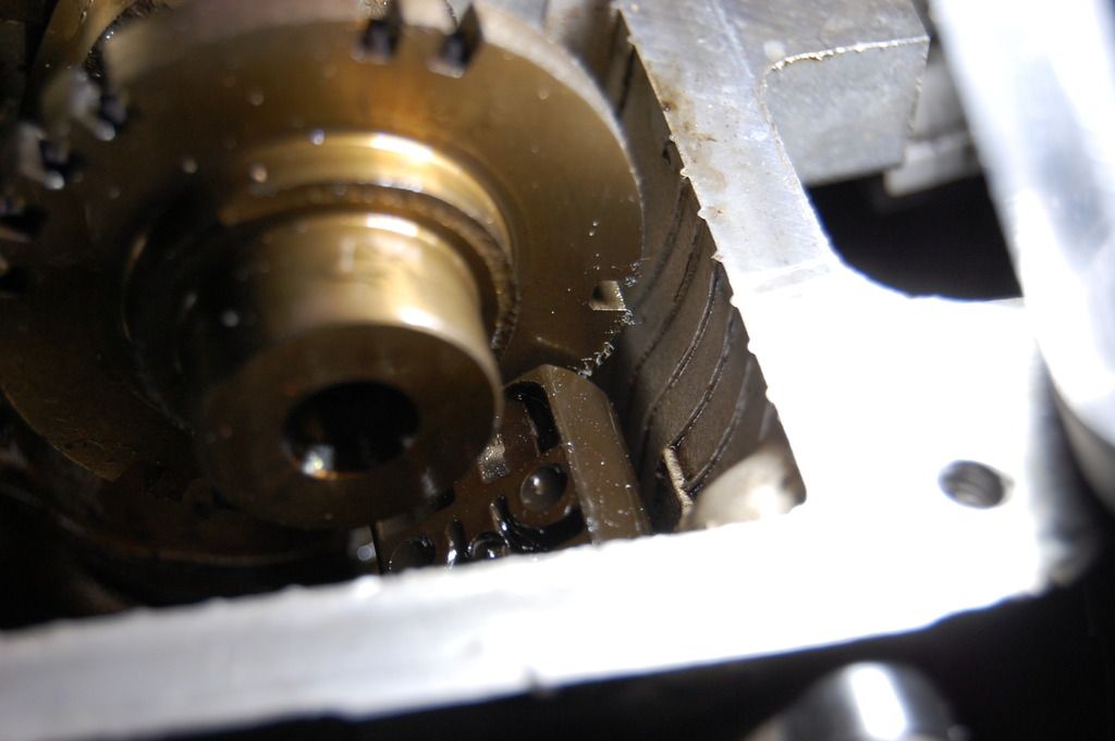

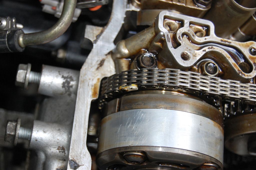

ive gotten around to having a check on the micras chain and timing bringing no1 up on compression.With the two orange marks visible and the crank tdc mark aligned.The exhaust sprocket lines up but the intake is one tooth off shown in the pictures,the vvt is in the retarded position
I came across this link http://www.euretechblog.ie/2015/11/permanently-lit-nissan-micra-engine_13.html checking chain stretch which comes back as 70.3 mm saying its alright yet the tensioner plunger is out at 20mm.
Sorry for hijacking the thread , Frank can you check tensioner pad protrusion by just removing the rocker cover on the k12?
