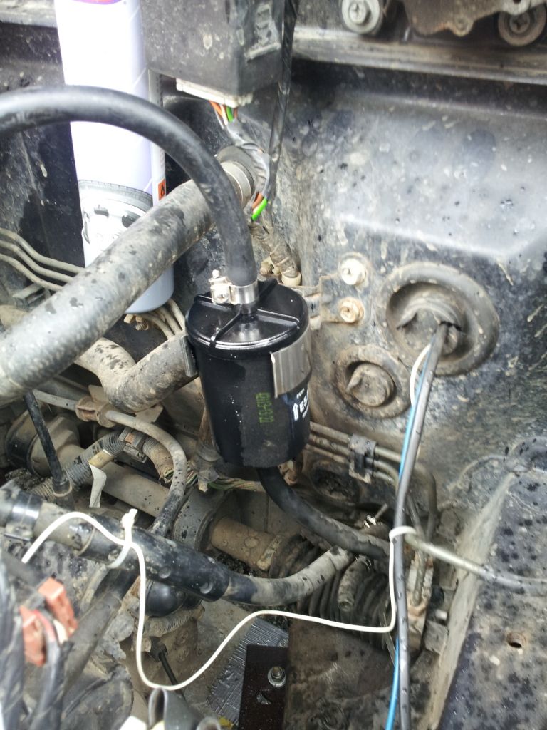

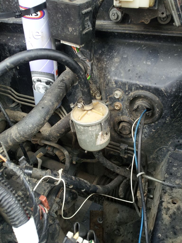

Off to the engine bay to remove the old one. In my case it was a simple matter of two Phillips screws. Remove the top one first. ONLY DO THIS WITH A COLD ENGINE Give the rubber hose a twist with pliers before pulling off the rubber hose. This is where your hands first get wet with petrol - wear rubber gloves and put your fag out before opening up the fuel system. My engine hadn't run for a day so there wasn't much residual pressure in there. Next remove the bottom hose and get ready because this is the time you lose a filter full of fuel. Quickly put your finger over the bottom of the filter and retire to a safe place to empty it - Don't lay it on the ground somewhere and play a game of throwing lit matches at it.

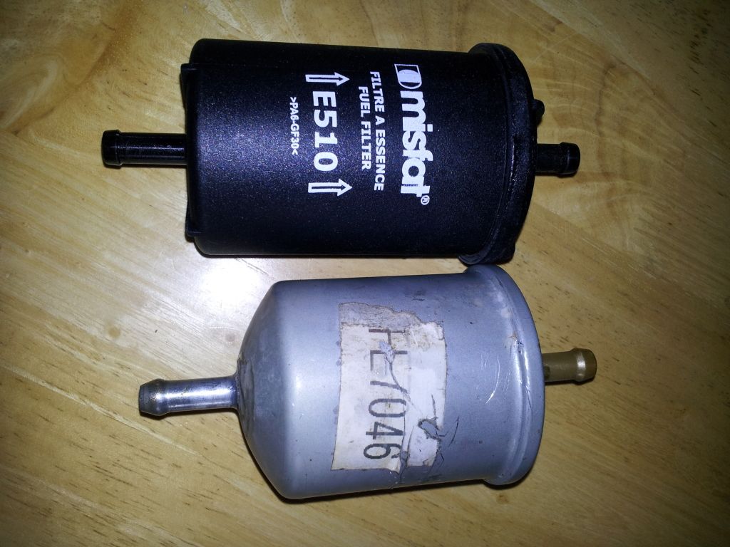

The old and the new -
How does it go? Replacement is a reversal of removal.
