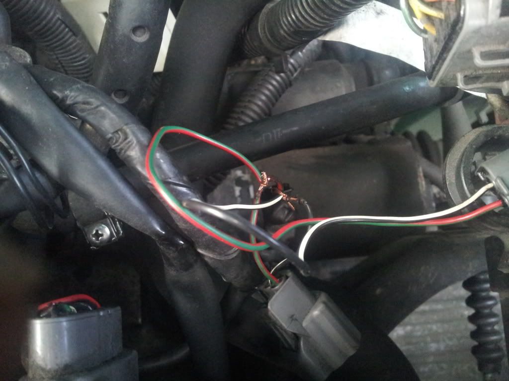

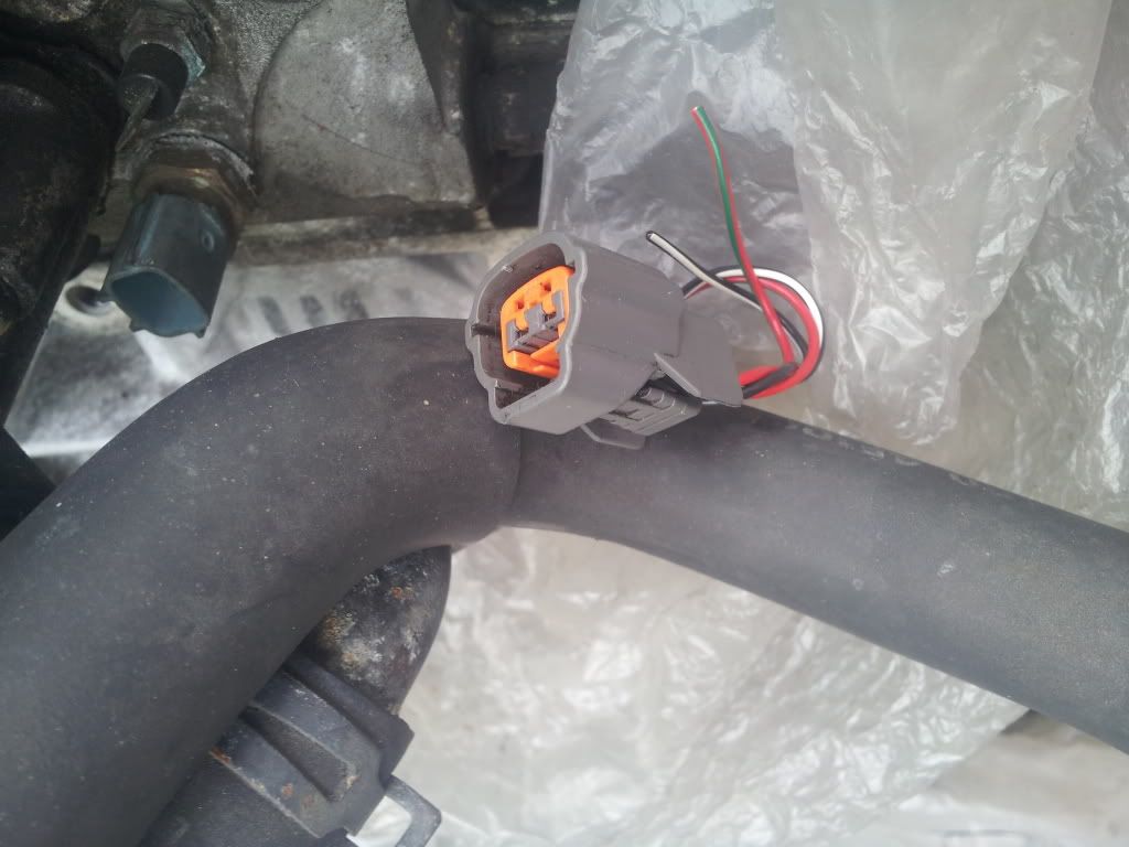

I found an 15kOhm resistor (like was mentioned before, only the link doesn't work anymore :( ) and I connected it in parallel to the big temp sensor.
I started the car, but I didn't noticed much difference. But we will see in the future. I hope it will work thanks guys.

before any modding I usually first test & diagnose if the sensor is operating properly within the original spec tolerances.
simply remove the 2-pin ECU coolant sensor, check resistances whilst submerged in a tub of boiled water with thermometer and plot if its Ohms/DegC is close to this graph

Thanks for your respond!
About the temp sensor: It isn't easy to remove it! I measured the value when it was installed.
Without the extra resistor it was 0.85kOhm and with the resistor it was 0.9kOhm
If there is no difference I'l try to remove it and compare it to your sheet, thanks for the documentation!

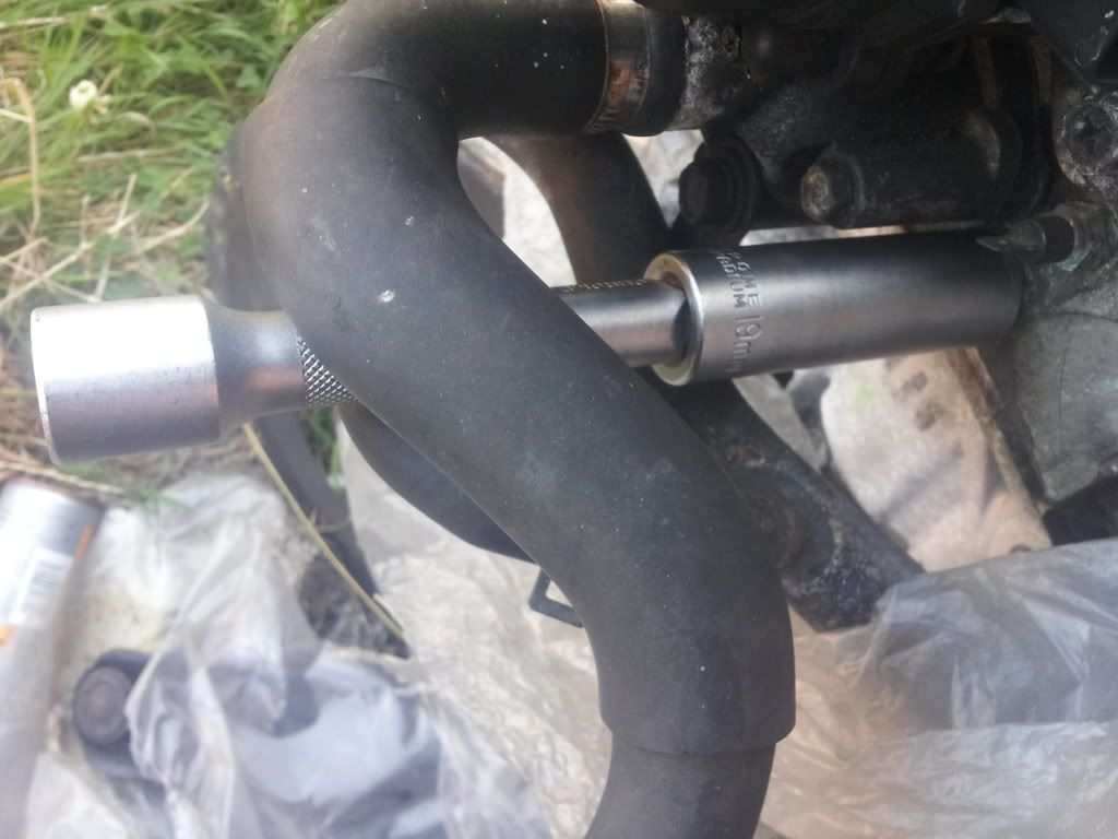

the temp sensor is sooo easy to remove. just drain the coolant out, deep 6 sided socket & extension on the sensor and unscrew

Anyhow, I'm going to check the valve/idle waxtat tonight. The sensor is much harder for me then for you because I have a LHD car and there is very little room!
