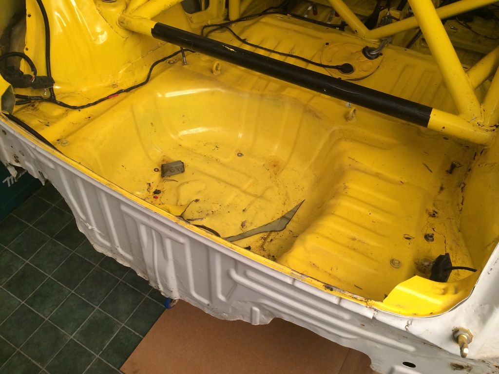

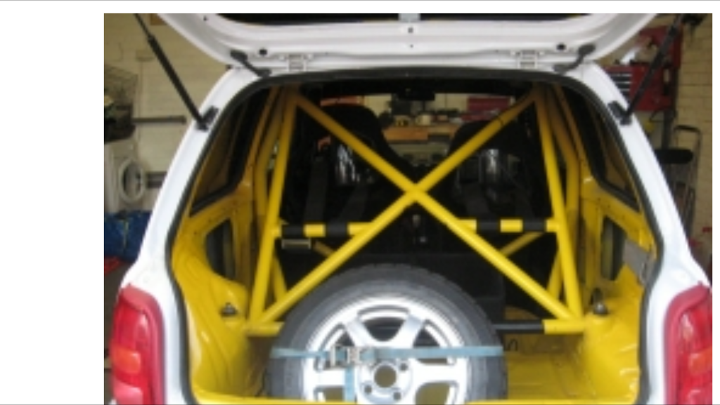

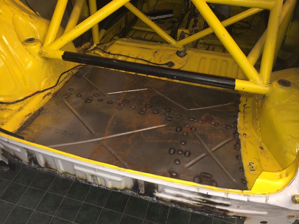

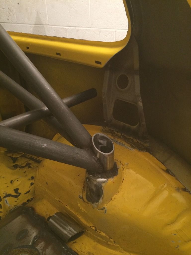

i wasn't that happy with running the spare wheel so far back as the rear strut brace of the cage is far to low
so i changed it

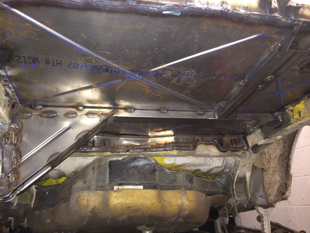

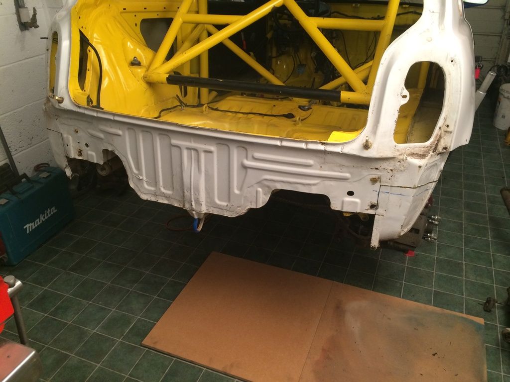

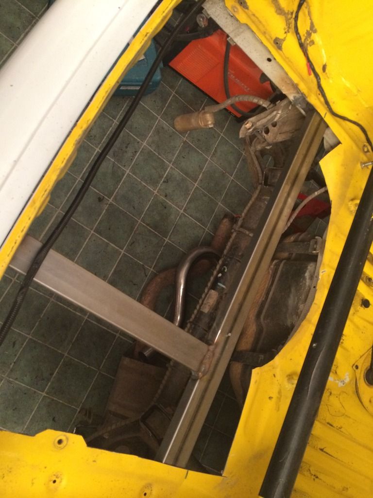

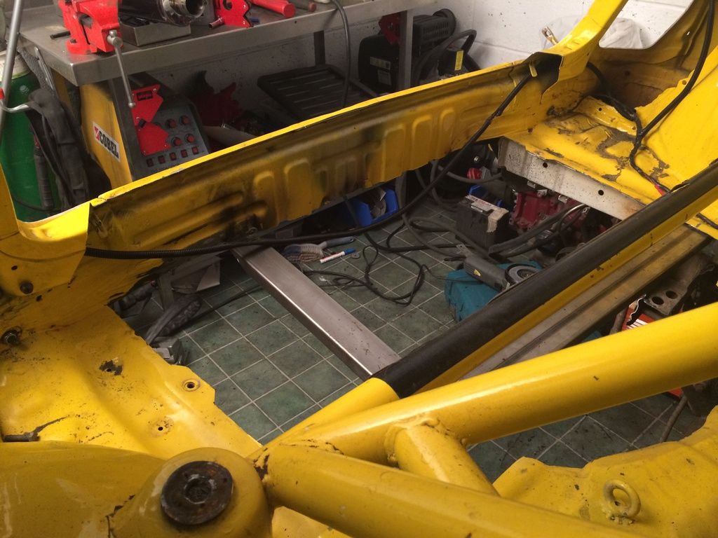

also sorted the rear spare wheel well to remove a bit of weight

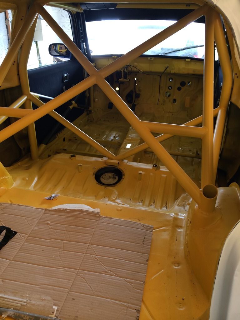

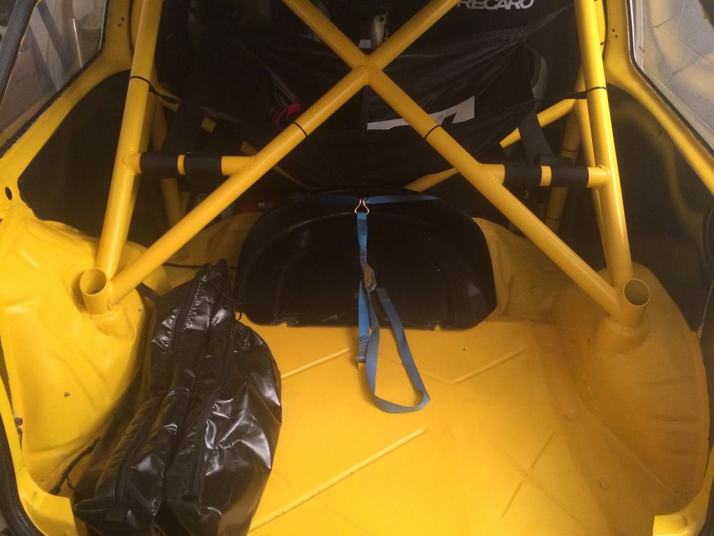

so back to the cage and weight loss

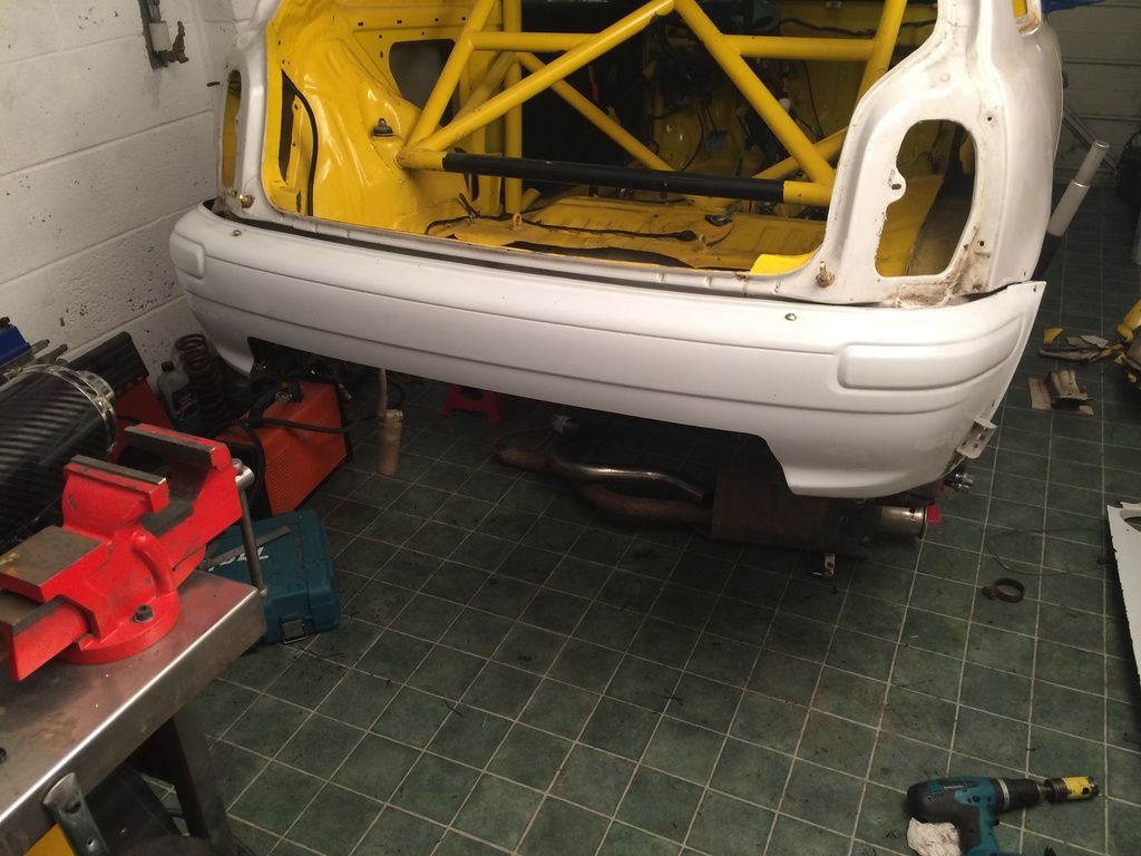

bit of a blow over with paint and ....
how it looks with the carbon rear cards , carbon spare wheel carrier and a jack bag not looking to bad
so i few other bits i did to lose some weight

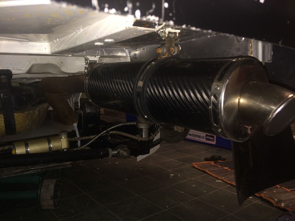

a bike carbon silencer that fits mint and was only 17 quid second hand , saved 4.5 kg !!!!!!!

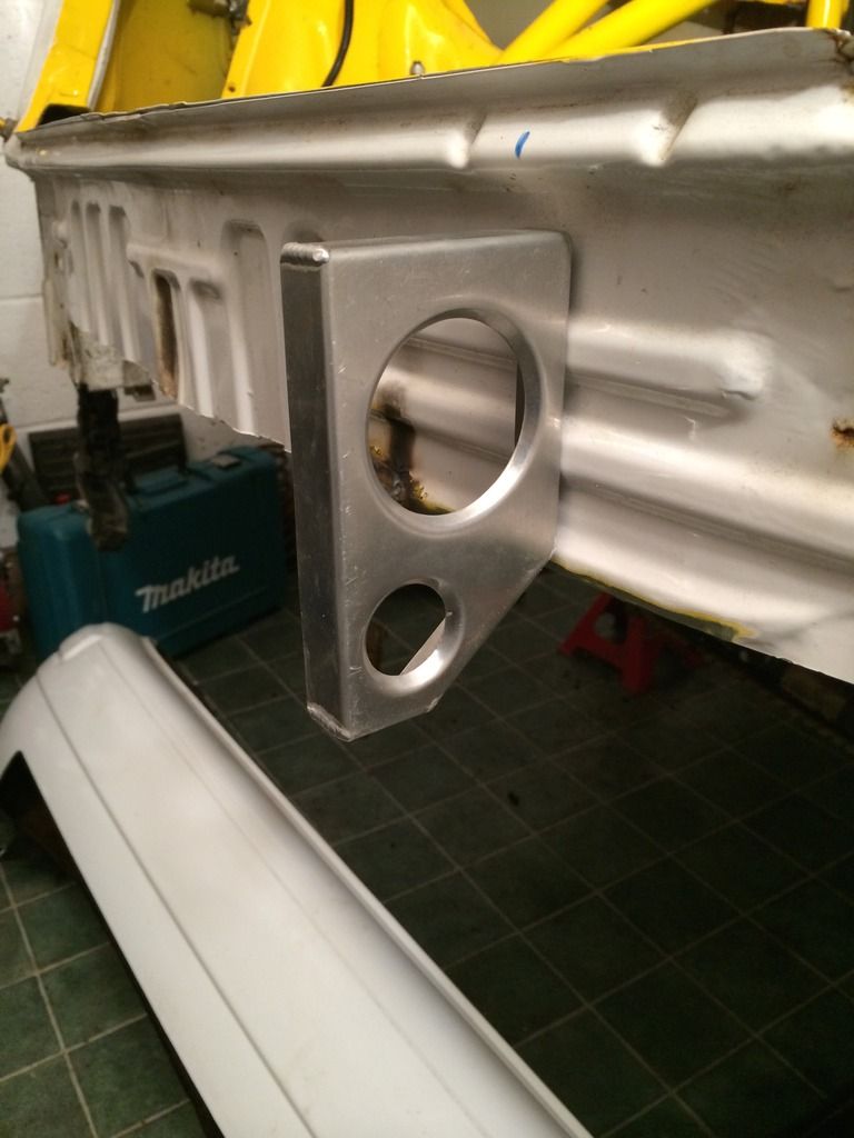

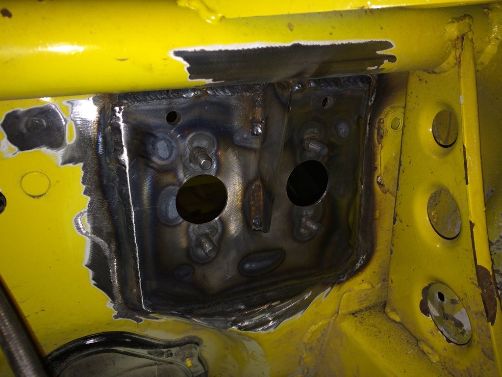

a nice way to get rid of the massive rear bumper mount
and tweek the shape of the bumper

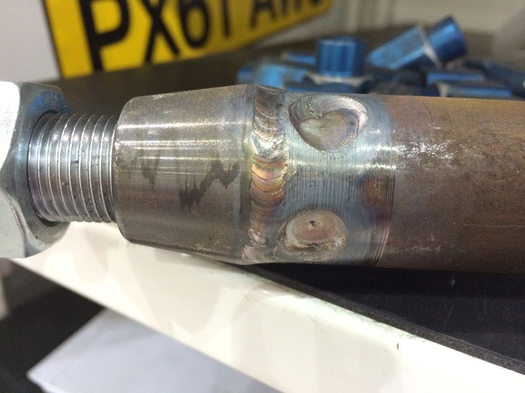

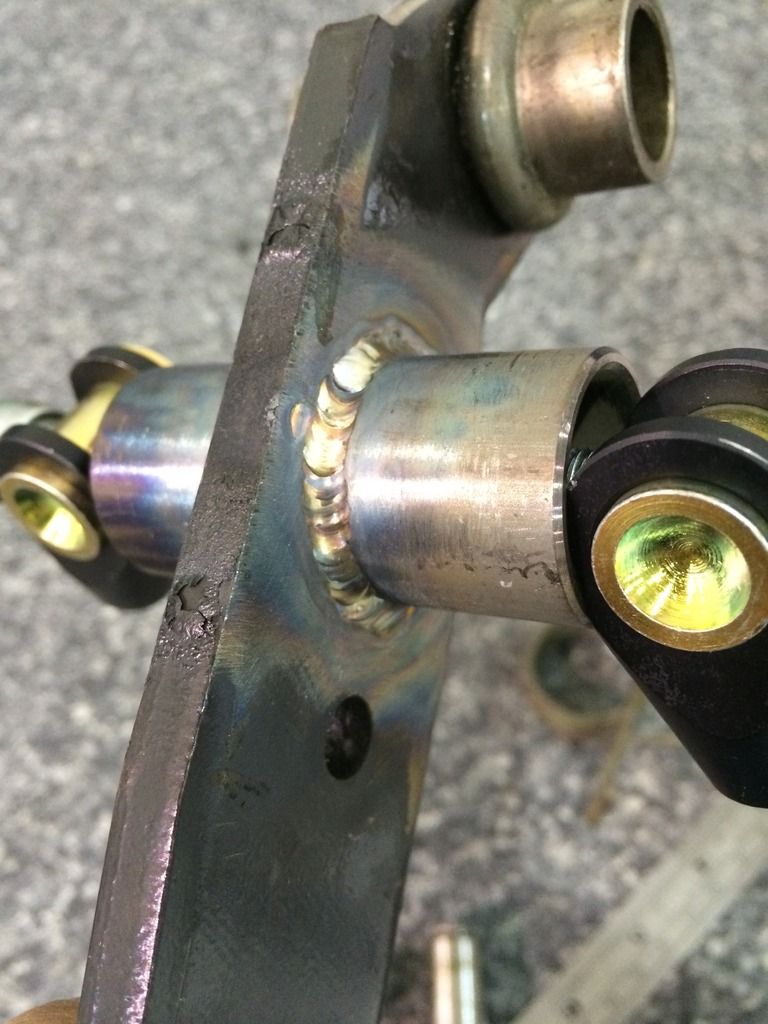

i also noticed that the rear axle was off to one side when we got the car , so i made an adjustable panard rod with rose joints
here it is fitted
