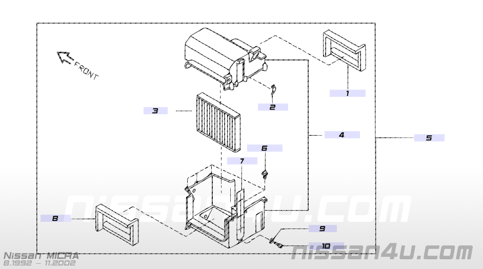

The pollent filters in behind the glovebox mate, take the glovebox off out of the way and you'll see a screw that holds a long vertical plastic clip in, take that off as well and the pollen filter will come towards you.
Had to hoover mine it was full of all sorts! Part 7 on the below

You could unscrew the bottom housing of the box the filter is housed in (2/3 extra bolts if i think on) this should left you drop half of the housing down and give you more room to play with...
This is just therory as my dash was out when i did mine
