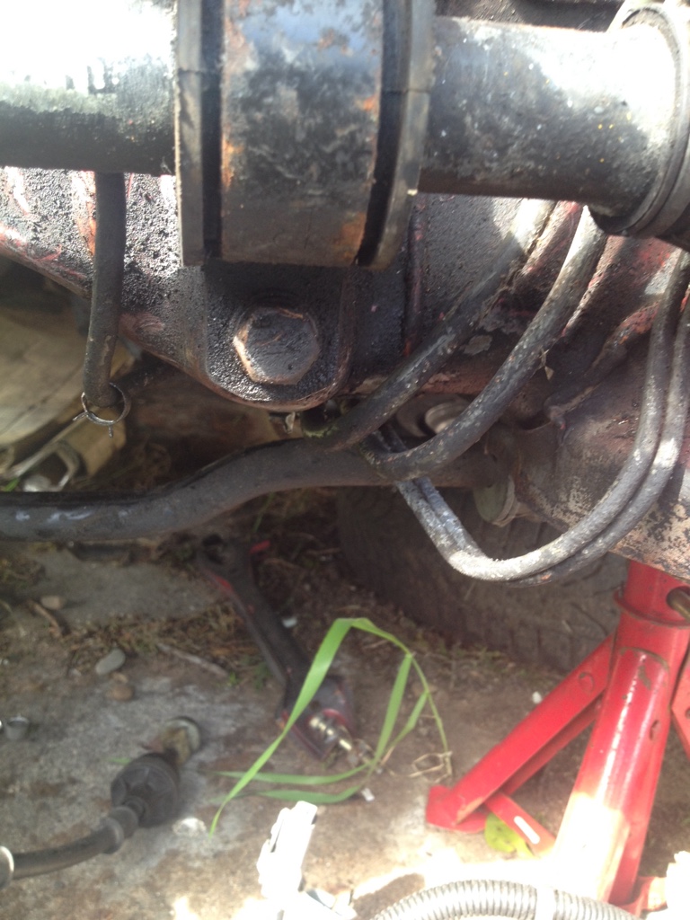

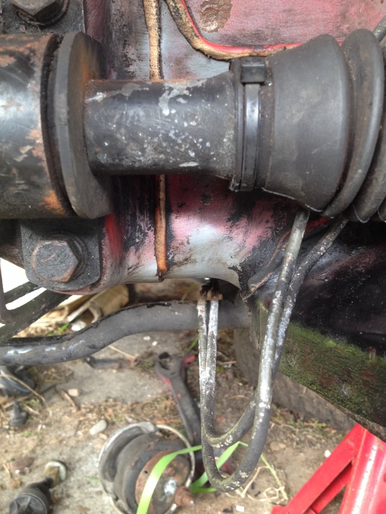

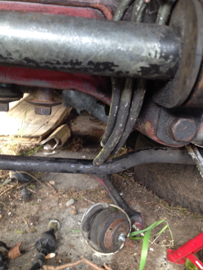

that's what I just looked at the hot temp isn't safe if I cross it over or have if close by, but rechecking it I found the leak it was near the filter neck so I cut it off and moved the pipe over like this ^
I done all 3 just waiting on pics
pictures as promised before so am happy where they are now, no leaks and brake lines are fine, need to get fuel hose to extension top of the cuts,
