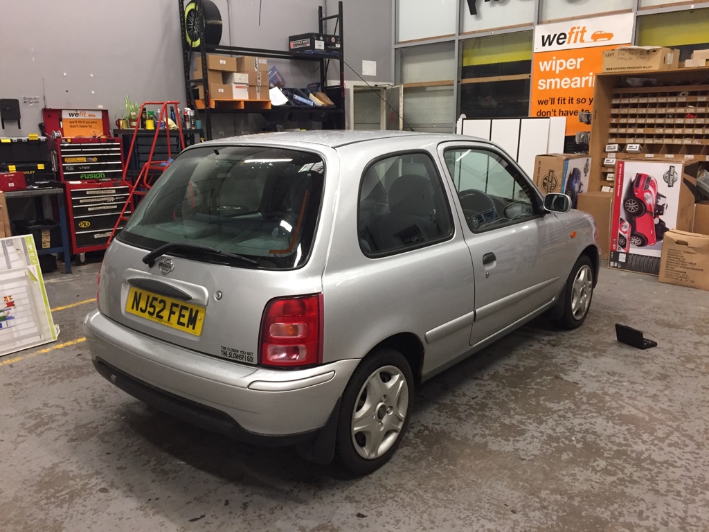

Here she is in the poor state I inherited her
The missing wheel trims are the result of mounting a traffic island at 30mph

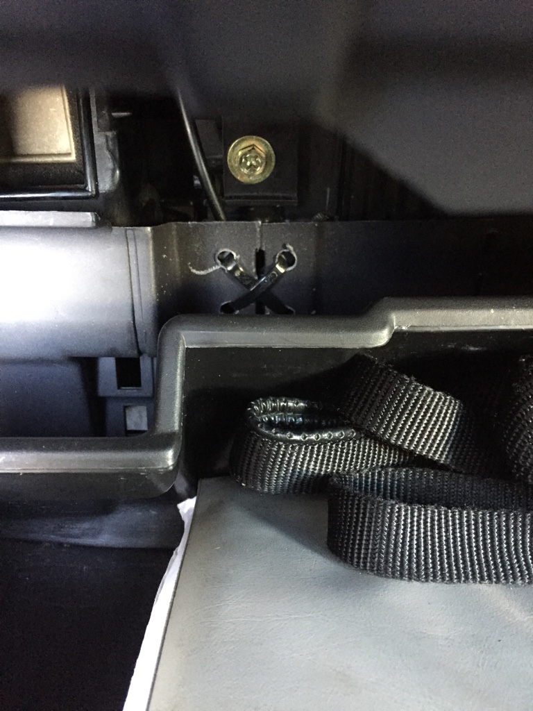

So today at work I attacked the pollen filter, chopped the dash, removed the filter. The one I got was the wrong one! New one will be in tomorrow! Decided to remove the filter box and blower motor so I could get in behind the dash to find my leak!
The motor is pretty rusty so I'm fairly confident the leak is coming from around there!
I'm pretty certain I've located it! There's an oval O ring and a green clip directly above the blower motor. Silicone sealed both of them and removed the scuttle pan to silicone them on top.
Left for a few hours to set and poured three buckets of water over the windscreen and no leak! So either it's coming from somewhere else or I've fixed it! Just hoping for some rain to make sure hahaha.
