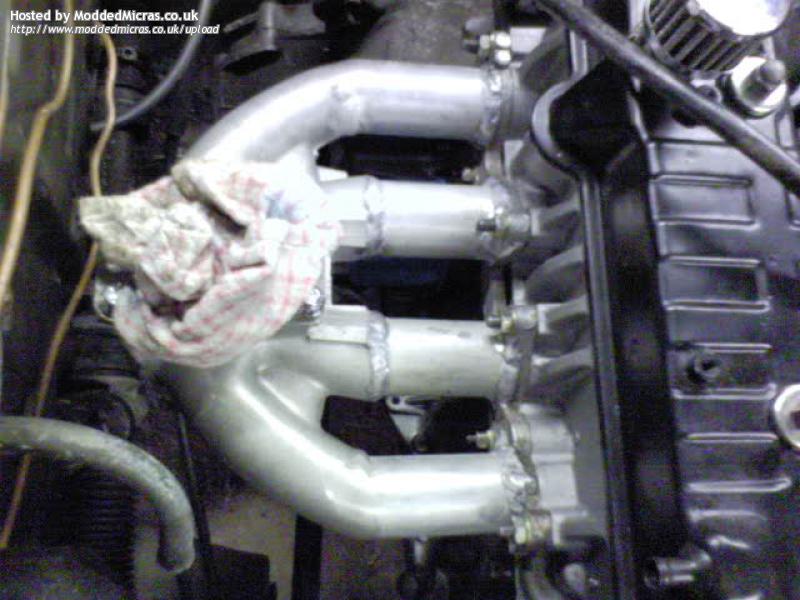

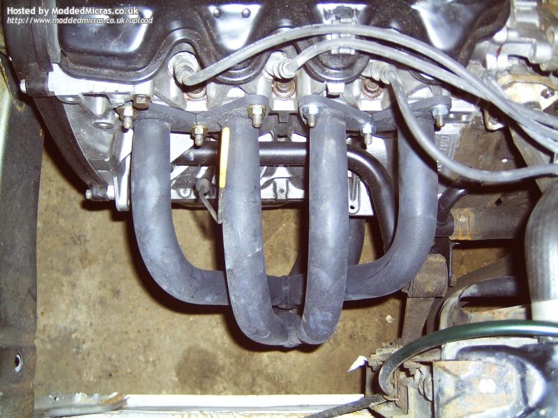

my exhaust manifold
and my inlet manifold
