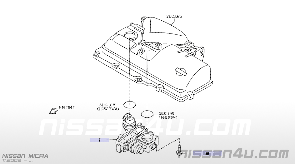

Thanks for the info appreciated. I have since realised that it is likely the MAP sensor that needs replacing (as opposed to the MAF)
MAP sensor is on top of the airbox, item 2 in the picture below...
and is secured by a single M6 bolt. It can be a little difficult to lift up after the bolt is removed as the 'O' ring around it's body tends to hang onto the hole in the airbox.
They are not cheap, I was lucky in getting a good spare when I bought a replacement airbox on eBay for £15 :cool:
