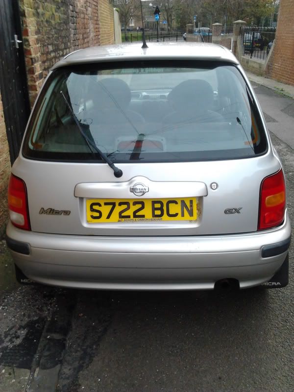

Well as some of you are now probably aware I picked up another motor to take the load while the N16 is off the road getting some bits sorted. The car was bought as an ideal little runner and a perfect motor to get the missus learning to drive. Thanks to Ed for helping me get over his way to collect it.
The price was cheap enough and it came with plenty of tax and ticket it was in urgent need of a full service and I carried this out last weekend. The oil was black and like treacle so I changed the oil & filter and plan to do so again this week now the fresh oil has had a change to flush out all the crappy old remants of the previous oil.

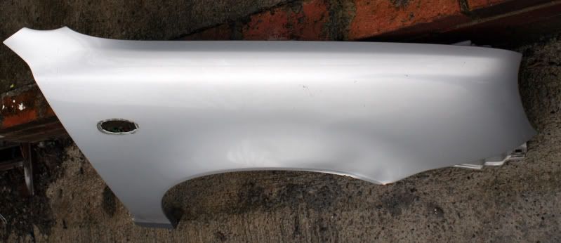

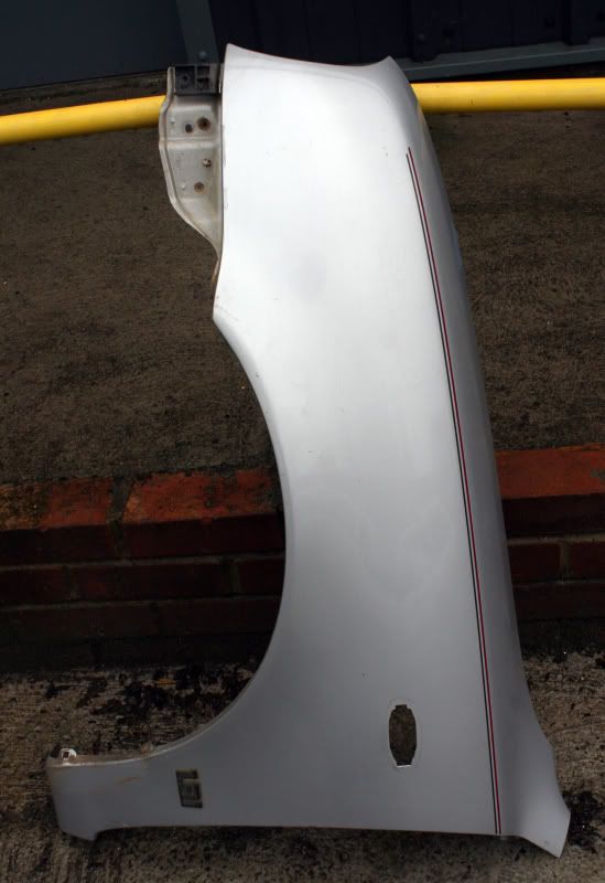

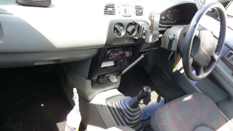

So here are a few pics from the for sale listing and a few parts I found to replace and clean up the car ready for when the missus will pass her test.

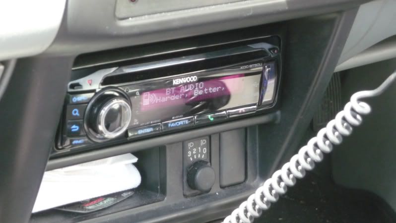

Didn't get much time to sort the wings today but my new head unit arrived today and plumbed it in and all I can say is for some reason Kenwood h/u and me just seem to fit and this one is no different. An excellent bit of kit and well worth the investment as the old Pioneer found itself a buyer.
No images as left camera at home and iPad camera has no flash so didn't bother taking any images will grab a couple tomorrow.
If anyone is after a decent h/u then take a look at the Kenwood KDC-BT50U so far I cannot fault it and I can now stream music via bluetooth also...

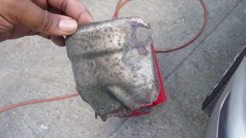

Now the car had a quite annoying rattle upon start up & during use, we narrowed it down to being caused by the heat shield on the CAT. So off it came as rust had taken its toll instant improvement & only one bolt managed to sheer upon removal.

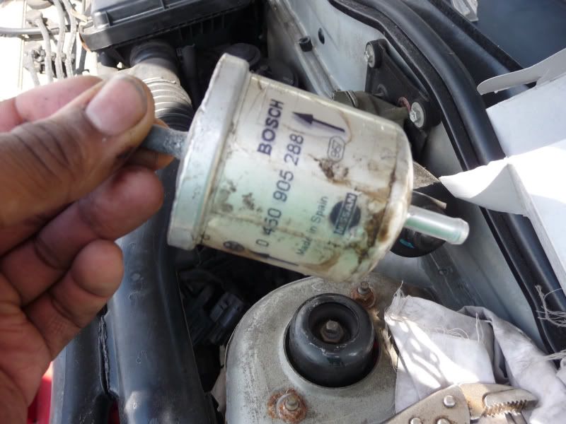

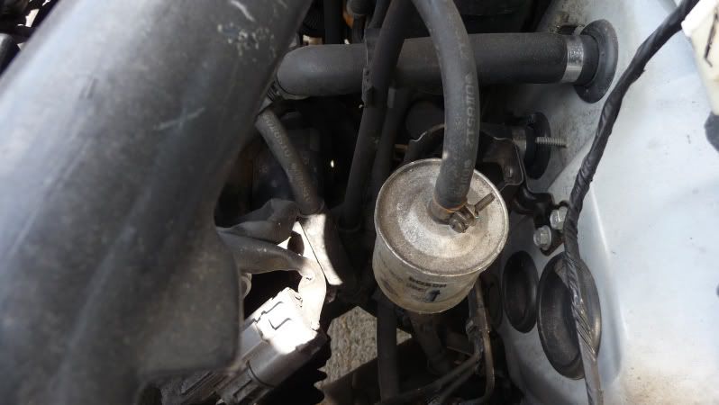

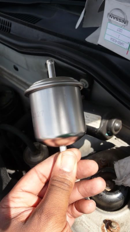

Next up was changing the fuel filter as I'd not done so when the car was serviced recently, old filter was in a grubby state & in need of changing and after a bit of persuasion the pipes came off
Before
New filter
Old filter
After

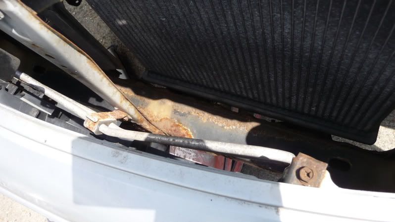

Next job on the cards is to treat the front crossmember as tin rot has been taking its toll.
Car is running so well since the filter change it's a pleasure to pootle around in.
