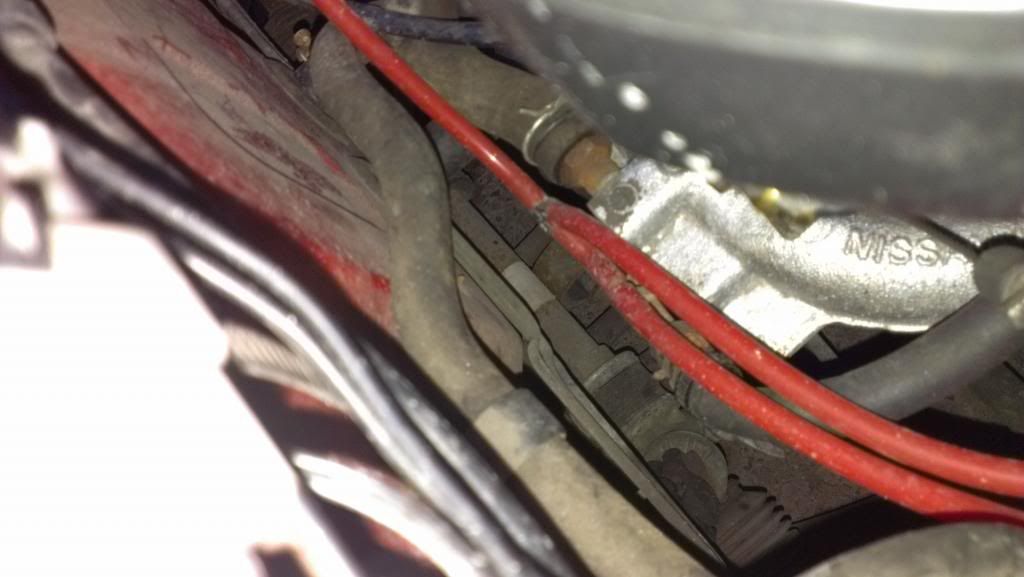

Here you can see how my vac pipes connect on inlet mani............
It defo seems I'm missing that Y bit! It must have dropped off because the pipes were so far gone when I brought the car. Thank you so much for your help.
Aah, that explains it then. What I would do is to connect the carb vac hose to the available fitting instead of the filter pan hose. The filter pan hose just goes to a bimetal bleed valve that is to bleed air into the inlet in high temperature conditions. I have disconnected mine and blanked it off with a small bolt in the end of the hose. Glad to be of help :)
