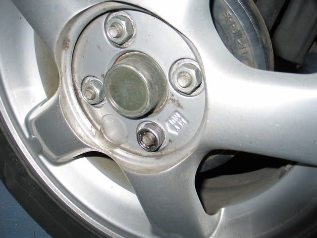

The title says it all! Does anyone know a way of getting locking nuts off without the key?! I cant find my key! :down: :down: :down: grr
Pics to follow, not with the AA etc sadly, phoned round places had some pricey labour quotes :down: . Just spent hours looking for it.
Dont suppose anyone knows any tricks like grinding the nut down to a hexagonal shape etc? Fortunately they are not receseed into the alloys so they are quite accessable.

they have an internal left hand thread, thats slightly coned, so when you force the remover onto the locking nut it bites into the nut and undoes it with the left hand thread.
if they are mcguard locking nuts, there's only about 7 keys. if you know someone with a set give their key a go. my key undoes mine, my brothers and my sister-in-laws.

Basically i have steelies on the front at the mo and they were a piece o p*ss to get off
I just ground the sides down as you can see and used a good ol spaner
Its the alloys on the back that are recessed that are the b**tards
use a chisel and hammer. hammer the chisel onto the nut on the corner, once there's something to hit into, tap the chisel into the nut and also anti-clockwise to loosen the nut. a blunt chisel works best.
