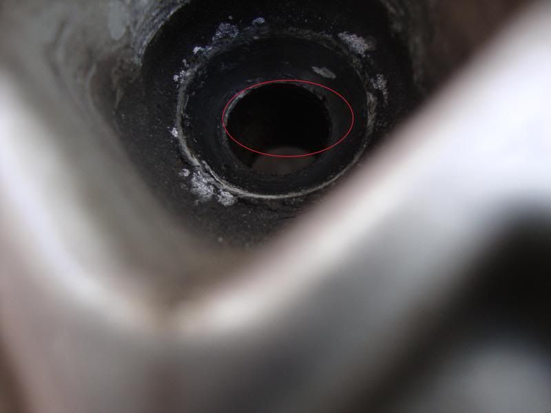

could somebody please help me here.
i have bought a set of 14" BBS's today, but the micra wheel studs are nowhere near long enough to fit thru the wheels (circled in picture)
how do you remove the studs, is there a guide on here?
and could somebody recommend what longer studs to use, i really dont want to be spending lots, but dont want to have to sell the wheels on straight away either :doh:
you smack the bolts inwards simaroon, and there was a thread a while back listing the correct spline size iirc
Ask Shaun we fitted his yesterday, as Frank says bang them back out, copper grease the new ones, washer and nut to tighten up and pull through
