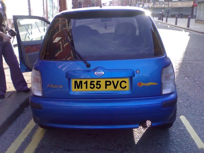

and most importantly if you can get the pre-facelift bulb holders that great as they fit in better, but ultimately the March bulb holdes fit 100%...
My lights were on a pr-facelift and i sold them to MissPVC a Facelift owner went on fine and she bought some Facelift bulbholders iirc...
