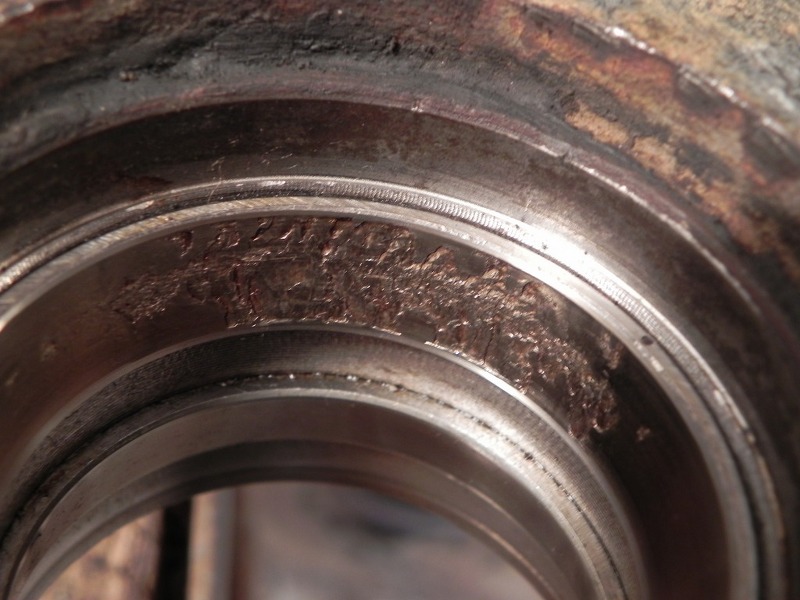

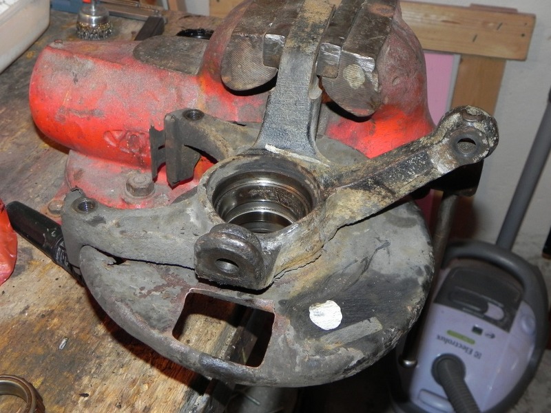

Today I removed the whole assembly, separated the wheel hub from the knuckle and looked at the bearings. The inner bearing (closer to engine) was covered with orange substance - it must have got wet somehow. Unfortunately, the knuckle is damaged too - the surface where miniature rollers on bearing touch it is quite heavily pitted on 25 percent of the total area - see the photo for better idea.

thats the bearing case thats pitted surely, you have to bladder the bearing surround out then fit a new one eh
Oh my.. I did not even think about that :D If I understand correctly, the damaged part is an outer part of the bearing (= case) and when the new bearings arrive tomorrow morning, there would be a new case? (like this? http://www.micksgarage.com/img/td/57/el/QWB355-0.jpg)
In that case, everything looks much better now :) Thanks.
One more question though - any hints for replacing the cases? I suppose that I should gently beat the cases out of the knuckle and then carefully fit new ones? Is it a job I can do myself (hammer, wooden block, vice, micrometer), or would it be better to bring the knuckle and bearings to a garage, to avoid potential misalignment? Or will the misalignment correct itself once the nut on the CV-joint is tightened and I make a few miles?

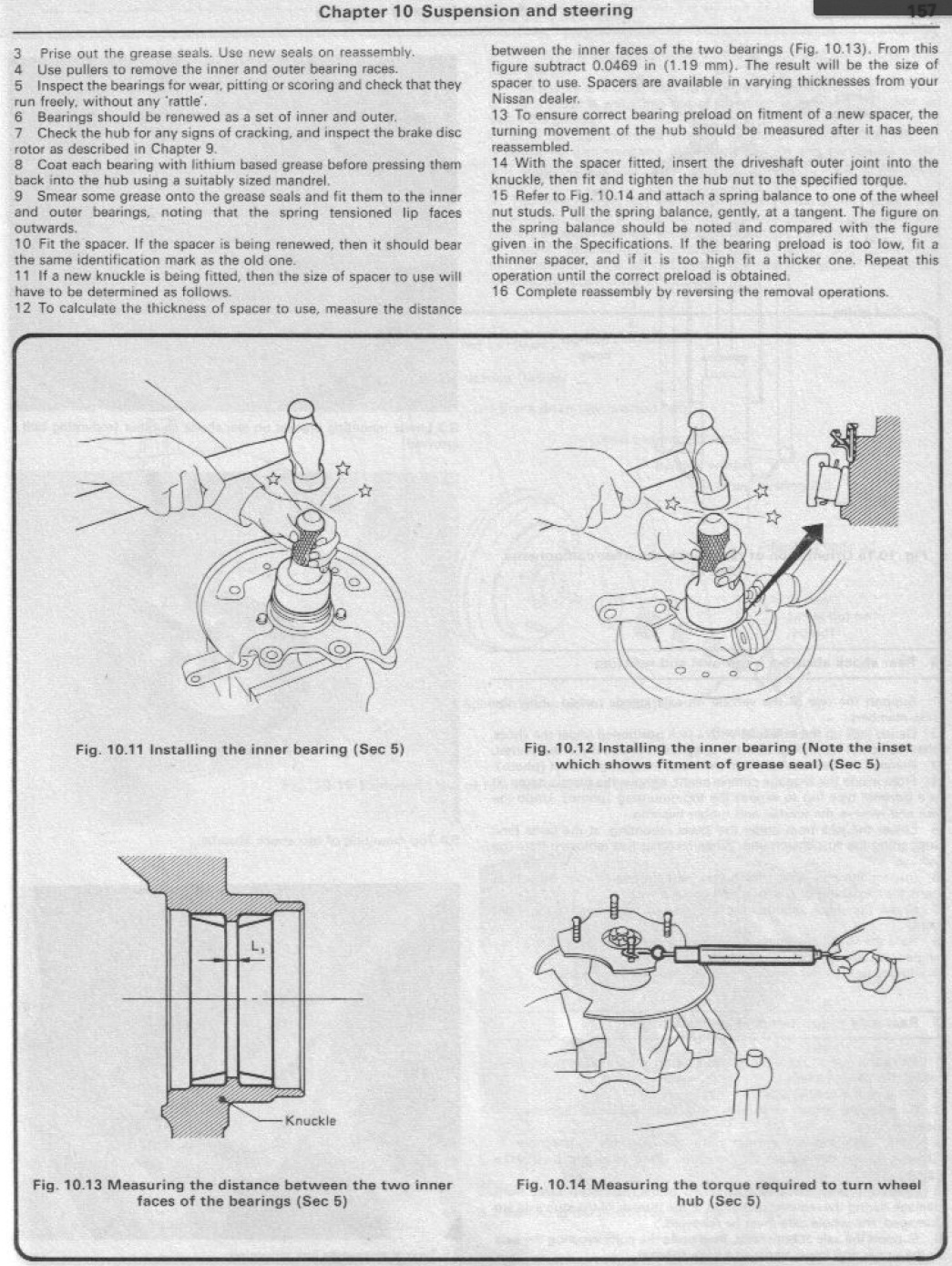

i would,nt set any preload on a wheel bearing personally, there,s no "give" in a knuckle, i think you only set preload on diff,s and gear clusters etc
Maybe it is not call preload, but you have to set it, otherwise the bearings will crap themselves :/ And that's precisely what happened to me. See attached image, mainly point 15. and figure 10.13. If you don't use a spacer, it means, that 100 lb/ft will press directly on the rollers and... you know the rest of the story. If there is a spacer with correct width, it will stop the inner bearing parts from compressing the rollers and damaging them.
I'll probably try to grind the outer casing down a bit, I have two spares to play with.. If that didn't help, friend's friend has a lathe, maybe he could make some spacers from the damaged bearings, or grind down the casing.
yes thats a preload measurement using a fishscale eh, i would still set it at zero personally tho, an alloy g/box casing only has a minimal clamping force, where-as the 100 lb/ft hubnut is capable of loading a hell of a clamping force on those little rollers
Exactly. And for that I need that damned spacer :/ The wider the spacer, the lower the preload. I will probably set it on something quite low - to make it turn easy with hand even with 100 lb/ft torque on it, as you say.

//just got to me - you were not saying, that i dont have to set anything, but that i have to set preload to zero. I did not fully grasp that and posted the Haynes picture. Sorry :)

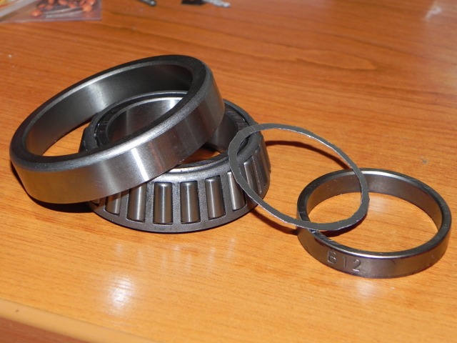

Well well well. Bought new bearings (btw, external diameter of the casing was 0.5mm larger.. no idea how the manufacturer thought I should get them in, so I used old ones.. fortunately, the inner part was exactly the same)
Then I started to look for a spacer. Surprise surprise, nowhere to be found. No problem, I like to improvise :D The razors were a bad idea, the spacer has to be made from one piece and I used three.. Which would fall into the inner part of the knuckle.
Another candidate was a metal spatula with chrome finish - 0.3mm thick. I did not use it, because I was looking for something thinner, but if anyone looked for a suitable metal donor look for a spatula :D

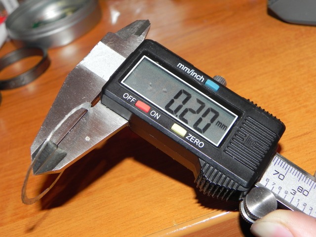

And finally - a (cheap) source of 0.2mm steel: A box of airgun pellets. I used Czech brand JSB, type Exact, but I suppose that other brands use pressed steel for boxes too. I cut it with a small PCB drill press made by Proxxon with carbide tile cutter bit. If I were a bit more careful, it could be a perfect circle, but what the hell.. it is good enough.
Long story short, after fitting it and tightening the hubnut to 100lb/ft, the whole assembly can be turned pretty easily by hand. Finally :) Thanks for help.
