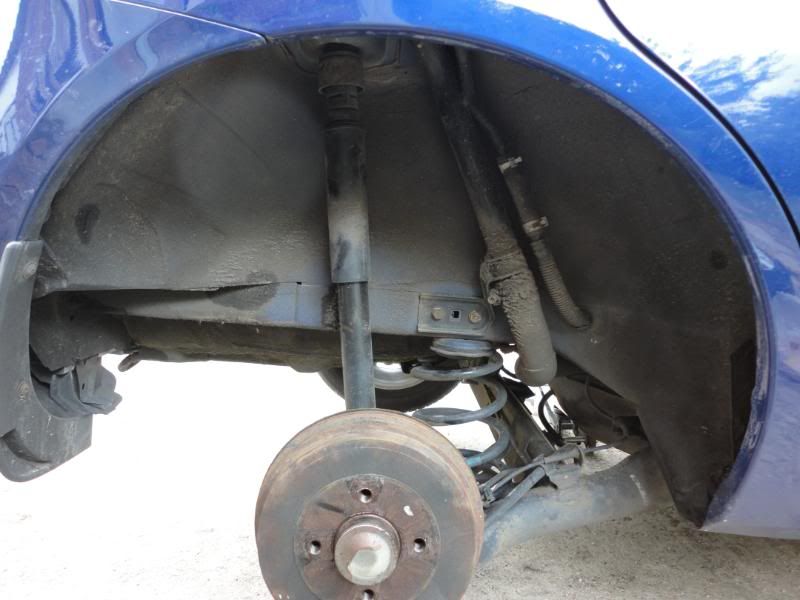

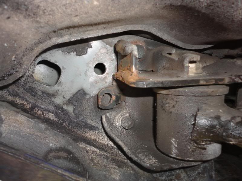

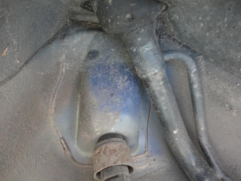

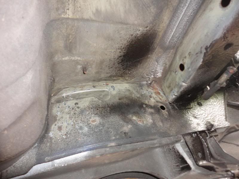

First of all I did the rear arches. This included removing the filler pipe from the drivers side arch. I then cleaned it all down and used an air die grinder with a wire wheel attachement to get rid of any rust that was starting to form.

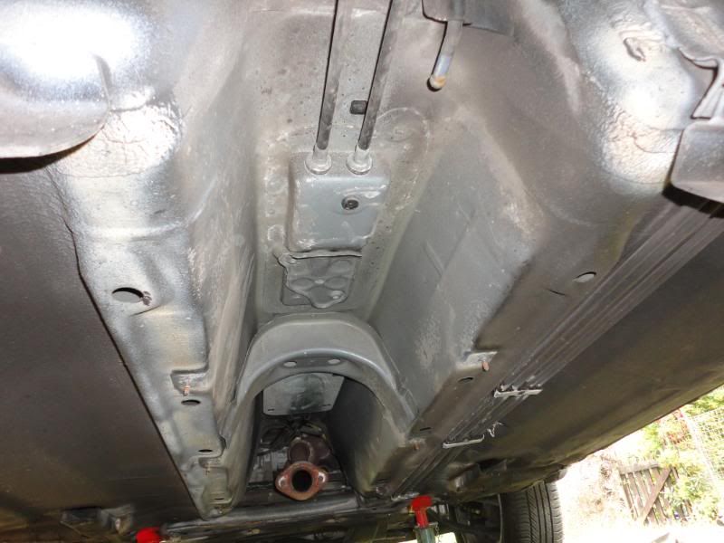

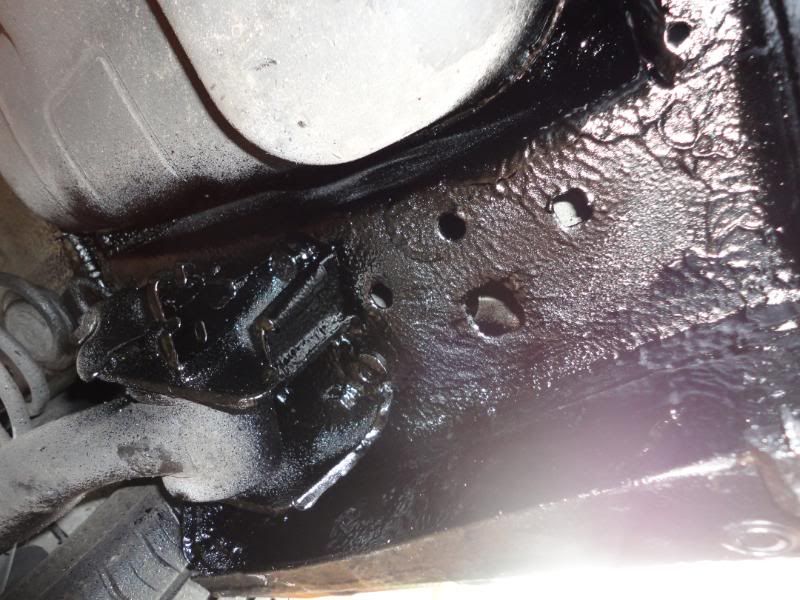

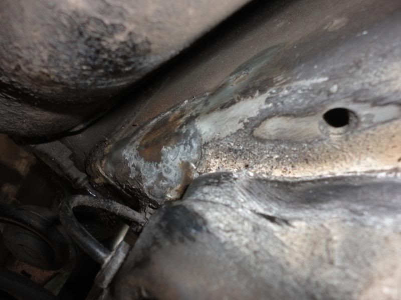

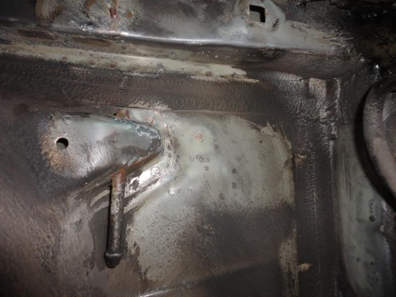

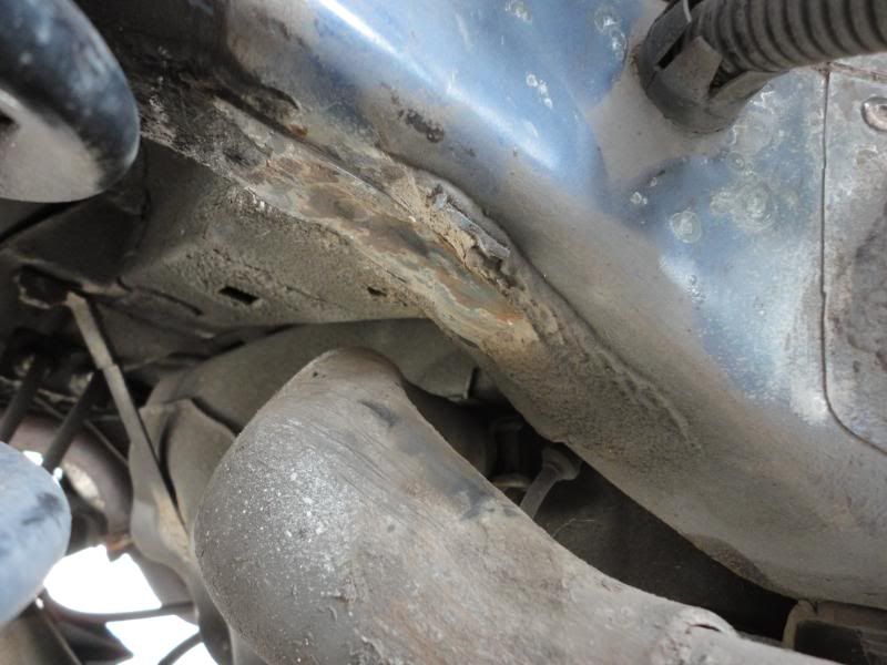

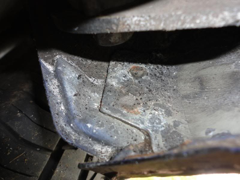

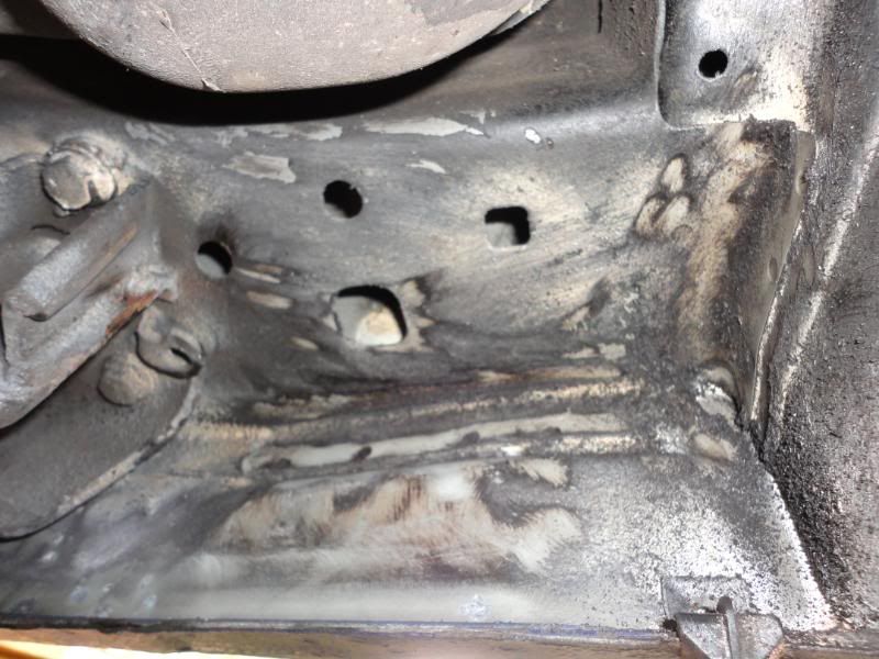

Before and During:
Notice how alot of area under the arch isnt actually sealed from factory. Also the worst part was where the fuel filler goes under the chassis leg, this along with the seam sealer trapps water and dirt.

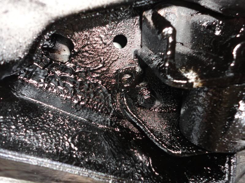

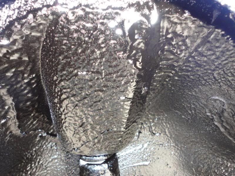

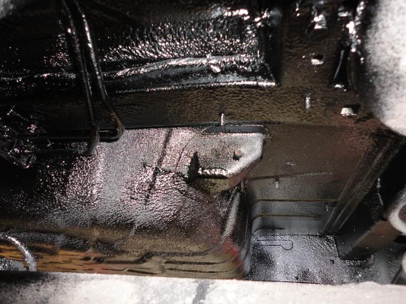

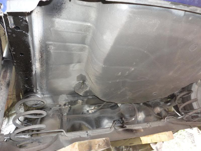

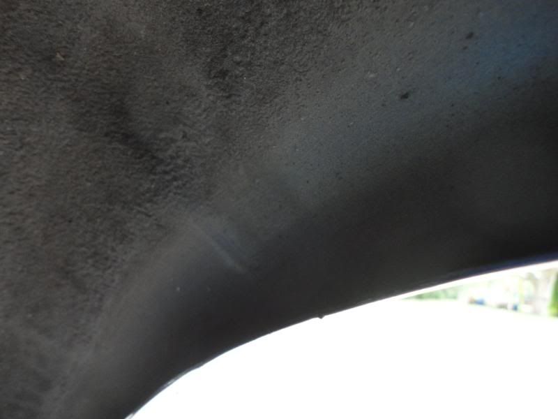

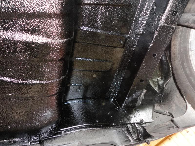

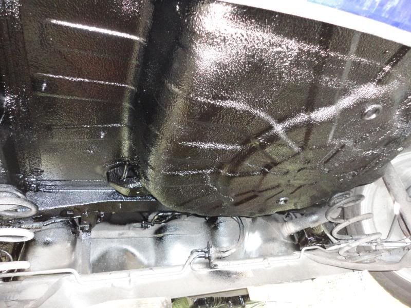

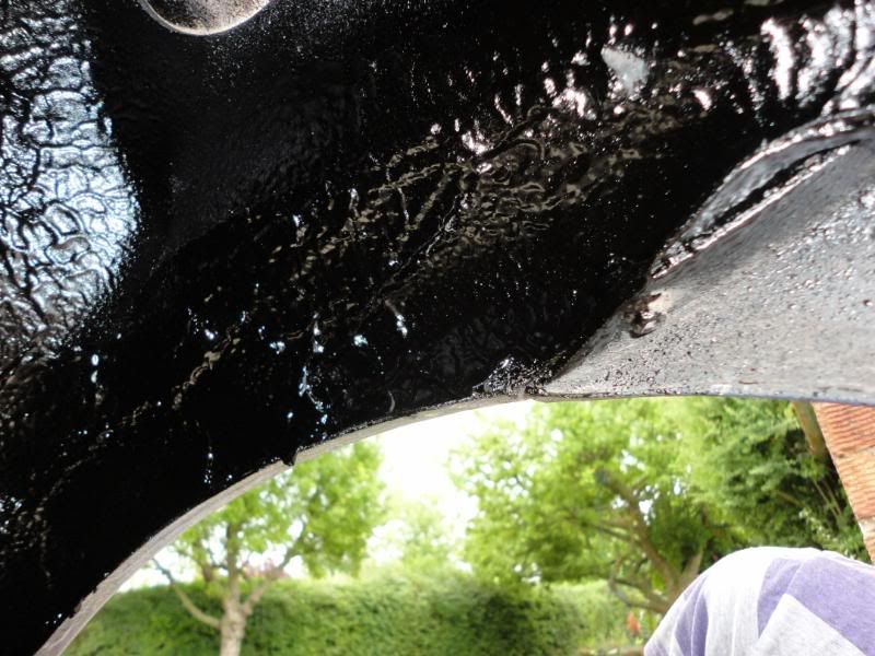

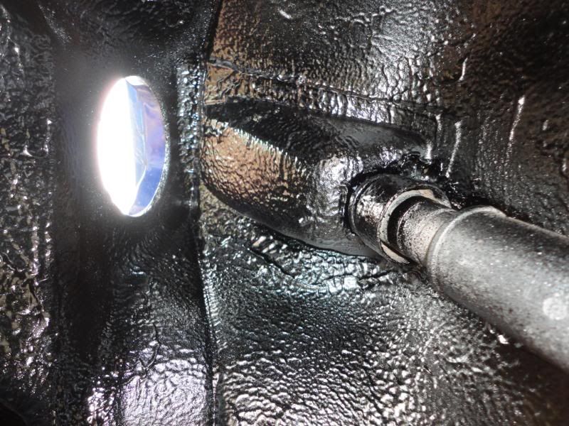

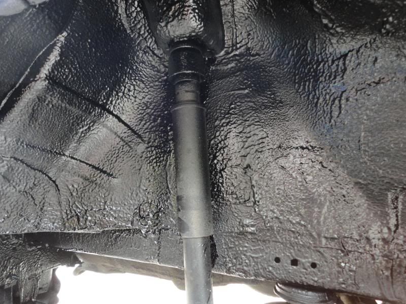

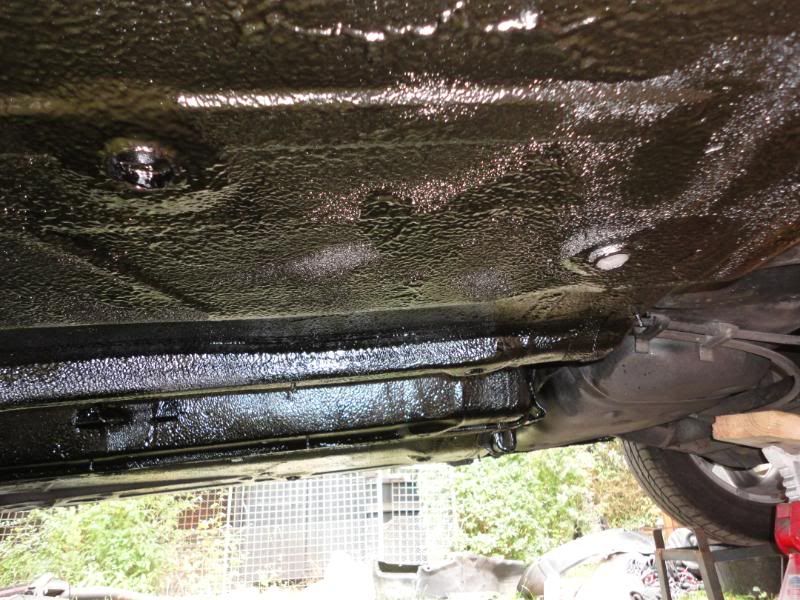

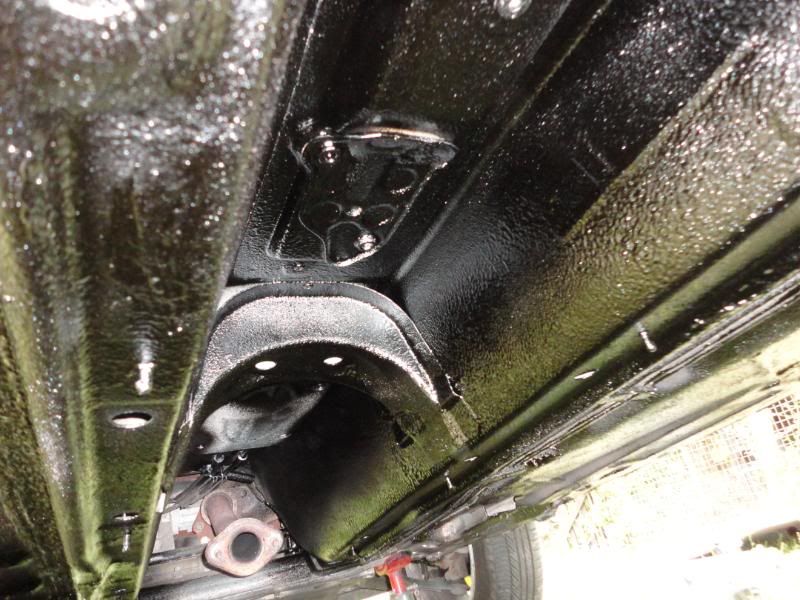

After:

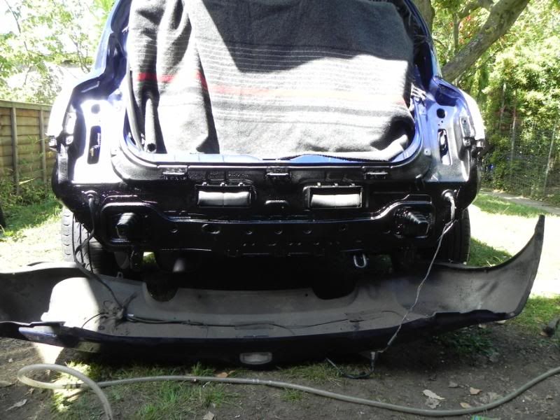

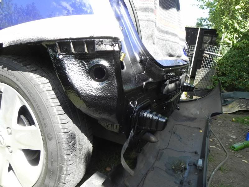

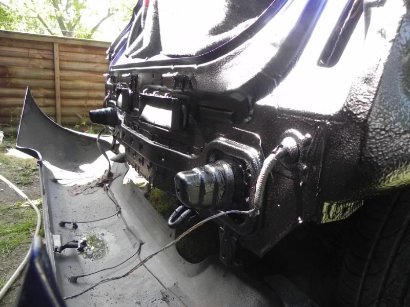

After the rear arhces, I removed the rear lights, and bumper. I was astonished at how much mud there was behind the rear bumper, and although I found no rust I thought it'd be best to do this area. Also whilst doing this, I removed the rear end caps from the chassis legs and sprayed inside the legs. I also removed the interior inside the boot and with the help of the extended 360 degree nozzle I managed to get the Dinitrol inside all of the rear 3/4/Arch area rite the way down to the sill at the front of the arch. There are plenty of seams around this area where rust can form, and the Dinitrol seaps into these seams preventing such occuring. (My camera battery went flat at this piont so couldnt get any pics of the interior cavity waxing, however it is also difficult to get pics as its all internal lol)

Before and During:
After:
