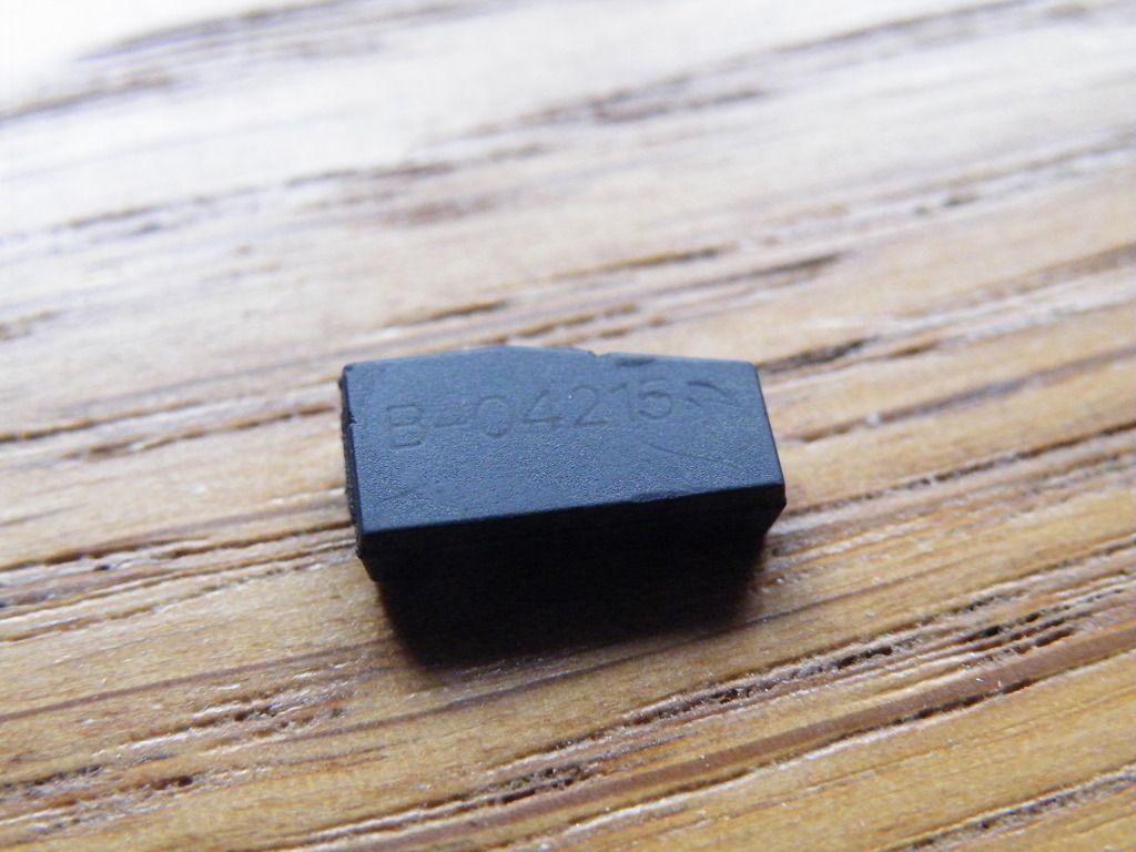

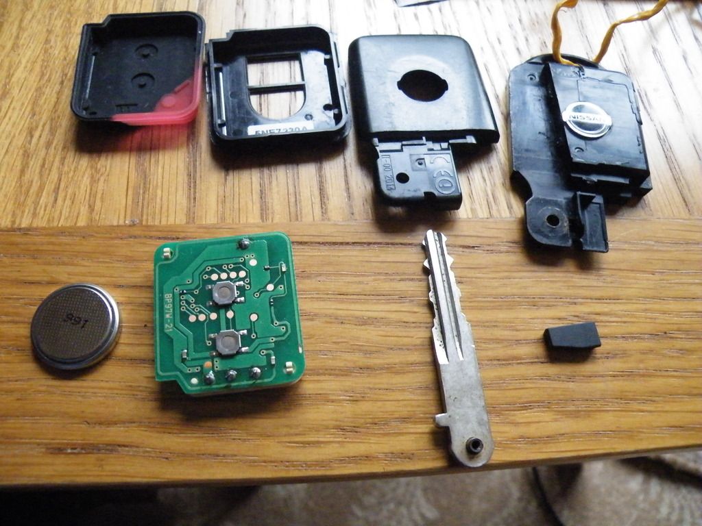

The car has had problems with the keyless entry intelligent keys (flip out). The car did not come with the non intelligent key that includes the transponder. my understanding is tha the intelligent keys are paired with the car and do not include a transponder.
I have had the car connected to CONSULT-III and it has the fault P1611 IMMU ID DISCORRD. Neither of the intelligent keys will start the engine.
I have attained a copy of CONSULT-III with NATS access, My plan is to get a mechanical key and program the transponder on the car but I need to get the correct non-intelligent key!

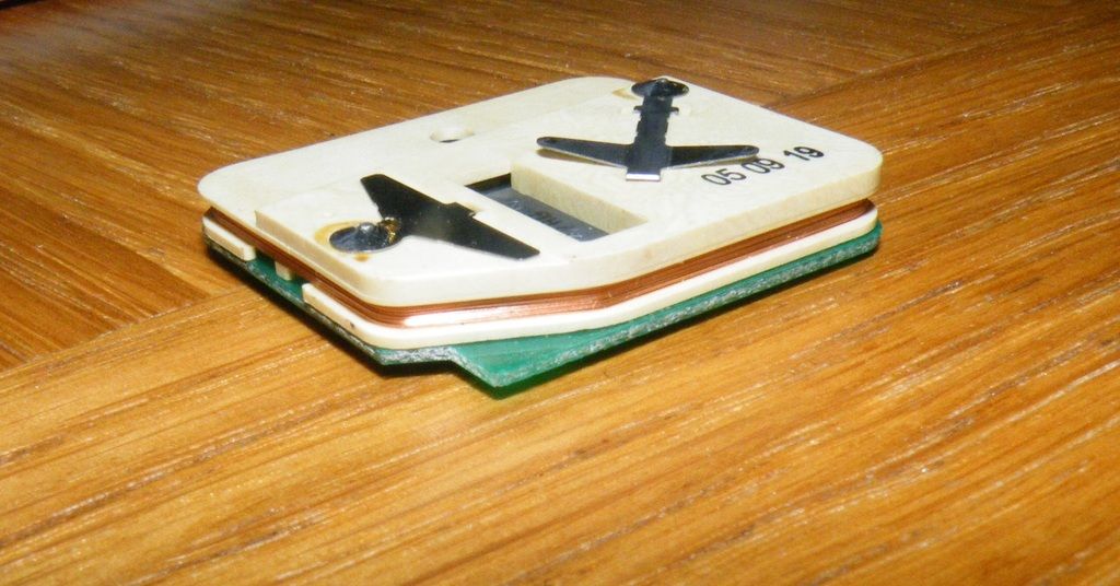

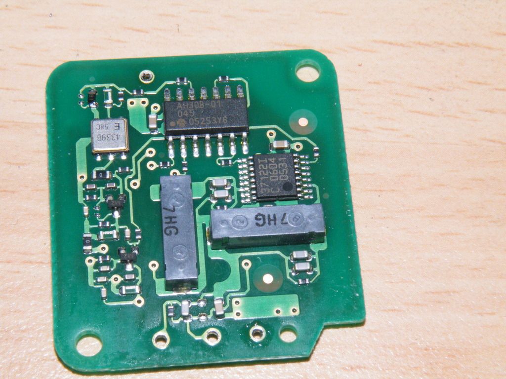

The reciever on the ignition switch does not appear to be the common siemens type, its the Calsonic Kansei Corp BSREU19. See Pic Below.
Can anybody with a K12 Micra C C Essenza that has keyless entry help me identify the Non-Intelligent key type i need?
I have the immobiliser ID, I then just need an unlock pin which can be generated from a label in the glove box which i am currently struggling with.
