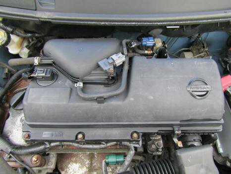

I was wandering was wandering the inlet manifold seals maybe perished,has happened with mine before. Never had a diagnostic to check what fault they triggered though. Easily checked by removing the air/fuel housing and they will either on the underside of the housing or sat in the inlet manifold. Replacement for all 4 off Nissan is only about £12
Sent from my MotoG3 using Micra Sports Club mobile app
This is the air fuel box I'm referring to
Did the broken seals cause an air leak or an oil leak? I'm going to hand the mechanic a list of things we have discussed for him to look into for me I think.

On mine it let air in at the back of the housing where the fuel and air are mixed at the throttle housing,no reason it couldn't then send oil back onto the maf as that is right next to where the inlet manifold joins the throttle housing. Really hope this is of help.
