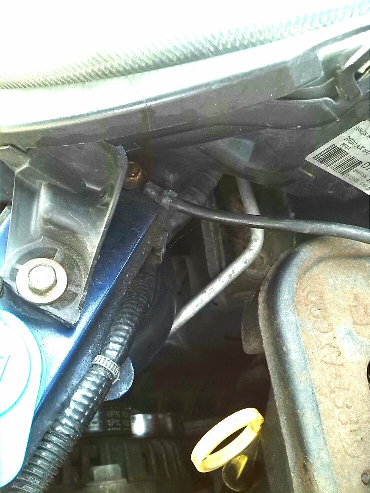

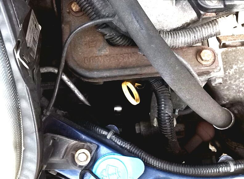

Just looked under the bonnet of my wife's Micra following an oil change and noticed this earth cable with one end connected to the alternator bracket and the other end, circled in red, just hanging in mid-air. Can someone please tell me where it should be connected? Thanks.
one end should be attached to the engine, the other to the chassis.
Alternator bracket is the engine so the end hanging about needs to go to the chassis ^_^

But my mums 1.4 sve looks the same as yours and it seems that the earth wire is supposed to connect to the front slam panel bit.
There's a bolt between the washer bottle fill capand the headlamp unit ;)
Just trying to upload photos for you ^_^
