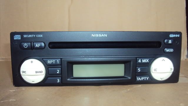

I assume this is the stereo you are talking about:
If so, then I am almost 100% sure you can fit a this stereo into a K11 using only a wiring harness adaptor.

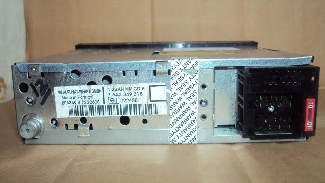

This is the back of the stereo:
The pictures are not of my stereo (sadly). Like both of yourselves I am strictly into OEM parts upgrades, not OMGz MODdiNg/StAncE/Dr0PPed 2 DA Dek motoring.

I'm pretty sure I have seen a couple of these radios installed in K11s as I have also seen Almera radios of the same era in K11s but dont know if they were working. No need for splicing wires, a universal adaptor will do, these radios already have the universal double connectors (by the red 10 amp fuse in the pic) the top connector I think is simply for the CD multi-changer. Codes often come with the stereo anyway so I cant forsee a problem, however, doesnt mean there wouldnt be one.
