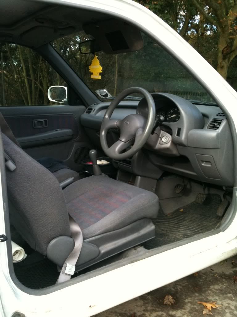

Hi,
just bought this over the weekend:
First things first I need to get the wheels changed.. the tyres are all budget and the wheels are too thin for my liking.
I'm after 13" or 14" and I will not be buying new. I need to know what wheels from other cars fit straight on ideally. Do mini wheels fit? Ideally I'm after something with a dish..
I might even look at Steelies from an Almera/primera?
Thanks
Ollie

Up date!
I've done 10,000 mile now, nearly owned her a year. She been brilliant, simply brilliant. Repairs have cost less than £150, mods less than £100 (wheels and induction kit and I chopped the springs)
Not to everyone's taste I'm sure but here you go :grinning:
Up date!
