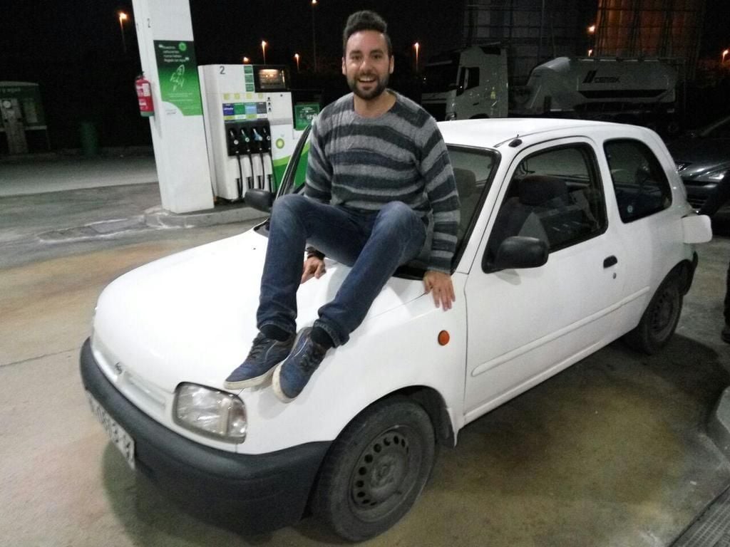

EDIT 2: Worked it out! This is the first pic we took. Here's Antonio chuffed happy with the new car.
URL]
